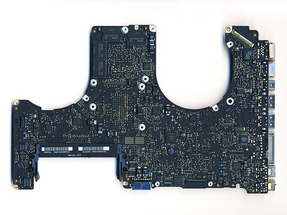

    • After removing the two cooling fans and disconnecting many connectors, the logic board and DC-In board can be removed as one piece.
  14. MacBook Pro 15" Unibody Mid 2010 Teardown: crwdns2935265:014crwdnd2935265:01crwdnd2935265:01crwdne2935265:0
    • The logic board and heat sink assembly by itself.
    • The speaker, microphone, and port layout are unchanged from previous MBP 15" Unibody machines.
  15. MacBook Pro 15" Unibody Mid 2010 Teardown: crwdns2935265:015crwdnd2935265:01crwdnd2935265:02crwdne2935265:0 MacBook Pro 15" Unibody Mid 2010 Teardown: crwdns2935265:015crwdnd2935265:02crwdnd2935265:02crwdne2935265:0
    • Intel Core i5 processor with integrated graphics.
    • NVIDIA GeForce GT 330M. The OS switches to the NVIDIA graphics for higher demand applications.
    • Intel BD82HM55 S LGZS Platform Controller Hub. Interestingly enough, the hub is not connected to the heat sink. Apparently, enough heat is convected from the surface of the silicon to remove the small amount of heat generated by the graphics switching operations.
