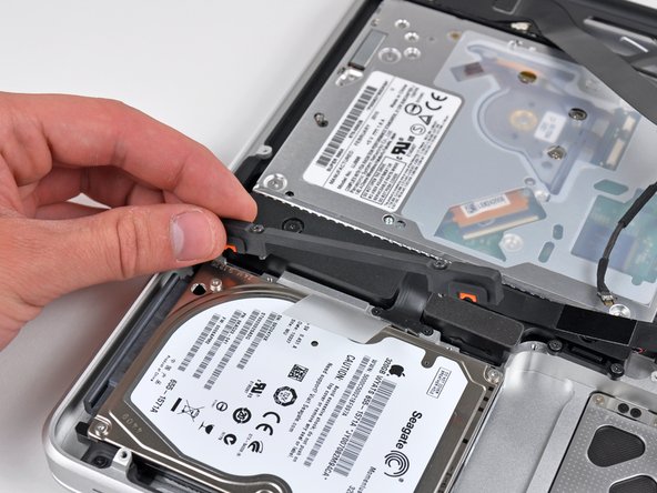

  26. MacBook Pro 15" Unibody Late 2011 Upper Case Replacement: crwdns2935265:026crwdnd2935265:01crwdnd2935265:02crwdne2935265:0 MacBook Pro 15" Unibody Late 2011 Upper Case Replacement: crwdns2935265:026crwdnd2935265:02crwdnd2935265:02crwdne2935265:0
    • Remove the two Phillips screws securing the hard drive bracket to the upper case.
    • These screws are captive in the hard drive bracket.
    • Remove the hard drive bracket from the upper case.

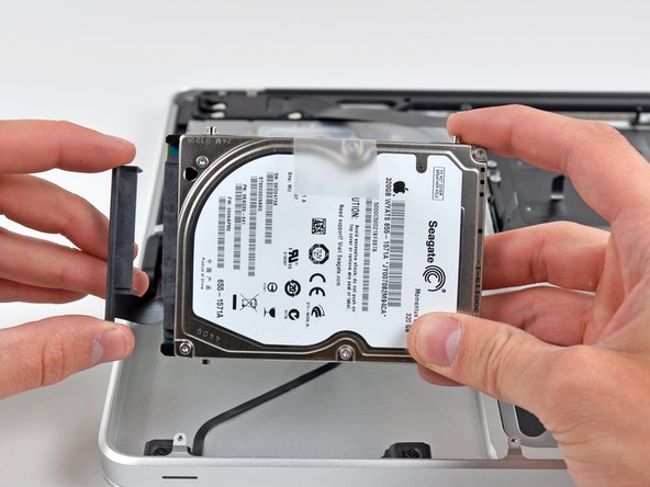

  27. MacBook Pro 15" Unibody Late 2011 Upper Case Replacement: crwdns2935265:027crwdnd2935265:01crwdnd2935265:01crwdne2935265:0
    • Using its attached pull tab, lift the hard drive out of the upper case.
    • Don't try to completely remove it yet, as it is still connected to the hard drive cable.
  28. MacBook Pro 15" Unibody Late 2011 Upper Case Replacement: crwdns2935265:028crwdnd2935265:01crwdnd2935265:02crwdne2935265:0 MacBook Pro 15" Unibody Late 2011 Upper Case Replacement: crwdns2935265:028crwdnd2935265:02crwdnd2935265:02crwdne2935265:0
    • Pull the hard drive connector out of its socket on the hard drive.
    • Pull on the connector, not the cable itself.
    • Remove the hard drive and set it aside.
