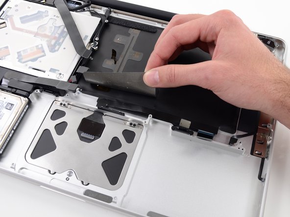

    1. MacBook Pro 15" Unibody Early 2011 Trackpad Replacement, Trackpad: crwdns2935265:026crwdnd2935265:01crwdnd2935265:02crwdne2935265:0 MacBook Pro 15" Unibody Early 2011 Trackpad Replacement, Trackpad: crwdns2935265:026crwdnd2935265:02crwdnd2935265:02crwdne2935265:0
      • Use the flat end of a spudger to peel up the edge of the large piece of black tape covering the trackpad cable.
      • Peel the tape up and fold it back out of the way of the trackpad cable. Leaving it in place on the upper case will make it easier to reapply it during reassembly.

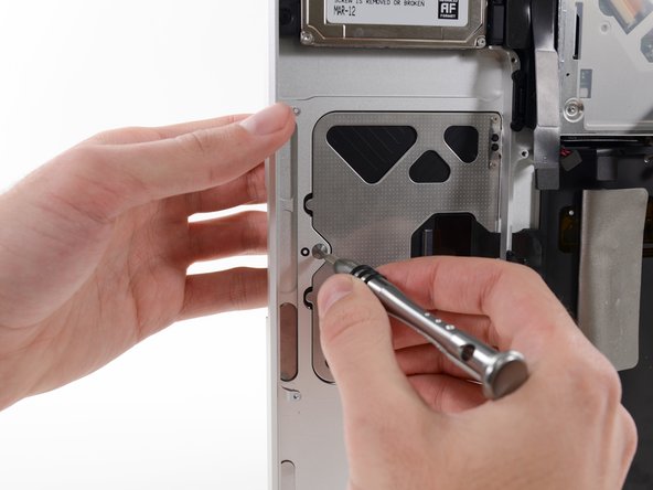

    2. MacBook Pro 15" Unibody Early 2011 Trackpad Replacement: crwdns2935265:027crwdnd2935265:01crwdnd2935265:01crwdne2935265:0
      • Open your MacBook Pro about 90 degrees and set it on its side on a table.
      • Remove the four silver 1.3 mm Phillips #00 screws from the trackpad spring brackets.

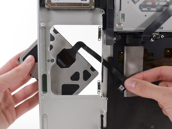

    3. MacBook Pro 15" Unibody Early 2011 Trackpad Replacement: crwdns2935265:028crwdnd2935265:01crwdnd2935265:02crwdne2935265:0 MacBook Pro 15" Unibody Early 2011 Trackpad Replacement: crwdns2935265:028crwdnd2935265:02crwdnd2935265:02crwdne2935265:0
      • While keeping a hold on the trackpad ribbon cable with one hand to keep it from tearing or creasing, ease the trackpad out of the upper case.
      • Move the trackpad back and to the right.

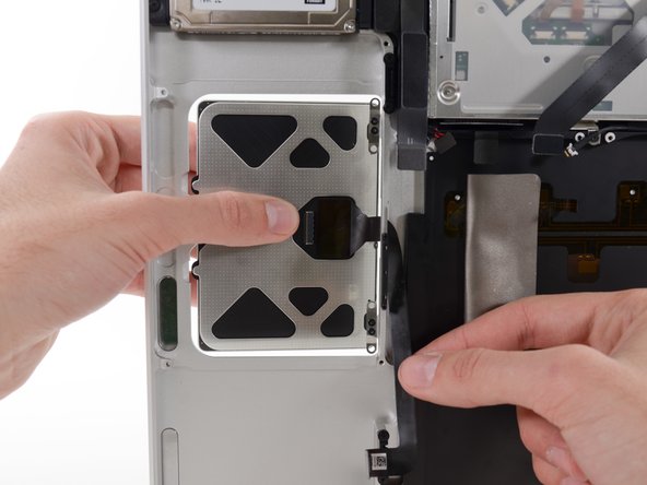

    4. MacBook Pro 15" Unibody Early 2011 Trackpad Replacement: crwdns2935265:029crwdnd2935265:01crwdnd2935265:02crwdne2935265:0 MacBook Pro 15" Unibody Early 2011 Trackpad Replacement: crwdns2935265:029crwdnd2935265:02crwdnd2935265:02crwdne2935265:0
      • Once the trackpad is free of the upper case, guide the ribbon cable through the slot cut in the upper case.
