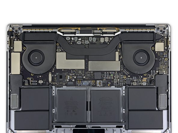

  9. MacBook Pro 15" Touch Bar Late 2016 Battery Replacement, MacBook Pro 15" Touch Bar Late 2016 Battery Disconnection: crwdns2935265:09crwdnd2935265:01crwdnd2935265:02crwdne2935265:0 MacBook Pro 15" Touch Bar Late 2016 Battery Replacement, MacBook Pro 15" Touch Bar Late 2016 Battery Disconnection: crwdns2935265:09crwdnd2935265:02crwdnd2935265:02crwdne2935265:0
    • Peel up and remove the large rectangular battery board cover, on the edge of the logic board nearest the battery.
    • If the cover doesn't peel up easily, apply mild heat with an iOpener, hair dryer, or heat gun to soften the adhesive underneath, and try again.
    • If the cover doesn't seat securely during reassembly, try rotating it 180 degrees. It must be oriented correctly in order for the adhesive pads underneath to contact the board screws.

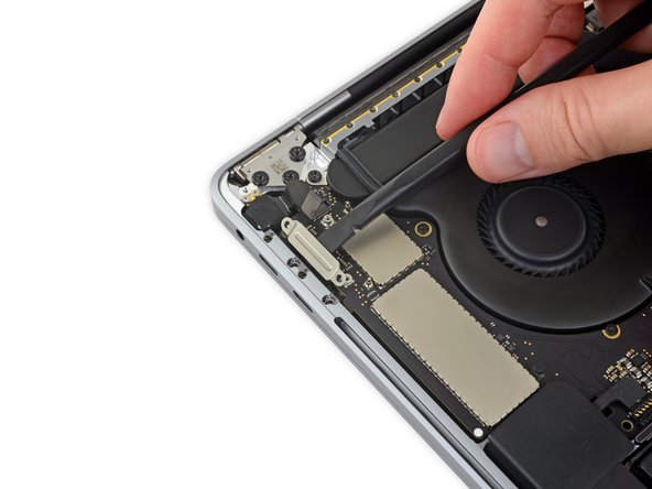

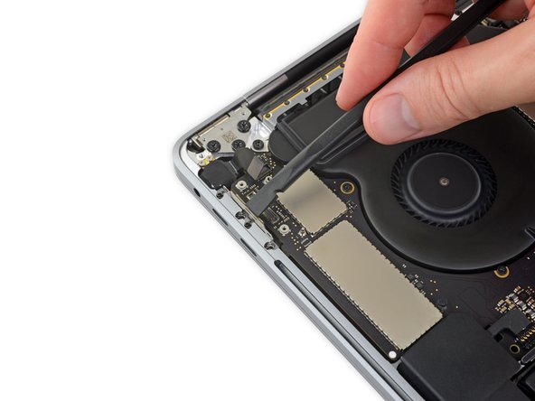

  37. MacBook Pro 15" Touch Bar Late 2016 Battery Replacement: crwdns2935265:037crwdnd2935265:01crwdnd2935265:02crwdne2935265:0 MacBook Pro 15" Touch Bar Late 2016 Battery Replacement: crwdns2935265:037crwdnd2935265:02crwdnd2935265:02crwdne2935265:0
    • Use a T3 Torx driver to remove the four 1.3 mm screws securing the Thunderbolt flex cable covers:
    • Two screws on the left
    • Two more on the right

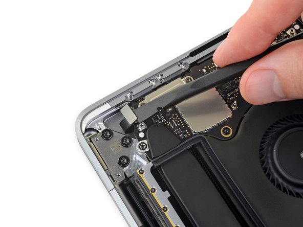

  38. MacBook Pro 15" Touch Bar Late 2016 Battery Replacement: crwdns2935265:038crwdnd2935265:01crwdnd2935265:03crwdne2935265:0 MacBook Pro 15" Touch Bar Late 2016 Battery Replacement: crwdns2935265:038crwdnd2935265:02crwdnd2935265:03crwdne2935265:0 MacBook Pro 15" Touch Bar Late 2016 Battery Replacement: crwdns2935265:038crwdnd2935265:03crwdnd2935265:03crwdne2935265:0
    • Disconnect the left-side Thunderbolt flex cable by prying it straight up from the logic board.
    • Pry from the inside edge, nearest the fan.
    • Gently push the flex cable connector off to the side so it doesn't interfere with logic board removal.

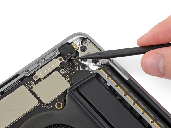

  39. MacBook Pro 15" Touch Bar Late 2016 Battery Replacement: crwdns2935265:039crwdnd2935265:01crwdnd2935265:03crwdne2935265:0 MacBook Pro 15" Touch Bar Late 2016 Battery Replacement: crwdns2935265:039crwdnd2935265:02crwdnd2935265:03crwdne2935265:0 MacBook Pro 15" Touch Bar Late 2016 Battery Replacement: crwdns2935265:039crwdnd2935265:03crwdnd2935265:03crwdne2935265:0
    • Repeat to disconnect the Thunderbolt flex cable connector on the opposite side.
    • Carefully push the flex cable connector aside so there's clearance for the logic board to come out without snagging.

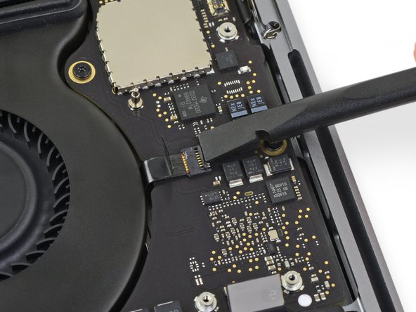

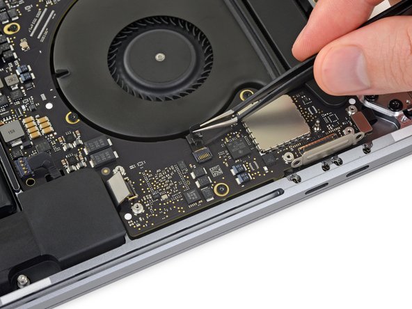

  40. MacBook Pro 15" Touch Bar Late 2016 Battery Replacement: crwdns2935265:040crwdnd2935265:01crwdnd2935265:03crwdne2935265:0 MacBook Pro 15" Touch Bar Late 2016 Battery Replacement: crwdns2935265:040crwdnd2935265:02crwdnd2935265:03crwdne2935265:0 MacBook Pro 15" Touch Bar Late 2016 Battery Replacement: crwdns2935265:040crwdnd2935265:03crwdnd2935265:03crwdne2935265:0
    • Disconnect the two speaker connectors by sliding the flat end of your spudger underneath each cable near its connector.
    • Gently twist or pry up to disconnect both speakers.

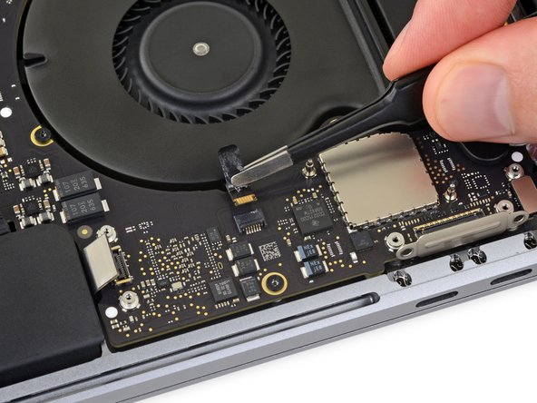

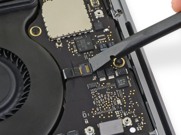

  41. MacBook Pro 15" Touch Bar Late 2016 Battery Replacement: crwdns2935265:041crwdnd2935265:01crwdnd2935265:02crwdne2935265:0 MacBook Pro 15" Touch Bar Late 2016 Battery Replacement: crwdns2935265:041crwdnd2935265:02crwdnd2935265:02crwdne2935265:0
    • Peel up any tape covering the microphone cable connector socket.
  42. MacBook Pro 15" Touch Bar Late 2016 Battery Replacement: crwdns2935265:042crwdnd2935265:01crwdnd2935265:03crwdne2935265:0 MacBook Pro 15" Touch Bar Late 2016 Battery Replacement: crwdns2935265:042crwdnd2935265:02crwdnd2935265:03crwdne2935265:0 MacBook Pro 15" Touch Bar Late 2016 Battery Replacement: crwdns2935265:042crwdnd2935265:03crwdnd2935265:03crwdne2935265:0
    • Open the locking flap on the microphone cable's ZIF connector by prying it straight up from the logic board.
  43. MacBook Pro 15" Touch Bar Late 2016 Battery Replacement: crwdns2935265:043crwdnd2935265:01crwdnd2935265:02crwdne2935265:0 MacBook Pro 15" Touch Bar Late 2016 Battery Replacement: crwdns2935265:043crwdnd2935265:02crwdnd2935265:02crwdne2935265:0
    • Disconnect the microphone by pulling its cable toward the fan until it releases from its socket.
    • If possible, pull on the tape attached to the cable, rather than the cable itself, to reduce the risk of damage.

    • Use a T5 Torx driver to remove the single 2.9 mm screw securing the antenna cable bundle.
  45. MacBook Pro 15" Touch Bar Late 2016 Battery Replacement: crwdns2935265:045crwdnd2935265:01crwdnd2935265:03crwdne2935265:0 MacBook Pro 15" Touch Bar Late 2016 Battery Replacement: crwdns2935265:045crwdnd2935265:02crwdnd2935265:03crwdne2935265:0 MacBook Pro 15" Touch Bar Late 2016 Battery Replacement: crwdns2935265:045crwdnd2935265:03crwdnd2935265:03crwdne2935265:0
    • Disconnect all three antenna cables by prying each one straight up from its socket.
    • Slide your tweezers or the flat end of your spudger underneath each cable until it's near the socket, and then gently twist or pry up to disconnect it.
    • To reconnect each cable, align the connector directly over its socket, and then press down so it snaps into place.

  48. MacBook Pro 15" Touch Bar Late 2016 Battery Replacement: crwdns2935265:048crwdnd2935265:01crwdnd2935265:02crwdne2935265:0 MacBook Pro 15" Touch Bar Late 2016 Battery Replacement: crwdns2935265:048crwdnd2935265:02crwdnd2935265:02crwdne2935265:0
    • The logic board assembly is a tight fit, but you can make it easier to remove by inserting a spudger under the left edge and levering it up slightly.
    • There should be no resistance as you remove the logic board. Check all cables carefully and hold them out of the way if needed so they don't snag on the board.
    • Lifting from the left side, remove the logic board.
