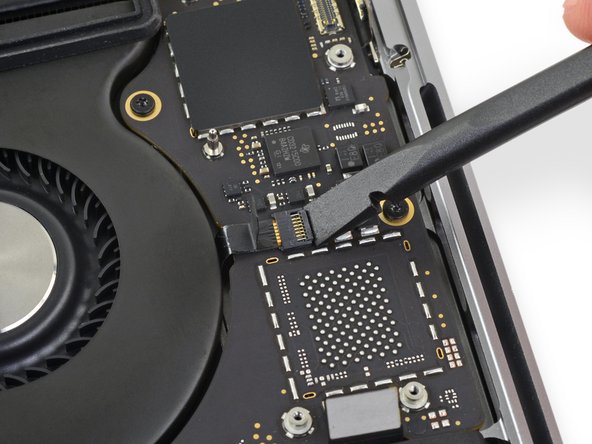

    This step is completely unnecessary if you follow the guide to disconnect the battery properly. Just put some tape between the battery and logic board connection to prevent it from accidentally touching and therefore powering on the laptop.

    I didn’t do this. Mine never auto-booted before I replaced the battery. Now it does.

    Just replaced my 2018 15" MBP battery. Running Sonoma.
    I found no way to disable AutoBoot (The status can be checked in the Power section of system report).
    Anyway, i left my battery completely drain before opening the MBP, and had no issues during the process.

    • Press a suction handle into place near the front edge of the lower case, between the screw holes.
    • Pull up on the suction handle just enough to open a small gap under the lower case.
    Throw away this suction cup and get another. It just doesn't work! Luckily I had one that does work in my tool kit.
    Greek Taylor - crwdns2934203:0crwdne2934203:0
  4. MacBook Pro 15" Touch Bar 2019 Battery Replacement: crwdns2935265:04crwdnd2935265:01crwdnd2935265:03crwdne2935265:0 MacBook Pro 15" Touch Bar 2019 Battery Replacement: crwdns2935265:04crwdnd2935265:02crwdnd2935265:03crwdne2935265:0 MacBook Pro 15" Touch Bar 2019 Battery Replacement: crwdns2935265:04crwdnd2935265:03crwdnd2935265:03crwdne2935265:0
    • Slide the corner of an opening pick into the gap you just created underneath the lower case.
    • Slide the opening pick around the nearest corner and then halfway up the side of the MacBook Pro.
    • This releases the first of the hidden clips securing the lower case. You should feel and hear the clip pop free.

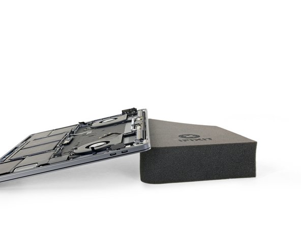

    • Pull firmly to slide the lower case towards the front edge of the MacBook (away from the hinge area) to separate the last of the clips securing the lower case.
    • Pull first at one corner, then the other.
    • Pull to the side—not up.
    • This may require a lot of force.
    With the amount of force needed to carefully pull the back panel out, this caused the back panel to scratch the battery. I don't see or hear any expansion, but this still has me concerned.
    gladgura - crwdns2934203:0crwdne2934203:0
    this step must require a lot of force. I tried to pull it with the plastic hookie thing from the ifixit set by hooking it in one of the screw holes — the tip of the hookie thing broke.
    Oleksii Toldaiev - crwdns2934203:0crwdne2934203:0
    The amount of force required for removing the bottom cover is absolutely ridiculous. Almost feels like i'm about to push my MacBook towards the wall the second it comes off.
    Be careful, I ended up breaking 2 grounding pins on the motherboard last time I tried opening my computer up.
    techtalkf - crwdns2934203:0crwdne2934203:0
    PLEASE DON'T PULL!!!
    Instead just gently push with plastic pick from the other side (where vents outputs are) towards the center... Cover will very easily open that way.
    I hope iFixit will correct this step.

  10. MacBook Pro 15" Touch Bar 2019 Battery Replacement: crwdns2935265:010crwdnd2935265:01crwdnd2935265:03crwdne2935265:0 MacBook Pro 15" Touch Bar 2019 Battery Replacement: crwdns2935265:010crwdnd2935265:02crwdnd2935265:03crwdne2935265:0 MacBook Pro 15" Touch Bar 2019 Battery Replacement: crwdns2935265:010crwdnd2935265:03crwdnd2935265:03crwdne2935265:0
    • Peel back any tape covering the battery board data cable connector.
    • Use a spudger to gently pry up the locking flap on the ZIF connector for the battery board data cable.
  11. MacBook Pro 15" Touch Bar 2019 Battery Replacement: crwdns2935265:011crwdnd2935265:01crwdnd2935265:02crwdne2935265:0 MacBook Pro 15" Touch Bar 2019 Battery Replacement: crwdns2935265:011crwdnd2935265:02crwdnd2935265:02crwdne2935265:0
    • Disconnect the battery board data cable by sliding it out from its socket on the logic board.
    • Slide parallel to the logic board, in the direction of the cable.

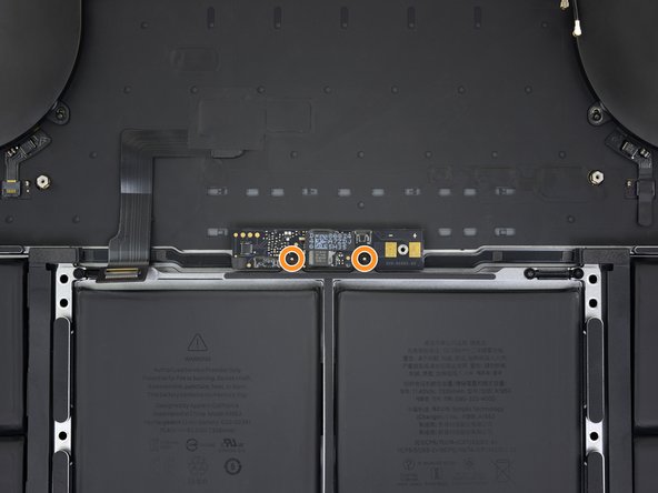

  13. MacBook Pro 15" Touch Bar 2019 Battery Replacement: crwdns2935265:013crwdnd2935265:01crwdnd2935265:02crwdne2935265:0 MacBook Pro 15" Touch Bar 2019 Battery Replacement: crwdns2935265:013crwdnd2935265:02crwdnd2935265:02crwdne2935265:0
    • Slide the battery board data cable out of its socket on the battery board, and remove it completely.
    • Take care not to install this cable backwards or upside-down. When installed correctly, the white liquid indicator sticker should face up, positioned directly over the battery power connector screw.

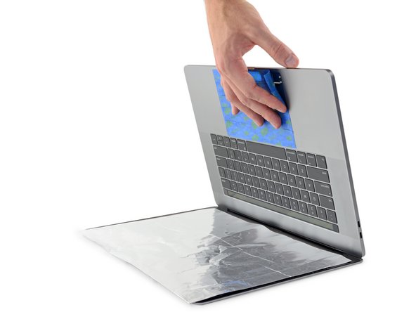

  21. MacBook Pro 15" Touch Bar 2019 Battery Replacement: crwdns2935265:021crwdnd2935265:01crwdnd2935265:03crwdne2935265:0 MacBook Pro 15" Touch Bar 2019 Battery Replacement: crwdns2935265:021crwdnd2935265:02crwdnd2935265:03crwdne2935265:0 MacBook Pro 15" Touch Bar 2019 Battery Replacement: crwdns2935265:021crwdnd2935265:03crwdnd2935265:03crwdne2935265:0
    • Swing the display open slightly, but keep the MacBook upside-down. The trackpad assembly should separate and lay flat on the display.
    • Carefully feed the trackpad's ribbon cable through its slot in the chassis.
    do not turn the touchpad over, as there are 4+5 very thin spacers/washers, and you might lose them. only the next step warns you about this. dont be me!
    George Kiss - crwdns2934203:0crwdne2934203:0
    That will teach me not to read ahead!!
    Richard Holmes -
    I did that too… I think they should put the warning in this step! Not the next one
    Joy -
    This was my first mistake, i opened the display far too wide! Open it 1-2cms max to let the trackpad simply and carefully drop to the display so you don't loose the tiny washers.
    James Scanlon - crwdns2934203:0crwdne2934203:0
    absolutley infuriating. how about put the warning on this step??? ifixit team.. smh..
    raigovind93 - crwdns2934203:0crwdne2934203:0

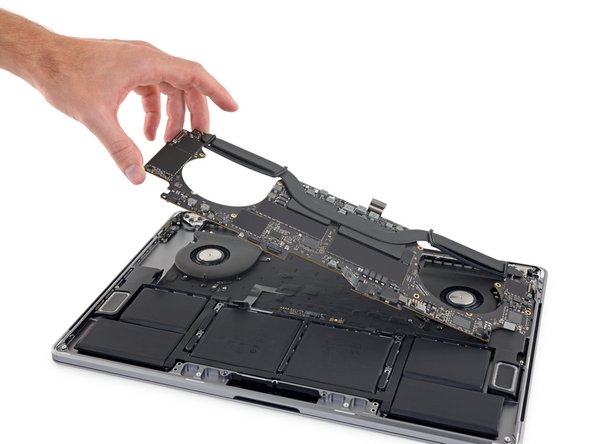

  22. MacBook Pro 15" Touch Bar 2019 Battery Replacement: crwdns2935265:022crwdnd2935265:01crwdnd2935265:03crwdne2935265:0 MacBook Pro 15" Touch Bar 2019 Battery Replacement: crwdns2935265:022crwdnd2935265:02crwdnd2935265:03crwdne2935265:0 MacBook Pro 15" Touch Bar 2019 Battery Replacement: crwdns2935265:022crwdnd2935265:03crwdnd2935265:03crwdne2935265:0
    • As you remove the trackpad assembly, be very careful not to lose the nine small metal washers resting on the screw posts. (They will fly off and get lost with very little provocation.)
    • Remove the trackpad assembly.
    Und was wenn eine Trackpad Metallscheibe verloren geht?????Genau das ist mir gerade passiert. Muss ich mein Macbook jetzt wegschmeißen? HELP!
    Frank - crwdns2934203:0crwdne2934203:0
    If you have the track pad facing you just slightly lift the upper half of the MacBook and it should easily slide out. No force. Just be careful with the ribbon tape. Slow, steady and careful.
    VicRod74 - crwdns2934203:0crwdne2934203:0

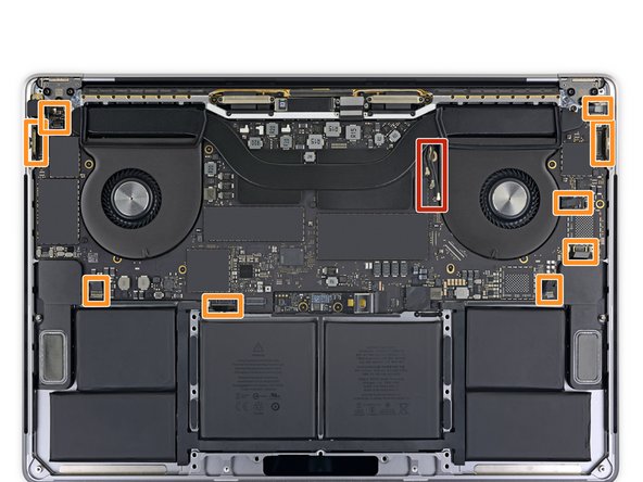

  23. MacBook Pro 15" Touch Bar 2019 Battery Replacement, Logic Board Assembly: crwdns2935265:023crwdnd2935265:01crwdnd2935265:02crwdne2935265:0 MacBook Pro 15" Touch Bar 2019 Battery Replacement, Logic Board Assembly: crwdns2935265:023crwdnd2935265:02crwdnd2935265:02crwdne2935265:0
    • Use your spudger to disconnect the keyboard by prying its connector straight up from the logic board.
    Yeah, nah. I'm going to be using Steve's method from Tronics fix to replace the battery in mine.
    I'm not messing around pulling the entire logic board out. 😁
    Cary B - crwdns2934203:0crwdne2934203:0
    You can skip to step 47 and just remove the bottom four screws on the logic board (red and orange T3 and T5) and gently lift the logic board with two spudgers as spacers and then you can remove the battery control board from under the logic board.
    Gregg Stanley - crwdns2934203:0crwdne2934203:0
    I skipped to step 47 and it worked fine. I did loosen all the screws holding the logic board in place because it felt like I was applying more force than was good for it in order to raise the board up. Whoever thought that was the best way to route the battery connections should be taken out and flogged!
    John McKee - crwdns2934203:0crwdne2934203:0

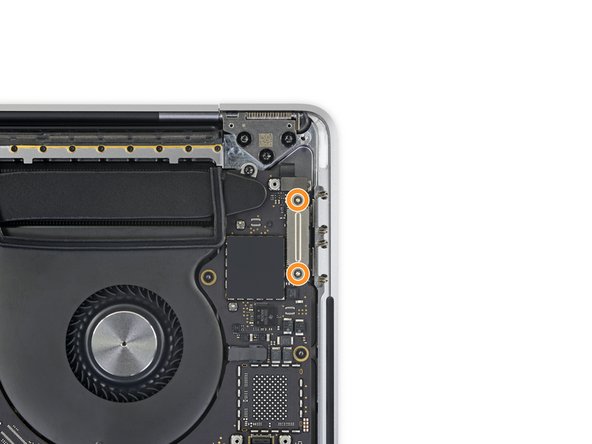

  24. MacBook Pro 15" Touch Bar 2019 Battery Replacement: crwdns2935265:024crwdnd2935265:01crwdnd2935265:02crwdne2935265:0 MacBook Pro 15" Touch Bar 2019 Battery Replacement: crwdns2935265:024crwdnd2935265:02crwdnd2935265:02crwdne2935265:0
    • Use a T3 Torx driver to remove the two 3.5 mm screws securing the cover on the display board flex cable.
    • Remove the display board flex cover.
    I was able to complete this procedure successfully without removing the logic board. I don’t use any liquid adhesive remover. I employ A rubber type silicon rubber-semi stiff spatula used for putting icing on cakes. Use careful leveraged prying, sliding under battery to break the adhesive seal. Also careful application of heat with a heat gun being careful to not damage the speakers. I remove all logic board screws, disconnect all service cables including USB C caps on both sides. The goal is to be able to carefully ”lift” The lower edge of logic board most proximal to the battery enough to allow the ribbon cable to clear the “ridge” that is on rear edge of the battery compartment, Thus allowing you to pull the battery back horizontally towards The front edge laptop and out. I use popsicle sticks to keep the logic board lifted. Careful not to bend the board or break it! You need about 1/8” of clearance. 99% isopropyl alcohol libera dabbed on with a Q-tip to adhesive residue will clean it off.

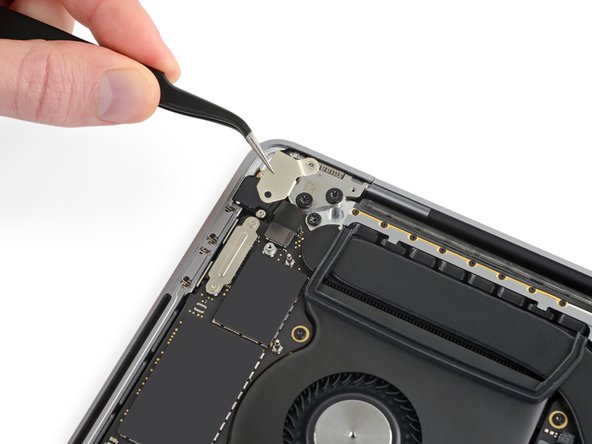

  29. MacBook Pro 15" Touch Bar 2019 Battery Replacement: crwdns2935265:029crwdnd2935265:01crwdnd2935265:03crwdne2935265:0 MacBook Pro 15" Touch Bar 2019 Battery Replacement: crwdns2935265:029crwdnd2935265:02crwdnd2935265:03crwdne2935265:0 MacBook Pro 15" Touch Bar 2019 Battery Replacement: crwdns2935265:029crwdnd2935265:03crwdnd2935265:03crwdne2935265:0
    • Use a T3 Torx driver to remove the two 2.4 mm screws securing the cover bracket for the Touch ID and headphone jack cable connectors.
    • Remove the bracket.
    Here is a first! I did not notice this when disassembling but spent a bit of time validating I had reassembled things correctly. After 35 years of this stuff, you don’t see much new - just smaller. !
    —->The 2.4 mm screw closest to the hinge screws into the logic board screw circled in green T8 (larger head)at step 47.
    Try finding that screw in your bucket of spares!
    Brian Eustis - crwdns2934203:0crwdne2934203:0

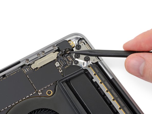

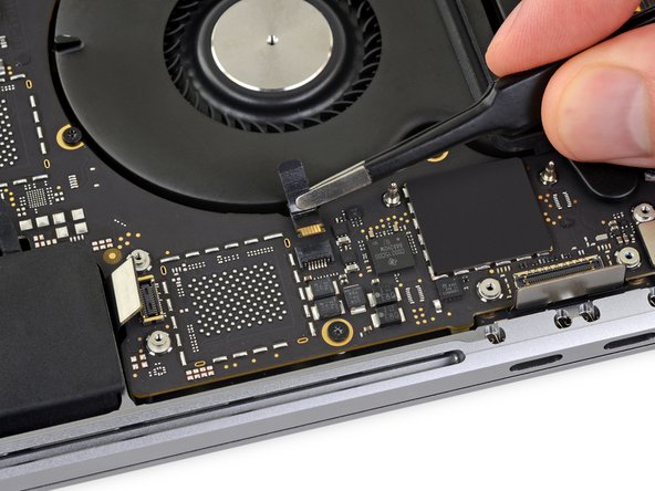

  30. MacBook Pro 15" Touch Bar 2019 Battery Replacement: crwdns2935265:030crwdnd2935265:01crwdnd2935265:02crwdne2935265:0 MacBook Pro 15" Touch Bar 2019 Battery Replacement: crwdns2935265:030crwdnd2935265:02crwdnd2935265:02crwdne2935265:0
    • Disconnect the headphone jack flex connector by prying it straight up from the logic board.

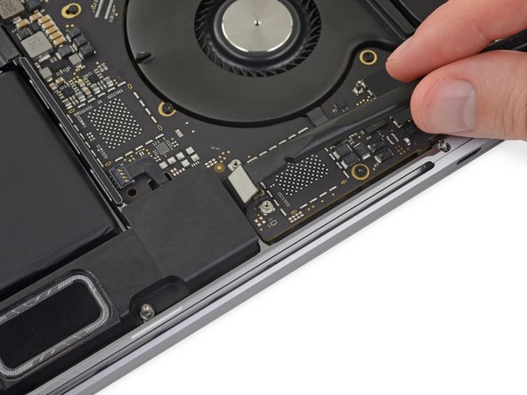

  31. MacBook Pro 15" Touch Bar 2019 Battery Replacement: crwdns2935265:031crwdnd2935265:01crwdnd2935265:02crwdne2935265:0 MacBook Pro 15" Touch Bar 2019 Battery Replacement: crwdns2935265:031crwdnd2935265:02crwdnd2935265:02crwdne2935265:0
    • Disconnect the power button and Touch ID sensor by prying its connector straight up from the logic board.
    This smaller connector cable of the touch ID sensor that sits underneath the power sensor connector is easy to overlook when replacing the logic board. It is small & short and can easily hide. Make sure you account for it when placing the LB in and before screwing it down.
    Macrepair SF - crwdns2934203:0crwdne2934203:0

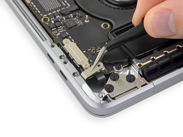

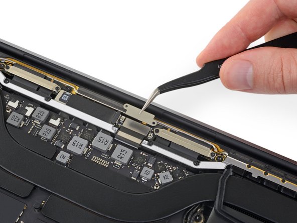

  32. MacBook Pro 15" Touch Bar 2019 Battery Replacement: crwdns2935265:032crwdnd2935265:01crwdnd2935265:01crwdne2935265:0
    • Using a T3 Torx driver, remove the 1.3 mm screw securing the cover bracket for the Touch Bar digitizer connector.
  33. MacBook Pro 15" Touch Bar 2019 Battery Replacement: crwdns2935265:033crwdnd2935265:01crwdnd2935265:03crwdne2935265:0 MacBook Pro 15" Touch Bar 2019 Battery Replacement: crwdns2935265:033crwdnd2935265:02crwdnd2935265:03crwdne2935265:0 MacBook Pro 15" Touch Bar 2019 Battery Replacement: crwdns2935265:033crwdnd2935265:03crwdnd2935265:03crwdne2935265:0
    • Using your tweezers, slide the bracket toward the side edge of the MacBook Pro until it clears the slotted retaining tab on the logic board.

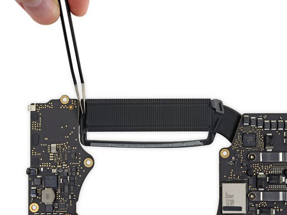

  35. MacBook Pro 15" Touch Bar 2019 Battery Replacement: crwdns2935265:035crwdnd2935265:01crwdnd2935265:02crwdne2935265:0 MacBook Pro 15" Touch Bar 2019 Battery Replacement: crwdns2935265:035crwdnd2935265:02crwdnd2935265:02crwdne2935265:0
    • Use a T3 Torx driver to remove the two 1.9 mm screws securing the bracket for the Touch Bar display cable connector.
  36. MacBook Pro 15" Touch Bar 2019 Battery Replacement: crwdns2935265:036crwdnd2935265:01crwdnd2935265:02crwdne2935265:0 MacBook Pro 15" Touch Bar 2019 Battery Replacement: crwdns2935265:036crwdnd2935265:02crwdnd2935265:02crwdne2935265:0
    • Disconnect the Touch Bar display cable by prying its connector straight up from the logic board.
    Right above the connector, there might be a chip attached instead of an empty space as shown in the photos. The connector will be close to the part but they are separate, and the connector can be safely removed.

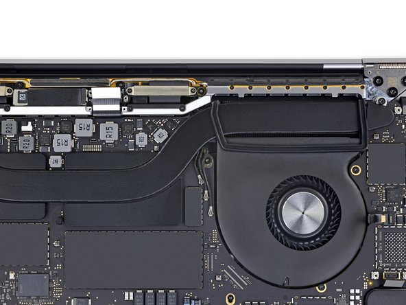

  37. MacBook Pro 15" Touch Bar 2019 Battery Replacement: crwdns2935265:037crwdnd2935265:01crwdnd2935265:02crwdne2935265:0 MacBook Pro 15" Touch Bar 2019 Battery Replacement: crwdns2935265:037crwdnd2935265:02crwdnd2935265:02crwdne2935265:0
    • Using a T3 Torx Driver:
    • Remove the two 1.3 mm screws securing the Thunderbolt flex cable cover on the left.
    • Remove two more 1.3 mm screws from the Thunderbolt cable cover on the right.

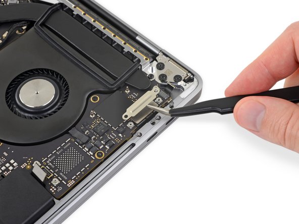

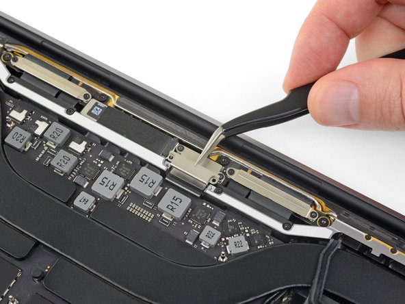

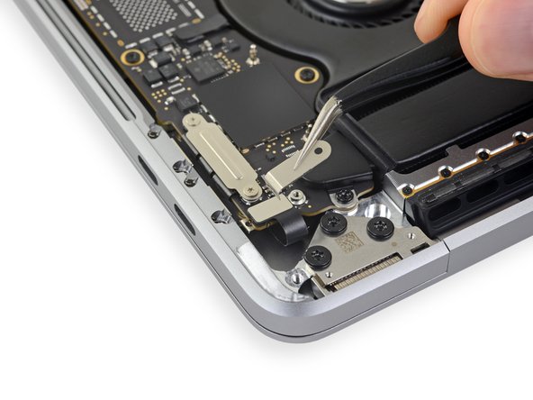

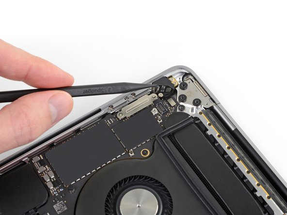

  38. MacBook Pro 15" Touch Bar 2019 Battery Replacement: crwdns2935265:038crwdnd2935265:01crwdnd2935265:02crwdne2935265:0 MacBook Pro 15" Touch Bar 2019 Battery Replacement: crwdns2935265:038crwdnd2935265:02crwdnd2935265:02crwdne2935265:0
    • Remove the cover brackets from both Thunderbolt cable sockets.
  39. MacBook Pro 15" Touch Bar 2019 Battery Replacement: crwdns2935265:039crwdnd2935265:01crwdnd2935265:03crwdne2935265:0 MacBook Pro 15" Touch Bar 2019 Battery Replacement: crwdns2935265:039crwdnd2935265:02crwdnd2935265:03crwdne2935265:0 MacBook Pro 15" Touch Bar 2019 Battery Replacement: crwdns2935265:039crwdnd2935265:03crwdnd2935265:03crwdne2935265:0
    • Use a spudger to disconnect the left-side Thunderbolt flex cable by prying it straight up from the logic board.
    • Pry from the inside edge, nearest the fan.
    • Gently push the flex cable connector off to the side so it doesn't interfere with logic board removal.

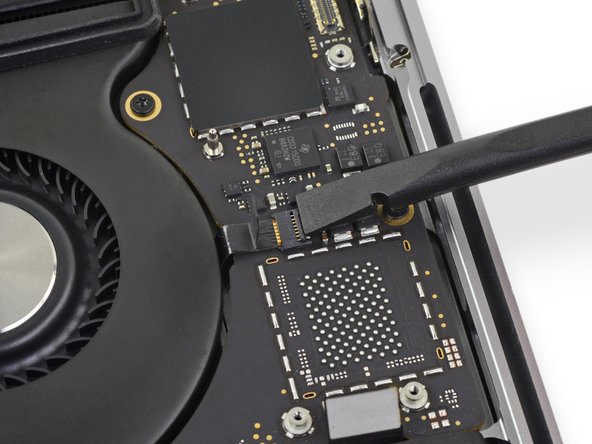

  40. MacBook Pro 15" Touch Bar 2019 Battery Replacement: crwdns2935265:040crwdnd2935265:01crwdnd2935265:03crwdne2935265:0 MacBook Pro 15" Touch Bar 2019 Battery Replacement: crwdns2935265:040crwdnd2935265:02crwdnd2935265:03crwdne2935265:0 MacBook Pro 15" Touch Bar 2019 Battery Replacement: crwdns2935265:040crwdnd2935265:03crwdnd2935265:03crwdne2935265:0
    • Repeat to disconnect the Thunderbolt flex cable connector on the opposite side.
    • Carefully push the flex cable connector aside so there's clearance for the logic board to come out without snagging.

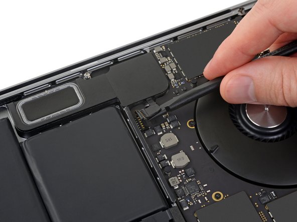

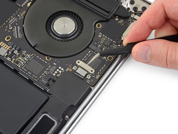

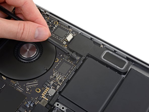

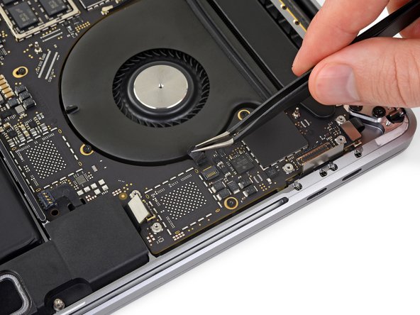

  41. MacBook Pro 15" Touch Bar 2019 Battery Replacement: crwdns2935265:041crwdnd2935265:01crwdnd2935265:03crwdne2935265:0 MacBook Pro 15" Touch Bar 2019 Battery Replacement: crwdns2935265:041crwdnd2935265:02crwdnd2935265:03crwdne2935265:0 MacBook Pro 15" Touch Bar 2019 Battery Replacement: crwdns2935265:041crwdnd2935265:03crwdnd2935265:03crwdne2935265:0
    • Disconnect the two speaker connectors by sliding the flat end of your spudger underneath each cable near its connector.
    • Gently twist or pry up to disconnect both speakers.
    Both had a dab of glue underneath. I used heat gun to loosen.
    On this step, it helped to use the tip of sharp tweezers to open the small metal tab of the connector to the side.

    After disconnecting the speaker connector, does the speaker just come out, or is it glued or screwed in place? All I need is to Replace the Right Speaker with a New one. This guide gets me to this point but doesn’t address replacing the speaker. Would like to know if it’s more complicated than that before I get started… Thanks
    Would be nice to have a guide just for Speaker Replacement. Thanks
    Chad Gagnon - crwdns2934203:0crwdne2934203:0
    My right speaker doesn't work now because the cable and connector disconnected from the logic board. From one problem to another now... What should I do?
    Blake Johnson - crwdns2934203:0crwdne2934203:0
    ⚠️ DON'T DO THIS FOR THE LEFT SPEAKER!
    The right speaker has a six-pin connector which is wider than the spadler. The procedure described is correct.
    But the left speaker has a four-pin connector, narrower than the flat end of your spadler. If you slide it under the mat and lift, even gently, you will pull the connector off the motherboard.
    And, like me, you'll get the same problem as Blake Johnson.
    PS : Why six and four pins for a speaker?
    Francis Gernet - crwdns2934203:0crwdne2934203:0
    The cables are glued in place. It look more force than I was comfortable with to get the spudger under the cable. Heat helped.
    Mark Morin - crwdns2934203:0crwdne2934203:0
    Ugh… the right speaker connector seems to have slightly lifted off the motherboard on the inner edge despite being super careful after seeing those comments. Bad design, Apple. 😐
    KURTIS KRONK - crwdns2934203:0crwdne2934203:0
    Alright… surgery was a success despite the right speaker connection slightly lifting on one side from motherboard. Sound still works for me so far. My advice to avoid this is use another spudger to hold down the side you are prying on so it cannot lift off the motherboard. Do that and you will be golden. Good luck, take your time.
    Very gently! there's a bit of glue underneath, but very gently pry it but don't force it.
    If you are worried about these comments, prying up the connection point itself - what i did was use a finger to hold down the connector and whilst I worked the cable up from the glue , and then made use of the blue pry tool to hold the connection point down - placing it on the small piece of plastic that is nearest to the battery, then followed the guide to disconnect the cable ( twist gently)
    Sam Hammond - crwdns2934203:0crwdne2934203:0
  42. MacBook Pro 15" Touch Bar 2019 Battery Replacement: crwdns2935265:042crwdnd2935265:01crwdnd2935265:02crwdne2935265:0 MacBook Pro 15" Touch Bar 2019 Battery Replacement: crwdns2935265:042crwdnd2935265:02crwdnd2935265:02crwdne2935265:0
    • Peel up any tape covering the microphone cable connector socket.
    Wenn möglich das Klebeband nicht abziehen! Zwei Schritte weiter bist Du froh darum.
    Stephan Zenger - crwdns2934203:0crwdne2934203:0
  43. MacBook Pro 15" Touch Bar 2019 Battery Replacement: crwdns2935265:043crwdnd2935265:01crwdnd2935265:03crwdne2935265:0 MacBook Pro 15" Touch Bar 2019 Battery Replacement: crwdns2935265:043crwdnd2935265:02crwdnd2935265:03crwdne2935265:0 MacBook Pro 15" Touch Bar 2019 Battery Replacement: crwdns2935265:043crwdnd2935265:03crwdnd2935265:03crwdne2935265:0
    • Open the locking flap on the microphone cable's ZIF connector by prying it straight up from the logic board.
    During reassembly, when trying to lock the ZIF connector flap, the flap jumped out of the connector.
    If this happens to you and you are lucky, as I was, maybe it is not broken. It is possible to fix it, but you will need dexterity and patience as this is a very tiny part.
    I had to go and get my watchmaker eyeglass to actually see what was going on.
    I also found this iFixit tutorial. Here is the link so you don't have to look for it:
    Repositionnement du clapet de connecteur de nappe flexible
    Cédric Bontems - crwdns2934203:0crwdne2934203:0
  44. MacBook Pro 15" Touch Bar 2019 Battery Replacement: crwdns2935265:044crwdnd2935265:01crwdnd2935265:02crwdne2935265:0 MacBook Pro 15" Touch Bar 2019 Battery Replacement: crwdns2935265:044crwdnd2935265:02crwdnd2935265:02crwdne2935265:0
    • Disconnect the microphone by pulling its cable toward the fan until it releases from its socket.
    • If possible, pull on the tape attached to the cable, rather than the cable itself, to reduce the risk of damage.
    At this stage, when reassembling, I did disconnect the zif connector locking flap.
    If this happens to you, it is not necessarily broken. It can be fixed with very fine tweezers, a good magnifier, and a bit of patience.
    I had to go and get my watchemaker magnifier to achieve this.
    Here is a link to the tutorial if you need it:

  45. MacBook Pro 15" Touch Bar 2019 Battery Replacement: crwdns2935265:045crwdnd2935265:01crwdnd2935265:02crwdne2935265:0 MacBook Pro 15" Touch Bar 2019 Battery Replacement: crwdns2935265:045crwdnd2935265:02crwdnd2935265:02crwdne2935265:0
    • Use a T5 Torx driver to remove the single 2.9 mm screw securing the antenna cable bundle.
    Tanks for this amazing tutorial!
    Since the next step is removing additional screws connecting the motherboard and the 2.9 mm are colored all in orange there, I'd color also this one (the antenna cable bundle) in orange, just for clarity.
    Saul - crwdns2934203:0crwdne2934203:0
  46. MacBook Pro 15" Touch Bar 2019 Battery Replacement: crwdns2935265:046crwdnd2935265:01crwdnd2935265:03crwdne2935265:0 MacBook Pro 15" Touch Bar 2019 Battery Replacement: crwdns2935265:046crwdnd2935265:02crwdnd2935265:03crwdne2935265:0 MacBook Pro 15" Touch Bar 2019 Battery Replacement: crwdns2935265:046crwdnd2935265:03crwdnd2935265:03crwdne2935265:0
    • Disconnect all three antenna cables by prying each one straight up from its socket.
    • Slide your tweezers or the flat end of your spudger underneath each cable until it's near the socket, and then gently twist or pry up to disconnect it.
    • To reconnect each cable, align the connector directly over its socket, and then press down so it snaps into place.
  47. MacBook Pro 15" Touch Bar 2019 Battery Replacement: crwdns2935265:047crwdnd2935265:01crwdnd2935265:02crwdne2935265:0 MacBook Pro 15" Touch Bar 2019 Battery Replacement: crwdns2935265:047crwdnd2935265:02crwdnd2935265:02crwdne2935265:0
    • Remove all ten screws securing the logic board assembly:
    • Two 2.6 mm T3 Torx screws
    • Five 2.9 mm T5 Torx screws
    • One 3.7 mm T5 Torx screw
    • One 3.9 mm T8 Torx screw (large head)
    • One 4.0 mm T8 Torx screw
    • During reassembly, install these screws only loosely. Adjust the board position if necessary until all the connectors line up, and then tighten the screws.
    When reassambling, the screw in the top left corner (coloured green here) is the one with a threaded hole in its head. This is used to secure one of T3 screws in Step 29. Took me a while to figure this out.
    John Feeney - crwdns2934203:0crwdne2934203:0

    • The logic board assembly is a tight fit, but you can make it easier to remove by inserting a spudger under the left edge and levering it up slightly.
    • There should be no resistance as you remove the logic board. Check all cables carefully and hold them out of the way if needed so they don't snag on the board.
    • Lifting from the left side, remove the logic board.
    To ease logic board removal (and especially later for reinstallation), I choose to gently bend each connector away from the logic board & use a little tape to hold them out of the way.
    Tech Medic - crwdns2934203:0crwdne2934203:0
    Is there new adhesive for fans? I’m into deep . 50/50 shot.. I get his back together ..😩
    Gerald Rappaport - crwdns2934203:0crwdne2934203:0
    For me, I didn’t have to remove the MOBO. To be honest i didn’t need to follow the steps that require you to remove certain plugs. It may help to remove the speakers and what not, but other than that you don’t have to remove the whole thing. Also this is from my experience. So don’t get mad at me if it doesn’t work. Goodluck!
    Neo - crwdns2934203:0crwdne2934203:0
    Did anyone feel there's no going back after removing the Logic Board? LOL!

  51. MacBook Pro 15" Touch Bar 2019 Battery Replacement, Battery: crwdns2935265:051crwdnd2935265:01crwdnd2935265:02crwdne2935265:0 MacBook Pro 15" Touch Bar 2019 Battery Replacement, Battery: crwdns2935265:051crwdnd2935265:02crwdnd2935265:02crwdne2935265:0
    • Remove the two screws securing the battery board:
    • 2016-2017 models: Use a T5 Torx driver to remove both 3.5 mm screws.
    • 2018-2019 models: Use a P2 Pentalobe driver to remove both 3.2 mm screws.
    On my mid 2018 15.3” i9 MBP the battery board screws were PL1
    I second this. If your repair is time-sensitive, consider making sure you have a PL1 driver in advance. Seeing that IFixit doesn’t seem to sell them, I bought a german-made Wiha driver, hoping the quality would be high. You never want these things to strip!

    P2 bit end broke unscrewing the second of these screws… Now I have a piece of the bit stuck in the screw head and a MacBook completely disassembled…
    one.dakine.howlie - crwdns2934203:0crwdne2934203:0
    Same just happened to me a, but I could get the screw out with a small pair of pliers, and then remove the broken tip from it with some banging on the desk. Took me 5 min, but I wasn’t sure that it will work, so I was a bit nervous 😬

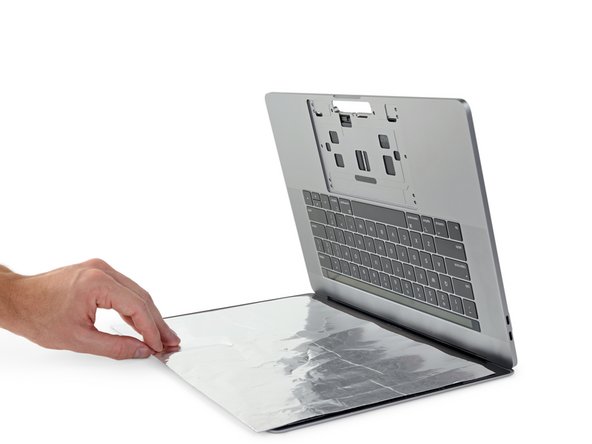

  52. MacBook Pro 15" Touch Bar 2019 Battery Replacement: crwdns2935265:052crwdnd2935265:01crwdnd2935265:03crwdne2935265:0 MacBook Pro 15" Touch Bar 2019 Battery Replacement: crwdns2935265:052crwdnd2935265:02crwdnd2935265:03crwdne2935265:0 MacBook Pro 15" Touch Bar 2019 Battery Replacement: crwdns2935265:052crwdnd2935265:03crwdnd2935265:03crwdne2935265:0
    • The liquid adhesive remover provided in your kit can damage the antireflective coating on your MacBook Pro's display, as well as the plastic keyboard keys.
    • To protect your display, place a sheet of aluminum foil between the display and keyboard and leave it there while you work.
    • Additionally, use painter's tape to seal off the area under the trackpad as best you can. Optionally, you may also layer an absorbent towel directly underneath the trackpad area to soak up any excess adhesive remover.
    I didn’t have any solution and was hesitant to simply use an Isopropyl Alcohol solution of any concentration let along subject my electronics to liquid and aluminum foil, so I simply took a card (something between a metrocard and credit card… i used a rewards card) and brute forced the adhesive while dry (making sure to direct the bulk of the force laterally and not down into the screen below and mostly wiggle back and forth instead of straight on). About 10 minutes later with a sore hand it worked just fine and avoided steps 52-62. (You may want to try the string method detailed in step 62 if stubborn and after started with card.
    ajm0824 - crwdns2934203:0crwdne2934203:0
    The alu foil and the paint tape make it much safer, use them!
    Cristian Caprar - crwdns2934203:0crwdne2934203:0
    Also removing battery with adhesive remover is quite dangerous (I don't like the idea of liquids around my MacBook insides) so you can do it slowly a carefully with just some plastic cards (like in step 57) putting below the batteries (I used my old credit cards to do this).
    durmstrang - crwdns2934203:0crwdne2934203:0
    What about WD-40? in a spray can!
    Richard Holmes - crwdns2934203:0crwdne2934203:0

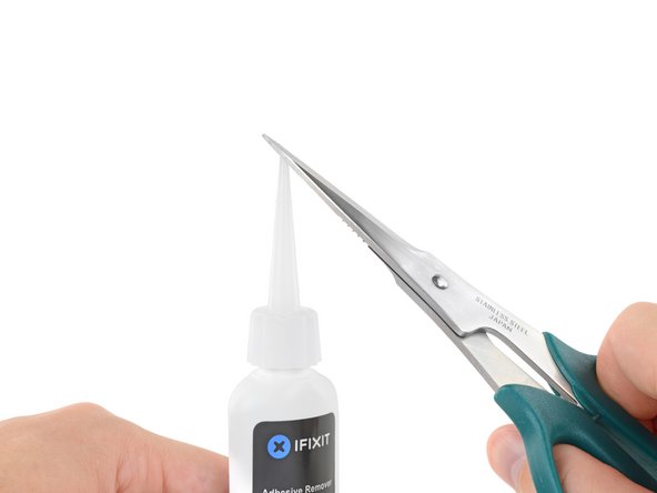

  55. MacBook Pro 15" Touch Bar 2019 Battery Replacement: crwdns2935265:055crwdnd2935265:01crwdnd2935265:03crwdne2935265:0 MacBook Pro 15" Touch Bar 2019 Battery Replacement: crwdns2935265:055crwdnd2935265:02crwdnd2935265:03crwdne2935265:0 MacBook Pro 15" Touch Bar 2019 Battery Replacement: crwdns2935265:055crwdnd2935265:03crwdnd2935265:03crwdne2935265:0
    • Pull off the black rubber stopper from your bottle of adhesive remover.
    • Twist to loosen or remove the bottle cap before you cut the applicator tip.
    • This unseals the bottle and allows the pressure to equalize before you cut the applicator tip. If you skip this step, the adhesive remover may spray out unexpectedly when the tip is cut.
    • Use scissors to cut off the sealed tip of the applicator.
    • Cutting close to the narrow tip will give you better control so you can apply the adhesive remover in small amounts.
    • Twist and close the bottle cap securely before you proceed further.
    Eignet sch auch Isopropyl-Alkohol 99,9%?
    Felix - crwdns2934203:0crwdne2934203:0
    The latest Adhesive Remover arrives already with a tiny hole at the tip and the bottle cap and tip is now black instead of clear.
    tomasponce - crwdns2934203:0crwdne2934203:0
    The plastic bottle containing the adhesive remover included with my battery kit does not have a long and tapered cap/tip; as pictured. The one included in my kit from ifixit is much shorter and too wide to fit into the space between the battery and the case as pictured. I adapted by getting a paper clip and placing it where I wanted the solvent to flow to. I then touched solvent bottle tip to the paper clip just above, allowing the solvent to flow down the paper clip to the point below the battery where it will go to work. I did not have to squeeze the bottle in order for small amounts to flow to the desired location. I would move the paper clip and bottle along the edges of the battery as pictured, it worked out well for me.
    Virginia Gentleman - crwdns2934203:0crwdne2934203:0
    Addendum to the comment above: The paperclip I used was partially unbent so that it was effectively a straight wire I could use to place where I wanted the solvent to flow.
    I've done this repair now four times. I've NEVER used any solvent.
    The credit card/plastic scraper works pretty well but of all the ideas, my favorite is the very strong nylon fishing line. Something in the 50 - 100 lb variety so it won't break easily. The other thing that really helps is if the whole case is warm - NOT hot but warm like 100 deg F or something. This makes the adhessive much more likely to separate that when it is cold.
    I've done it in the winter and summer so definitely can attest to it being easier in the summer when it's warmer.
    Also, despite having replaced the battery now four times, I have yet to reapply any adhesive. The replacement battery pack sticks just fine in place with no effort.
    I place wax paper (or the equivalent) under the old battery as I'm plying up each cell. That way the cell doesn't stick back down. When I'm putting in the new battery, I use the wax paper (or similar) to keep the cells from sticking down in the wrong place. Then remove it and lay down the cells.

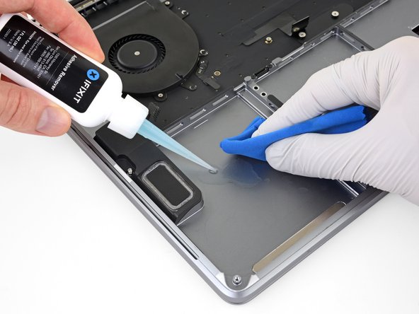

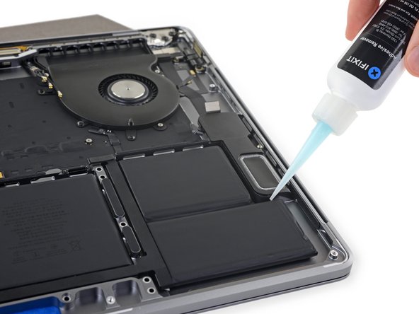

  56. MacBook Pro 15" Touch Bar 2019 Battery Replacement: crwdns2935265:056crwdnd2935265:01crwdnd2935265:02crwdne2935265:0 MacBook Pro 15" Touch Bar 2019 Battery Replacement: crwdns2935265:056crwdnd2935265:02crwdnd2935265:02crwdne2935265:0
    • Apply a few drops of adhesive remover underneath the two battery cells on the right, starting along the edge nearest the fan.
    • You don't need to use very much. The small bottle contains more than twice the amount of solvent needed to remove all the battery cells.
    The bottle may (will!) squirt liquid. I used a bit of absorbant paper around the tip while turning the bottle upside down and putting the tip where it needs to go. Be especially careful not to drip liquid onto the speakers.
    For this type of work I always have a roll of thick toilet paper nearby: its leaves are smaller than those of kitchen paper.
    Robert Cailliau - crwdns2934203:0crwdne2934203:0
    Point of Note: this is much easier the second time around, mainly due to the lack of (excessively) strong adhesive from Apple. I am replacing the battery I replaced c. 2020, and iFixit's adhesive reacts much better to the adhesive remover. I used less than a quarter of the provided fluid, and it took 5-10 minutes of minimal strategic prying, compared to the ~1 hour of wiggling and reapplying that the Apple adhesive required!
    Ben Huggins - crwdns2934203:0crwdne2934203:0

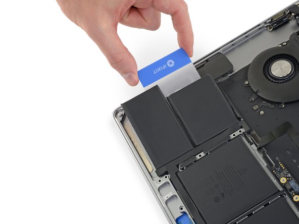

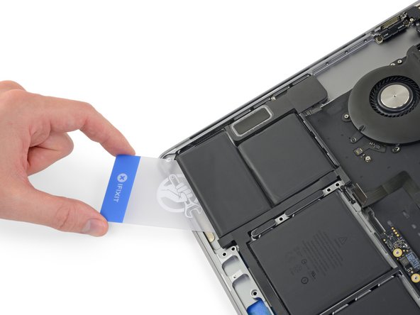

  58. MacBook Pro 15" Touch Bar 2019 Battery Replacement: crwdns2935265:058crwdnd2935265:01crwdnd2935265:03crwdne2935265:0 MacBook Pro 15" Touch Bar 2019 Battery Replacement: crwdns2935265:058crwdnd2935265:02crwdnd2935265:03crwdne2935265:0 MacBook Pro 15" Touch Bar 2019 Battery Replacement: crwdns2935265:058crwdnd2935265:03crwdnd2935265:03crwdne2935265:0
    Plastic Cards
    $2.99
    • After a couple minutes, insert one corner of a plastic card underneath the battery, starting from the lower edge of the bottom, right-most cell.
    • This shouldn't require much force. If you have trouble, apply more adhesive remover and give it 2-3 additional minutes to penetrate.
    • Try not to deform the battery. A damaged or punctured battery can leak dangerous chemicals and/or catch fire.
    • Wiggle the card from side to side and slide it all the way underneath both battery cells.
    • Lift the cells to fully separate the adhesive, but don't try to remove them from your MacBook yet.
    • Leave the plastic card temporarily underneath the cells to prevent the adhesive from re-bonding as you proceed to the next step.
    I had a great deal of difficulty loosening the batteries. The solvent seemed to have little effect on the adhesive strips. Despite efforts, I deformed the batteries trying to get them free.
    Kent Folsom - crwdns2934203:0crwdne2934203:0
    I also had a great deal of difficulty. I had to apply the adhesive remover 5 times before I could wiggle the card underneath the first battery sections. And it left the adhesive on the computer case; it did not remove the adhesive along with the battery sections.
    rileybk - crwdns2934203:0crwdne2934203:0
    Took me three applications of adhesive remover. Think it really is about wiggling though.
    Nathan Skene - crwdns2934203:0crwdne2934203:0
    It took me about 10 minutes or so to remove all battery modules. I used the adhesive remover as per the guide and also used the card with the corner doing most of the penetration instead of the blunt end. I also would gently wiggle the battery up and down while I applied more adhesive remover to allow it a better chance of getting underneath. BTW, my adhesive strips ran left to right and not back to front on the outer batteries, so I would think it would be more ideal to put the adhesive remover down the left and right sides of the outer batteries. The inner batteries (under trackpad) adhesive strips ran front to back. Keep this in mind when using the remover to loosen them up.
    Steven Wonder - crwdns2934203:0crwdne2934203:0
    Once one of the packs is loose, stick a leaf of toilet paper under it, so that it cannot stick to the body again, while you are working on the other packs.
    One YouTuber uses a fairly short narrow and small thin-bladed and very essentially flexible cake spatula to push in under the battery lobes never sweeping sideways. No chemicals except for 99% propanol to remove the adhesive residue.
    hatuxka - crwdns2934203:0crwdne2934203:0
    See my comment in Step 63. Might save you time and trouble. Putty knife to remove batteries, then hot dryer to get black strips off followed by de-solv-it (or the Ifix-it remover) to get off the adhesive junk.
    Carl Schultz - crwdns2934203:0crwdne2934203:0
    I wanted to comment on what worked for me.
    I did put some of the remover on like they showed.
    I used the credit card plastic tool to kind of get underneath it.
    Then I used plastic putty knife and slowly and carefully pried the batteries off. I take no responsibility here for you, but it worked for me. Also I used 99% isopropoyl to clean the adhesive off.
    Also so you are probably reading this because it is hard, put the trackpad back like the other person said before you put the batteries in. I did that and it probably saved me time.
    Also as you reassemble, make you go look at every connector and there are a bunch and make sure those leads are all coming up through the logic board. I don't want to tell you I thought I was done 2x when I found a small cable at the end I missed. If you do end up in that case, you can remove some of the screws, and use the curved tweezers to kind of snake the cable up top. I know you aren't there yet, but as someone ahead of you, you'll remember this tip.
    Bryan Tanoue - crwdns2934203:0crwdne2934203:0
    The trick here was the use of a putty knife. As someone mentioned, the adhesive strips on mine also ran the direction of the width of the computer, not from the screen side down. Thus, putting the adhesive remover where the directions said only worked on the uppermost adhesive strip. The adhesive remover did nothing to help the process...
    Tim Lightfoot - crwdns2934203:0crwdne2934203:0
    If you're very careful not to deform the packs, you can (ON THE SIDE PACKS ONLY) use the spudger to help gently push through stubborn adhesive. DO NOT use it on the middle packs though, because there are little squarish holes in the body that you could push the spudger through and end up gouging the hell out of your display. And then you'll be back here tomorrow praying there's a tut for that :)
    halp - crwdns2934203:0crwdne2934203:0
    I also found the solvent to not have much effect. And this was after just basically dousing the gaps with the solvent and waiting several minutes. Honestly, I'm amazed that I got the battery out without deforming any of the segments as it took mostly brute strength of shoving the plastic cards underneath them and also the plastic cards got broken on the corners.
    Russell Martin - crwdns2934203:0crwdne2934203:0
    Some tips because this was nowhere as easy as this step makes it sound + the dropper that I receive in my kit is not the one in the pictures:
    1. Get thinner droppers. I got mine from Michael's. The one I recieved in the kit was thick and short.
    2. I had to apply the remover 4-5 times in each place between forecful wiggle attempts on the side battery.
    3. Same 4-5 applies on center batteries too. Here I used Colgate floss to create space and get the remover under the battery.
    4. Once old battery is out, used gloves to tear the black adhesive strips + wiped away the rest of the adhesive with microfiber + remover
    P.S. Get paper towels to wipe the cards between wiggle attempts. They're full of remover and liquified adhesive.

  59. MacBook Pro 15" Touch Bar 2019 Battery Replacement: crwdns2935265:059crwdnd2935265:01crwdnd2935265:03crwdne2935265:0 MacBook Pro 15" Touch Bar 2019 Battery Replacement: crwdns2935265:059crwdnd2935265:02crwdnd2935265:03crwdne2935265:0 MacBook Pro 15" Touch Bar 2019 Battery Replacement: crwdns2935265:059crwdnd2935265:03crwdnd2935265:03crwdne2935265:0
    • Switch to the left side of the MacBook Pro, and repeat the previous step to separate two more battery cells.
    • Leave the second plastic card in place temporarily.
  60. MacBook Pro 15" Touch Bar 2019 Battery Replacement: crwdns2935265:060crwdnd2935265:01crwdnd2935265:03crwdne2935265:0 MacBook Pro 15" Touch Bar 2019 Battery Replacement: crwdns2935265:060crwdnd2935265:02crwdnd2935265:03crwdne2935265:0 MacBook Pro 15" Touch Bar 2019 Battery Replacement: crwdns2935265:060crwdnd2935265:03crwdnd2935265:03crwdne2935265:0
    • Apply a few drops of adhesive remover along the top edges of the two center battery cells.
    • There are openings in the chassis underneath these two cells, which allow the adhesive remover to leak through and may prevent it from fully penetrating.
    • Be mindful of leaks, and apply more adhesive remover along the side edges if needed.
  61. MacBook Pro 15" Touch Bar 2019 Battery Replacement: crwdns2935265:061crwdnd2935265:01crwdnd2935265:03crwdne2935265:0 MacBook Pro 15" Touch Bar 2019 Battery Replacement: crwdns2935265:061crwdnd2935265:02crwdnd2935265:03crwdne2935265:0 MacBook Pro 15" Touch Bar 2019 Battery Replacement: crwdns2935265:061crwdnd2935265:03crwdnd2935265:03crwdne2935265:0
    • After a couple minutes, retrieve your first plastic card and insert one corner under the top edge of one of the center battery cells.
    • Wiggle it from side to side and slide it underneath the battery cell until all the adhesive separates.
    • If you have trouble, don't use excessive force and don't deform the battery. Apply more adhesive remover and try again, or skip down two steps for an alternate method.
    Once you get the card edge under a cell, you can apply a couple of drops on top of the card and it will flow down to the working edge of the card. This will make moving the card back and forth a lot easier.
    Scott Shore - crwdns2934203:0crwdne2934203:0
    I'd consider looking at step 62 first.
    Benny Baggott - crwdns2934203:0crwdne2934203:0
    It was really hard to get the middle batteries out. Two of my card have now missing corners that broke off. I did then the mistake to use a metal spade to get under the battery and pinched it. as a result it started to burn slightly (could blow it out though).
    After moving outside to reduce risk of fire, I tried the Step 62 with a wire that I squeezes in and pulled through carefully. The pinched batter I then pulled the wire from the other side, to avoid damaging the battery even more.
    So far so good, the batteries are out and the burn stains were easy to remove. Let's hope everything still works...
    Matt - crwdns2934203:0crwdne2934203:0
    I used regular floss here to pry open the battery and create room for the adhesive remover to go in
    Ivan K - crwdns2934203:0crwdne2934203:0

    In order to not remove everything, I reduce the procedure in following only steps 1 to 18 (until trackpad cable is pushed away).
    Then I removed the “low “ screws of step 46 in order to losen the fixation of “bottom” of the motherboard, as there is no room to remove the battery board and its ribbons).
    Then I removed the two screws of the step 50 (battery board). To take off the glued battery, I used twine or thread (e.g. as shown here: https://www.youtube.com/watch?v=fupkPz55...) but not acetone nor diluant.
    Then I lifted very carefully the bottom of the motherboard both to push away the battery board and its ribbons and to reinsert the new battery board and ribbons.
    Then I proceed backward to remount (step 50, step 46 then step 18 to 1).
    Note: my “old” battery was so inflated that the two screws of the lower case near the trackpad were difficult to remove (sometimes, this leads to a malfunctioning…
    Thank to Jeff for this overall procedure which helps me a lot.

    Did they change the step numbers? You mention step 46 and 50, but now it looks like these are steps 47 and 51.
    strells -
    Hi Strells, in the english or french version, it seems that it is always step 50 (two screws for battery) and 46 (“lower” screws for motherboard).
    jompo -
    As Jompo Discovered, I also concur: LB removal not necessary. “removed the “low “ screws of step 46 in order to losen the fixation of “bottom” of the motherboard, as there is no room to remove the battery board and its ribbons)”
    Be careful, I removed all screws from LB & disconnected speakers as well. .

    I used alcohol 96% to get the glue off the battery and a old card.

    Uh oh I did this and now the machine won’t turn on. When I open the lid it shows the battery level for a second then it disappears. No amount of key presses seems to work. Any ideas here? I assume I messed up the keyboard or some other connection?
    Elijah Delventhal - crwdns2934203:0crwdne2934203:0
    Ah I fixed it. Double check step 31, that was my issue. The connector for the power button is right below another one.

    Falk Eckert - crwdns2934203:0crwdne2934203:0
    I would check you reconnected the power button you disconnected in step 31 as per the comments above.
