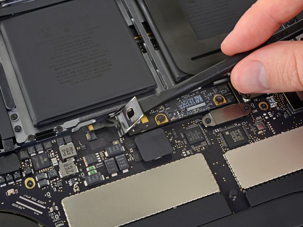

  15. MacBook Pro 15" Touch Bar 2017 Trackpad Replacement, Trackpad Assembly: crwdns2935265:015crwdnd2935265:01crwdnd2935265:02crwdne2935265:0 MacBook Pro 15" Touch Bar 2017 Trackpad Replacement, Trackpad Assembly: crwdns2935265:015crwdnd2935265:02crwdnd2935265:02crwdne2935265:0
    • Use a T3 Torx driver to remove the two 1.9 mm screws securing the trackpad cable's cover bracket.
    • Remove the bracket.
  16. MacBook Pro 15" Touch Bar 2017 Trackpad Replacement: crwdns2935265:016crwdnd2935265:01crwdnd2935265:02crwdne2935265:0 MacBook Pro 15" Touch Bar 2017 Trackpad Replacement: crwdns2935265:016crwdnd2935265:02crwdnd2935265:02crwdne2935265:0
    • Use a spudger to disconnect the trackpad cable by prying its connector straight up from the logic board.
