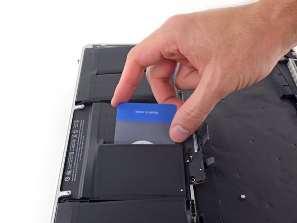

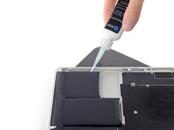

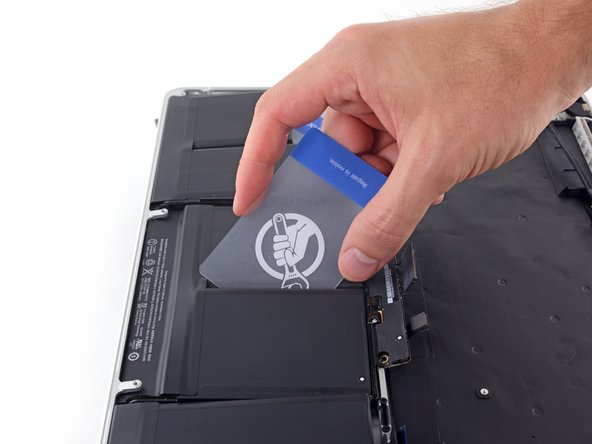

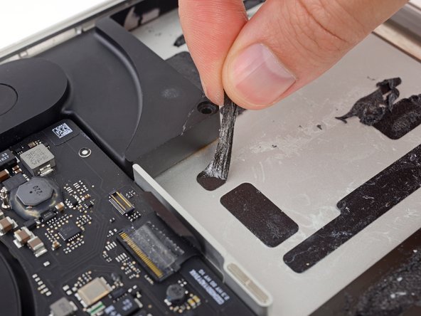

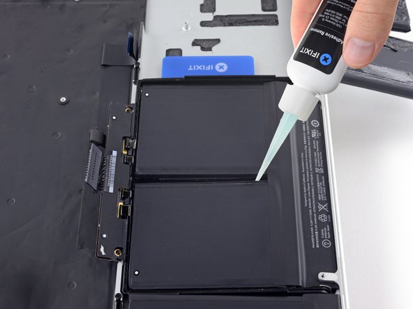

    1. MacBook Pro 15" Retina Display Mid 2014 Battery Replacement, Battery: crwdns2935265:034crwdnd2935265:01crwdnd2935265:01crwdne2935265:0
      • Remove the two 3.2 mm T5 Torx screws securing the battery board.
    2. MacBook Pro 15" Retina Display Mid 2014 Battery Replacement: crwdns2935265:035crwdnd2935265:01crwdnd2935265:01crwdne2935265:0
      • The liquid adhesive remover provided in your kit can affect the antireflective coating on your MacBook Pro's display.
      • To protect your display, place a sheet of aluminum foil between the display and keyboard and leave it there while you work.
    3. MacBook Pro 15" Retina Display Mid 2014 Battery Replacement: crwdns2935265:036crwdnd2935265:01crwdnd2935265:02crwdne2935265:0 MacBook Pro 15" Retina Display Mid 2014 Battery Replacement: crwdns2935265:036crwdnd2935265:02crwdnd2935265:02crwdne2935265:0

    6. MacBook Pro 15" Retina Display Mid 2014 Battery Replacement: crwdns2935265:039crwdnd2935265:01crwdnd2935265:02crwdne2935265:0 MacBook Pro 15" Retina Display Mid 2014 Battery Replacement: crwdns2935265:039crwdnd2935265:02crwdnd2935265:02crwdne2935265:0
      • Apply a few drops of adhesive remover evenly along the elevated edge of the outer right battery cell.
      • You don't need to use very much. The small bottle contains more than twice the amount of solvent needed to remove all the battery cells.
      • Wait 2-3 minutes for the liquid adhesive remover to penetrate underneath the battery cell before you proceed to the next step.

      • Slide one corner of a plastic card under the outer edge of the battery cell.
      • It may help to gently twist the card to open up a slight gap between the battery cell and the MacBook Pro's case.
      • Slide the card farther underneath the battery cell to separate it from the adhesive securing it to the MacBook Pro's upper case.

      • Slide one corner of a plastic card between the middle two cells, and under the elevated edge of the center-right battery cell.
      • Slide the card farther underneath the battery cell to slice through the adhesive securing it in place.
      • Don't try to fully separate this battery cell yet. Leave your plastic card in place to prevent it from re-adhering.

      • Apply a few drops of adhesive remover between the two center battery cells, so that it flows underneath the remaining battery cell.
      • Wait 2-3 minutes for the adhesive remover to penetrate before you continue.

      • Lift and remove the battery.
      • Before installing your new battery, remove all the old adhesive from the MacBook Pro's case.
      • With a little luck, you can slowly pull out each strip of adhesive with your fingers.
      • Otherwise, soak each strip of adhesive with a bit of adhesive remover for 2-3 minutes, and then scrape it out with a plastic tool. This can take quite a bit of work, so be patient. While scraping, take care not to damage the trackpad cable.
      • Mop up any remaining adhesive remover and give your MacBook Pro a few minutes to air dry.
