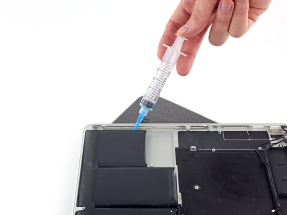

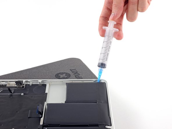

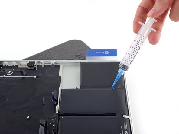

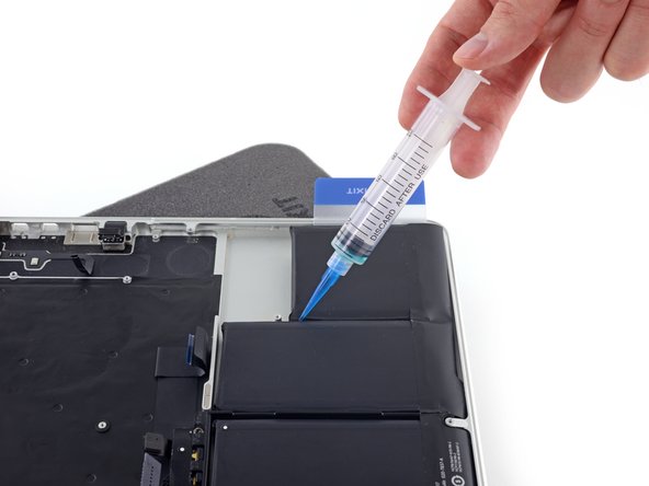

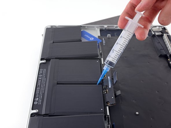

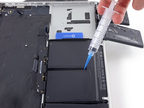

    1. MacBook Pro 15" Retina Display Mid 2014 Battery Replacement (Legacy), Battery: crwdns2935265:034crwdnd2935265:01crwdnd2935265:01crwdne2935265:0
      • Remove the two 3.2 mm T5 Torx screws securing the battery board.

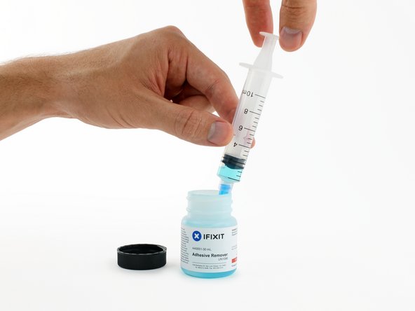

    2. MacBook Pro 15" Retina Display Mid 2014 Battery Replacement (Legacy): crwdns2935265:035crwdnd2935265:01crwdnd2935265:01crwdne2935265:0
      • The liquid adhesive remover provided in your kit can affect the antireflective coating on your MacBook Pro's display.
      • To protect your display, place a sheet of aluminum foil between the display and keyboard and leave it there while you work.

      • Open your container of adhesive remover.
      • Fill the syringe included in your kit with a small amount (approximately 1-2 milliliters) of adhesive remover.
      • It's best to fill the syringe with no more than about 1-2 milliliters of adhesive remover at a time, so as to avoid accidentally applying too much.
      • Refill your syringe as needed throughout the rest of this procedure.
    6. MacBook Pro 15" Retina Display Mid 2014 Battery Replacement (Legacy): crwdns2935265:039crwdnd2935265:01crwdnd2935265:02crwdne2935265:0 MacBook Pro 15" Retina Display Mid 2014 Battery Replacement (Legacy): crwdns2935265:039crwdnd2935265:02crwdnd2935265:02crwdne2935265:0
      • Apply a small amount of adhesive remover (approximately 1 ml) evenly along the elevated edge of the outer right battery cell.
      • Wait 2-3 minutes for the liquid adhesive remover to penetrate underneath the battery cell before you proceed to the next step.

      • Apply a small amount of adhesive remover (approximately 1 ml) evenly along the elevated edge of the next battery cell.

    12. MacBook Pro 15" Retina Display Mid 2014 Battery Replacement (Legacy): crwdns2935265:045crwdnd2935265:01crwdnd2935265:02crwdne2935265:0 MacBook Pro 15" Retina Display Mid 2014 Battery Replacement (Legacy): crwdns2935265:045crwdnd2935265:02crwdnd2935265:02crwdne2935265:0
      • With the left edge of your MacBook Pro still propped up, apply a small amount (about 1 ml) of adhesive remover down the center line between the two middle battery cells.
      • Wait 2-3 minutes for the adhesive remover to penetrate before you continue.

    18. MacBook Pro 15" Retina Display Mid 2014 Battery Replacement (Legacy): crwdns2935265:051crwdnd2935265:01crwdnd2935265:02crwdne2935265:0 MacBook Pro 15" Retina Display Mid 2014 Battery Replacement (Legacy): crwdns2935265:051crwdnd2935265:02crwdnd2935265:02crwdne2935265:0
      • Apply a small amount (about 1 ml) of adhesive remover between the two center battery cells, so that it flows underneath the remaining battery cell.
