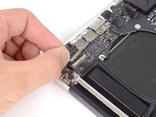

  6. MacBook Pro 15" Retina Display Mid 2012 LCD Cable Replacement: crwdns2935265:06crwdnd2935265:01crwdnd2935265:01crwdne2935265:0
    • Use the tip of a spudger to push the camera cable connector out of its socket on the logic board toward the fan.
    • Be sure to slide the connector parallel to the logic board. It is best to slide it first on one side and then on the other side so that it gradually moves out of the socket. Do not pry up or you will damage the connector.

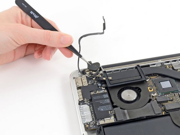

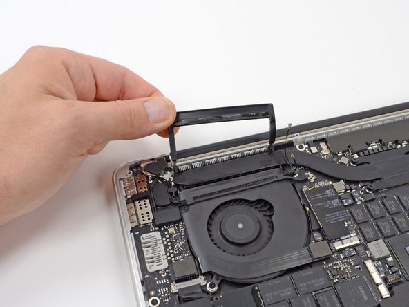

  7. MacBook Pro 15" Retina Display Mid 2012 LCD Cable Replacement: crwdns2935265:07crwdnd2935265:01crwdnd2935265:03crwdne2935265:0 MacBook Pro 15" Retina Display Mid 2012 LCD Cable Replacement: crwdns2935265:07crwdnd2935265:02crwdnd2935265:03crwdne2935265:0 MacBook Pro 15" Retina Display Mid 2012 LCD Cable Replacement: crwdns2935265:07crwdnd2935265:03crwdnd2935265:03crwdne2935265:0
    • Insert the flat end of a spudger under the rubber sleeve on the right fan heatsink.
    • Run the spudger under the entire length of the casing to loosen the adhesive.
    • Lift the sheath and fold it back so you can access the cables underneath.

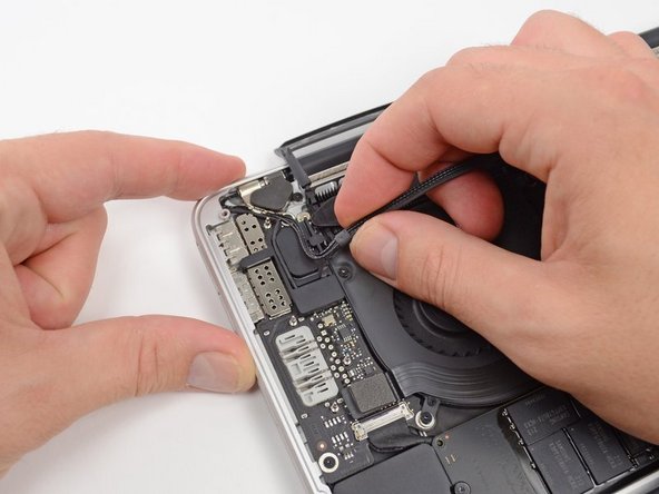

  8. MacBook Pro 15" Retina Display Mid 2012 LCD Cable Replacement: crwdns2935265:08crwdnd2935265:01crwdnd2935265:03crwdne2935265:0 MacBook Pro 15" Retina Display Mid 2012 LCD Cable Replacement: crwdns2935265:08crwdnd2935265:02crwdnd2935265:03crwdne2935265:0 MacBook Pro 15" Retina Display Mid 2012 LCD Cable Replacement: crwdns2935265:08crwdnd2935265:03crwdnd2935265:03crwdne2935265:0
    • Use your fingers to pull the AirPort/camera cables up and away from the fan.
    • The cables are glued to the fan, so you must pull carefully to avoid damaging them.
    • Carefully unroute the cables from their plastic guides.

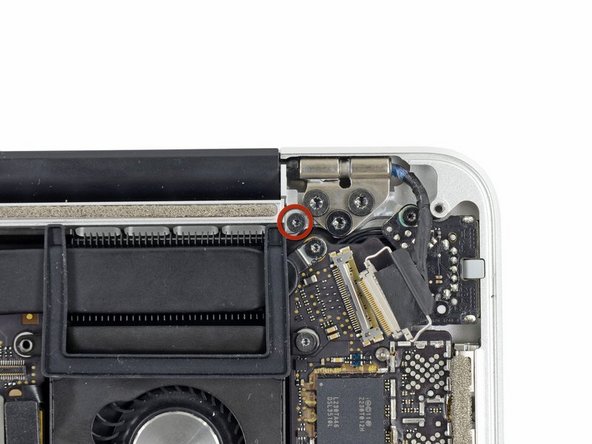

  10. MacBook Pro 15" Retina Display Mid 2012 LCD Cable Replacement: crwdns2935265:010crwdnd2935265:01crwdnd2935265:02crwdne2935265:0 MacBook Pro 15" Retina Display Mid 2012 LCD Cable Replacement: crwdns2935265:010crwdnd2935265:02crwdnd2935265:02crwdne2935265:0

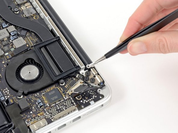

    • Use tweezers to lift the rubber covers over the left and right display hinges.
  11. MacBook Pro 15" Retina Display Mid 2012 LCD Cable Replacement: crwdns2935265:011crwdnd2935265:01crwdnd2935265:02crwdne2935265:0 MacBook Pro 15" Retina Display Mid 2012 LCD Cable Replacement: crwdns2935265:011crwdnd2935265:02crwdnd2935265:02crwdne2935265:0

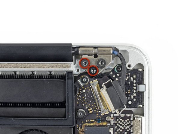

    • Remove the two 3.1mm Torx T5 screws securing the aluminum hinge brackets.
  12. MacBook Pro 15" Retina Display Mid 2012 LCD Cable Replacement: crwdns2935265:012crwdnd2935265:01crwdnd2935265:02crwdne2935265:0 MacBook Pro 15" Retina Display Mid 2012 LCD Cable Replacement: crwdns2935265:012crwdnd2935265:02crwdnd2935265:02crwdne2935265:0
    • Use tweezers to lift up the left and right hinge aluminum brackets.
  13. MacBook Pro 15" Retina Display Mid 2012 LCD Cable Replacement: crwdns2935265:013crwdnd2935265:01crwdnd2935265:02crwdne2935265:0 MacBook Pro 15" Retina Display Mid 2012 LCD Cable Replacement: crwdns2935265:013crwdnd2935265:02crwdnd2935265:02crwdne2935265:0
    • Remove the four internal 5.3mm Torx T8 screws (two on each side) securing the display to the upper case.

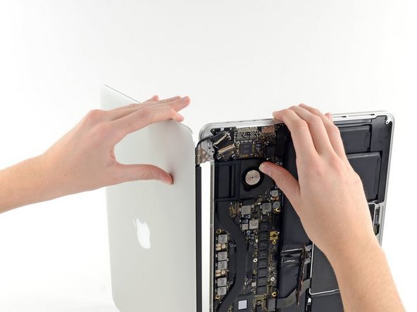

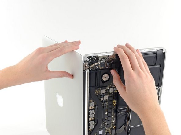

  15. MacBook Pro 15" Retina Display Mid 2012 LCD Cable Replacement: crwdns2935265:015crwdnd2935265:01crwdnd2935265:03crwdne2935265:0 MacBook Pro 15" Retina Display Mid 2012 LCD Cable Replacement: crwdns2935265:015crwdnd2935265:02crwdnd2935265:03crwdne2935265:0 MacBook Pro 15" Retina Display Mid 2012 LCD Cable Replacement: crwdns2935265:015crwdnd2935265:03crwdnd2935265:03crwdne2935265:0
    • Grasp both halves of the device, one in each hand.
    • Gently slide the bottom half of the device forward to separate it from the display assembly.
    • Carefully set each piece aside. Make sure the bottom half is keyboard-side down.

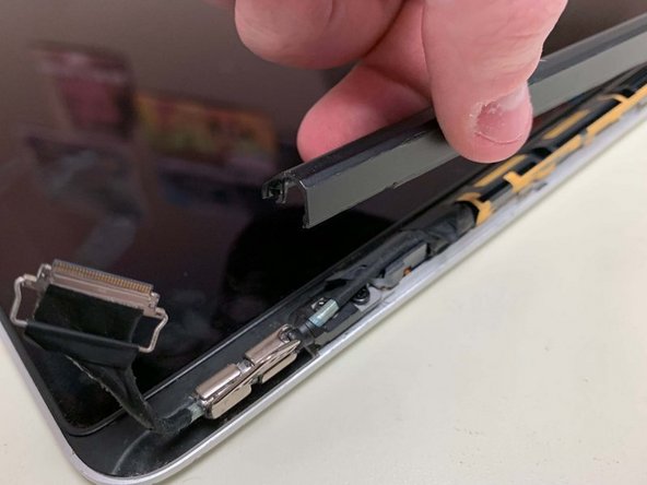

  20. MacBook Pro 15" Retina Display Mid 2012 LCD Cable Replacement: crwdns2935265:020crwdnd2935265:01crwdnd2935265:01crwdne2935265:0
    • Grasp the metal bar securing the LCD cable connector and rotate it toward the bottom edge of the display.
    • Pull the LCD cable straight out of its socket on the display.
    • Do not lift the display data cable, its connector is very delicate. Pull the cable parallel to the surface of the display.
