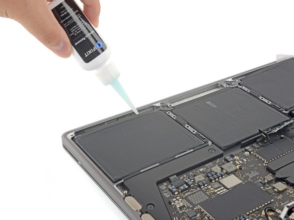

    • Apply a few drops of adhesive remover underneath the front edge of the battery cell that lies nearest the fan.
    • You don't need to use very much. The small bottle contains more than twice the amount of solvent needed to remove all the battery cells.
  28. MacBook Pro 13" Two Thunderbolt Ports Late 2020 Battery Replacement: crwdns2935265:028crwdnd2935265:01crwdnd2935265:01crwdne2935265:0
    • Tip the front edge of your MacBook Pro up at a slight angle so that the liquid adhesive remover flows underneath the battery cell.
    • Wait 2-3 minutes before you proceed to the next step, in order to give the adhesive remover time to work.

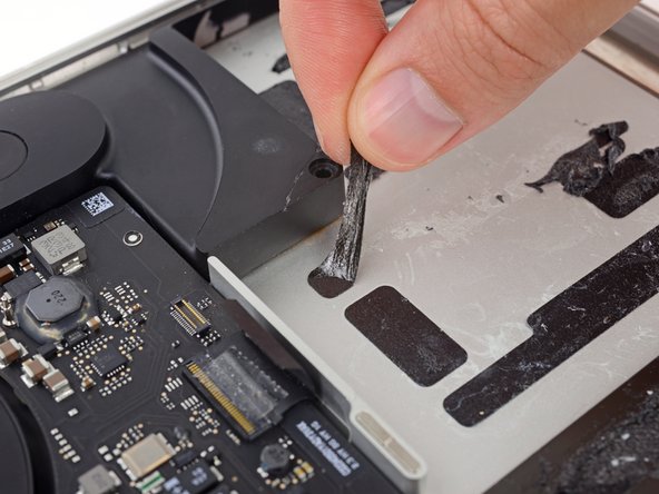

    • Gently work the card deeper under the battery cell to break up the adhesive securing it in place.
    • This should not require much force—the adhesive remover does most of the work. If you aren't able to get your card under the battery cell, apply a bit more adhesive remover as instructed above and wait 2-3 minutes before trying again.

    • Before installing your new battery, remove all the old adhesive from the MacBook Pro's case.
    • With a little luck, you can slowly pull out each strip of adhesive with your fingers.
    • Otherwise, soak each strip of adhesive with a bit of adhesive remover for 2-3 minutes, and then scrape it out with a plastic tool. This can take quite a bit of work, so be patient.
    • Mop up any remaining adhesive remover and give your MacBook Pro a few minutes to air dry.
    • The replacement battery included in your iFixit kit comes with adhesive pre-installed. Test the battery's fit and alignment carefully before peeling off the film covering the adhesive, and then press each cell firmly into place. If any additional films/liners are present that weren't on your original battery, remove them now.
