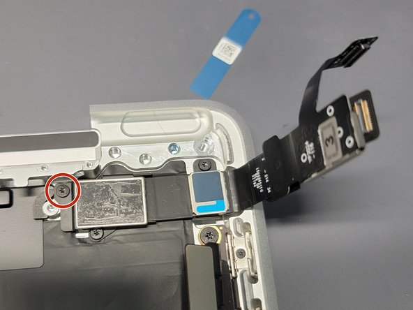

  27. MacBook Pro 13" Two Thunderbolt Ports 2020 Touchbar Replacement, Removing Trackpad Cable Bracket: crwdns2935265:027crwdnd2935265:01crwdnd2935265:03crwdne2935265:0 MacBook Pro 13" Two Thunderbolt Ports 2020 Touchbar Replacement, Removing Trackpad Cable Bracket: crwdns2935265:027crwdnd2935265:02crwdnd2935265:03crwdne2935265:0 MacBook Pro 13" Two Thunderbolt Ports 2020 Touchbar Replacement, Removing Trackpad Cable Bracket: crwdns2935265:027crwdnd2935265:03crwdnd2935265:03crwdne2935265:0
    $3.99
    • Locate the trackpad's flex cable bracket towards the middle of the Macbook
    • Remove 2x 1.9mm Torx T5 screws securing the bracket to the Macbook
    • Then take a pair of tweezers and remove the bracket
    • Make sure to grab and pickup ONLY the bracket.

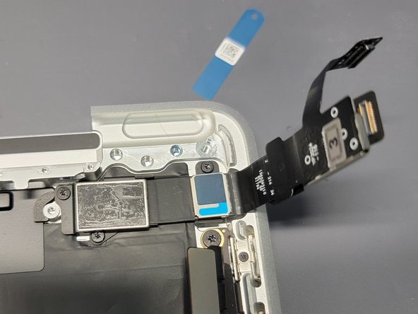

  29. MacBook Pro 13" Two Thunderbolt Ports 2020 Touchbar Replacement, Removing Right Speaker Flex Cable Bracket: crwdns2935265:029crwdnd2935265:01crwdnd2935265:03crwdne2935265:0 MacBook Pro 13" Two Thunderbolt Ports 2020 Touchbar Replacement, Removing Right Speaker Flex Cable Bracket: crwdns2935265:029crwdnd2935265:02crwdnd2935265:03crwdne2935265:0 MacBook Pro 13" Two Thunderbolt Ports 2020 Touchbar Replacement, Removing Right Speaker Flex Cable Bracket: crwdns2935265:029crwdnd2935265:03crwdnd2935265:03crwdne2935265:0
    $3.99
    • Locate the right speaker flex cable bracket
    • Remove 2x screws securing the bracket down to the Logic Board
    • 1x 3.7mm Torx T5
    • 1x 2.6mm Torx T5
    • Take a pair of tweezers and remove the bracket
    • Make sure to not grab the flex cable while removing the bracket

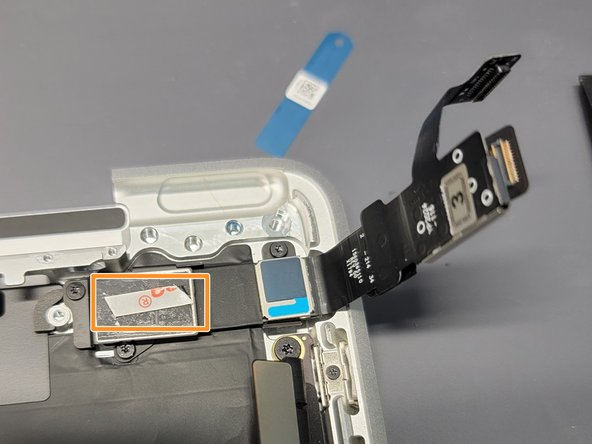

  30. MacBook Pro 13" Two Thunderbolt Ports 2020 Touchbar Replacement, Disconnecting Right Speaker From Logic Board: crwdns2935265:030crwdnd2935265:01crwdnd2935265:02crwdne2935265:0 MacBook Pro 13" Two Thunderbolt Ports 2020 Touchbar Replacement, Disconnecting Right Speaker From Logic Board: crwdns2935265:030crwdnd2935265:02crwdnd2935265:02crwdne2935265:0
    Spudger
    $3.99
    • Take the flat end of a spudger and carefully pry up the flex cable from its socket
    • Be careful not to pry up on the socket itself
    • There are sensitive filters near the socket. Make sure to be ultra careful not to knock one of those "microscopic" filters off.

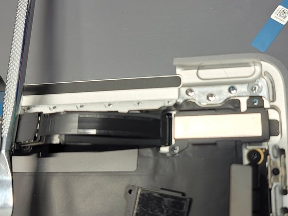

  31. MacBook Pro 13" Two Thunderbolt Ports 2020 Touchbar Replacement, Removing Left Speaker & Touch Bar Flex Cable Bracket: crwdns2935265:031crwdnd2935265:01crwdnd2935265:03crwdne2935265:0 MacBook Pro 13" Two Thunderbolt Ports 2020 Touchbar Replacement, Removing Left Speaker & Touch Bar Flex Cable Bracket: crwdns2935265:031crwdnd2935265:02crwdnd2935265:03crwdne2935265:0 MacBook Pro 13" Two Thunderbolt Ports 2020 Touchbar Replacement, Removing Left Speaker & Touch Bar Flex Cable Bracket: crwdns2935265:031crwdnd2935265:03crwdnd2935265:03crwdne2935265:0
    $3.99
    • Locate the left speaker and touch bar bracket
    • Remove 3x 1.4mm Torx T3 screws from the bracket
    • Be sure not to grab any of the flex cables while removing the bracket

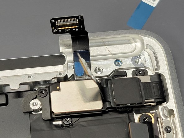

  36. MacBook Pro 13" Two Thunderbolt Ports 2020 Touchbar Replacement, Removing Touchbar Screws: crwdns2935265:036crwdnd2935265:01crwdnd2935265:03crwdne2935265:0 MacBook Pro 13" Two Thunderbolt Ports 2020 Touchbar Replacement, Removing Touchbar Screws: crwdns2935265:036crwdnd2935265:02crwdnd2935265:03crwdne2935265:0 MacBook Pro 13" Two Thunderbolt Ports 2020 Touchbar Replacement, Removing Touchbar Screws: crwdns2935265:036crwdnd2935265:03crwdnd2935265:03crwdne2935265:0
    $3.99
    • Locate the touchbar flex cable mess towards the top right of the Macbook
    • You will be removing a total of 3 screws to release this cabled mess from the frame
    • 2x 2.4mm
    • One of these are "hidden" by a small pad. Take a pair of tweezers and remove this pad to access the screw head
    • 1x 1.7mm
  37. MacBook Pro 13" Two Thunderbolt Ports 2020 Touchbar Replacement, Removing Touchbar Flex Cable Brackets: crwdns2935265:037crwdnd2935265:01crwdnd2935265:02crwdne2935265:0 MacBook Pro 13" Two Thunderbolt Ports 2020 Touchbar Replacement, Removing Touchbar Flex Cable Brackets: crwdns2935265:037crwdnd2935265:02crwdnd2935265:02crwdne2935265:0
    • These brackets that keep the cabled mess down and attached to the frame are adhered to the cabling
    • Remove these brackets from the flex cabling mess
    • TIP: Be mindful of how the brackets are positioned in relation to the cables and frame. Take pictures to reference. Without these brackets, the cables will be free inside the frame (which is not good).
    • There are also little wraps of plastic holding different parts of the cabling together. Go ahead and CAREFULLY remove these as we won't need them during reassembly and we do need them removed to completely remove the touchbar
    • Follow this guide to properly install the new touchbar

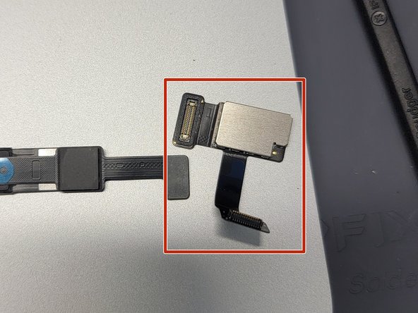

  41. MacBook Pro 13" Two Thunderbolt Ports 2020 Touchbar Replacement, Prepping Touchbar Flex Cable: crwdns2935265:041crwdnd2935265:01crwdnd2935265:02crwdne2935265:0 MacBook Pro 13" Two Thunderbolt Ports 2020 Touchbar Replacement, Prepping Touchbar Flex Cable: crwdns2935265:041crwdnd2935265:02crwdnd2935265:02crwdne2935265:0
    • Locate the cable side of the NEW touchbar
    • The touchbar is very sensitive and can break easily. Make sure to handle with care while maneuvering it around.
    • Locate the detachable end of the flex cable and use the flat-end of a spudger to disconnect the larger portion.
    • Be aware of how the end portion is oriented in relation to the smaller cable. When reattaching this part, it is important to place it correctly back into it's socket and not backwards.'''

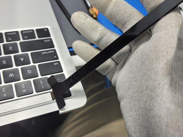

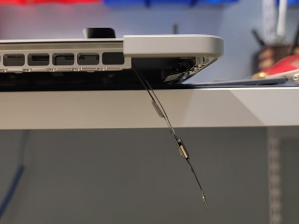

  42. MacBook Pro 13" Two Thunderbolt Ports 2020 Touchbar Replacement, Feeding Flex Cable: crwdns2935265:042crwdnd2935265:01crwdnd2935265:03crwdne2935265:0 MacBook Pro 13" Two Thunderbolt Ports 2020 Touchbar Replacement, Feeding Flex Cable: crwdns2935265:042crwdnd2935265:02crwdnd2935265:03crwdne2935265:0 MacBook Pro 13" Two Thunderbolt Ports 2020 Touchbar Replacement, Feeding Flex Cable: crwdns2935265:042crwdnd2935265:03crwdnd2935265:03crwdne2935265:0
    • Locate the little hole near the left side of the Macbook and feed the touchbar flex cables through it.
    • DON'T remove any plastic off the touchbar just yet. The adhesive attached to the touchbar is VERY strong and you will only have 1 chance to place the touchbar down correctly.

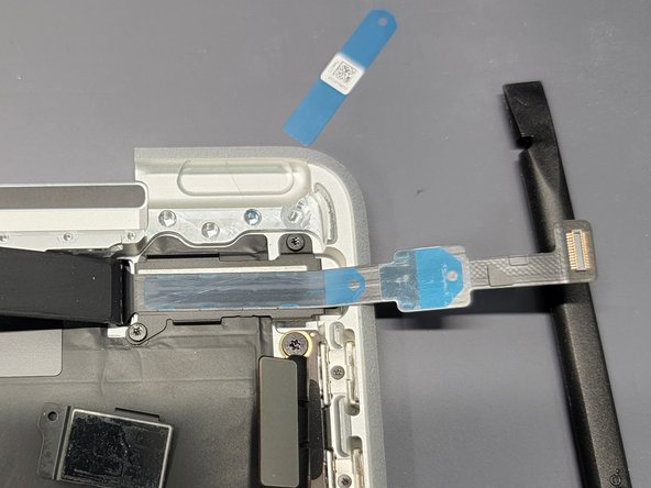

  45. MacBook Pro 13" Two Thunderbolt Ports 2020 Touchbar Replacement, Adhering The Two Flex Cables: crwdns2935265:045crwdnd2935265:01crwdnd2935265:02crwdne2935265:0 MacBook Pro 13" Two Thunderbolt Ports 2020 Touchbar Replacement, Adhering The Two Flex Cables: crwdns2935265:045crwdnd2935265:02crwdnd2935265:02crwdne2935265:0
    • Remove both blue adhesive protectors
    • Take touchbar LCD flex cable and place it against the touchbar digitizer flex cable
    • Press firmly on the flex cables to adhere the 2 together

    • Locate the second bracket and place it in it's correct spot. Reference the photos and step 36 for assistance.
    • Screw down the bracket using it's screw. Reference step 36.
    • Place a small strip of adhesive to the bracket. We used basic Tesa tape
  47. MacBook Pro 13" Two Thunderbolt Ports 2020 Touchbar Replacement, Adhering Flex Cables To Final Bracket: crwdns2935265:047crwdnd2935265:01crwdnd2935265:02crwdne2935265:0 MacBook Pro 13" Two Thunderbolt Ports 2020 Touchbar Replacement, Adhering Flex Cables To Final Bracket: crwdns2935265:047crwdnd2935265:02crwdnd2935265:02crwdne2935265:0
    • Remove the white protective top of the tesa tape
    • Remove the blue protective film on the flex cable
    • Take the flex cables and bring them down to the bracket
    • Press the flex cables firmly onto the bracket to adhere the flex cables to the new bracket

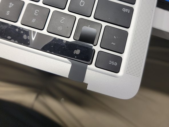

  48. MacBook Pro 13" Two Thunderbolt Ports 2020 Touchbar Replacement, Removing Touchbar Adhesive Protector: crwdns2935265:048crwdnd2935265:01crwdnd2935265:02crwdne2935265:0 MacBook Pro 13" Two Thunderbolt Ports 2020 Touchbar Replacement, Removing Touchbar Adhesive Protector: crwdns2935265:048crwdnd2935265:02crwdnd2935265:02crwdne2935265:0
    • Carefully lift the touchbar assembly up and out of it's little crevice
    • Remove the black adhesive protector from the touchbar
    • Carefully align the touchbar to it's crevice
    • Once perfectly aligned, place the touchbar into it's crevice and push firmly but not hard on the touchbar to finalize it.
    • You may only have one shot at aligning the touchbar properly once the adhesive touches the Macbook. So be careful, precise and don't rush it.
    • Once this is done, follow this guide backwards starting with Step 35 to reassemble the Macbook
