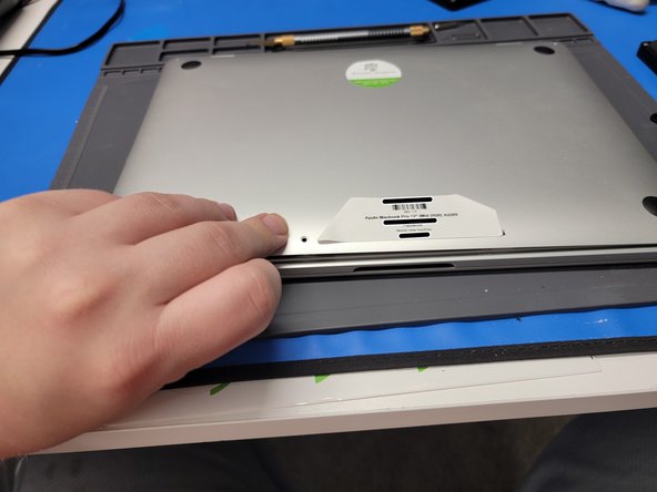

  1. MacBook Pro 13" Two Thunderbolt Ports 2020 Touchbar Removal, Remove Back Panel Screws: crwdns2935265:01crwdnd2935265:01crwdnd2935265:02crwdne2935265:0 MacBook Pro 13" Two Thunderbolt Ports 2020 Touchbar Removal, Remove Back Panel Screws: crwdns2935265:01crwdnd2935265:02crwdnd2935265:02crwdne2935265:0
    • To begin, we will need to remove 6 total screws
    • 2x 6.9mm Pentalobe P5
    • 2x 5.5mm Pentalobe P5
    • 2x 3.5mm Pentalobe P5

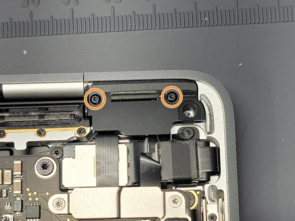

  11. MacBook Pro 13" Two Thunderbolt Ports 2020 Touchbar Removal, Removing Left Hinge Cover: crwdns2935265:011crwdnd2935265:01crwdnd2935265:03crwdne2935265:0 MacBook Pro 13" Two Thunderbolt Ports 2020 Touchbar Removal, Removing Left Hinge Cover: crwdns2935265:011crwdnd2935265:02crwdnd2935265:03crwdne2935265:0 MacBook Pro 13" Two Thunderbolt Ports 2020 Touchbar Removal, Removing Left Hinge Cover: crwdns2935265:011crwdnd2935265:03crwdnd2935265:03crwdne2935265:0
    $3.99
    • Locate the left hinge cover
    • Remove 2x 2mm Torx T3 screws securing the hinge cover to the Macbook
    • Take a pair of tweezers and remove the hinge cover

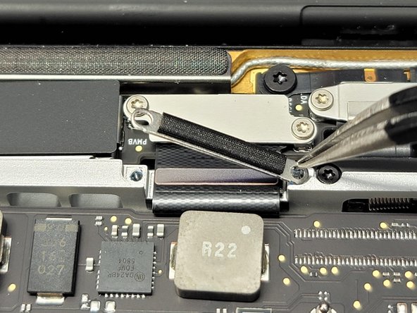

  13. MacBook Pro 13" Two Thunderbolt Ports 2020 Touchbar Removal, Removing LCD Flex Cable Brackets: crwdns2935265:013crwdnd2935265:01crwdnd2935265:03crwdne2935265:0 MacBook Pro 13" Two Thunderbolt Ports 2020 Touchbar Removal, Removing LCD Flex Cable Brackets: crwdns2935265:013crwdnd2935265:02crwdnd2935265:03crwdne2935265:0 MacBook Pro 13" Two Thunderbolt Ports 2020 Touchbar Removal, Removing LCD Flex Cable Brackets: crwdns2935265:013crwdnd2935265:03crwdnd2935265:03crwdne2935265:0
    $3.99
    • Locate your LCD flex cable towards the top of the Macbook
    • Locate the bottom cover plate
    • Remove 2x 3.2mm Torx T3 screws securing the bottom cover plate to the MacBook
    • Take a pair of tweezers and remove the brackets

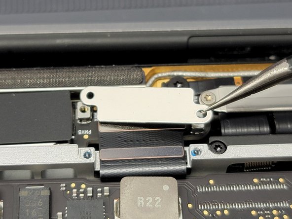

  14. MacBook Pro 13" Two Thunderbolt Ports 2020 Touchbar Removal, Removing LCD Flex Cable Cover Plates: crwdns2935265:014crwdnd2935265:01crwdnd2935265:02crwdne2935265:0 MacBook Pro 13" Two Thunderbolt Ports 2020 Touchbar Removal, Removing LCD Flex Cable Cover Plates: crwdns2935265:014crwdnd2935265:02crwdnd2935265:02crwdne2935265:0
    $3.99
    • Locate the top cover plate of the LCD flex cable
    • Remove 2x 1.8mm Torx T3 screws securing the top cover plate to the Macbook
    • Take a pair of tweezers and remove the now free cover plate

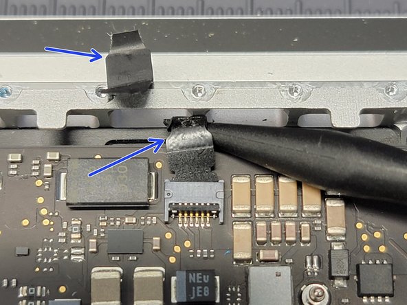

  15. MacBook Pro 13" Two Thunderbolt Ports 2020 Touchbar Removal, Disconnecting LCD Flex Cable: crwdns2935265:015crwdnd2935265:01crwdnd2935265:03crwdne2935265:0 MacBook Pro 13" Two Thunderbolt Ports 2020 Touchbar Removal, Disconnecting LCD Flex Cable: crwdns2935265:015crwdnd2935265:02crwdnd2935265:03crwdne2935265:0 MacBook Pro 13" Two Thunderbolt Ports 2020 Touchbar Removal, Disconnecting LCD Flex Cable: crwdns2935265:015crwdnd2935265:03crwdnd2935265:03crwdne2935265:0
    Spudger
    $3.99
    • Take the flat end of a spudger and gently pry up the LCD flex cable from its port
    • Make sure not to pry the socket itself
    • Lift LCD flex cable up and away from the Macbook

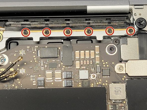

  16. MacBook Pro 13" Two Thunderbolt Ports 2020 Touchbar Removal, Removing Left LCD Spring Screws: crwdns2935265:016crwdnd2935265:01crwdnd2935265:02crwdne2935265:0 MacBook Pro 13" Two Thunderbolt Ports 2020 Touchbar Removal, Removing Left LCD Spring Screws: crwdns2935265:016crwdnd2935265:02crwdnd2935265:02crwdne2935265:0
    • Locate the left LCD screen spring
    • Remove 2x 4.1mm Torx T3 screws securing the spring to the MacBook
  17. MacBook Pro 13" Two Thunderbolt Ports 2020 Touchbar Removal, Removing Right LCD Spring Screws: crwdns2935265:017crwdnd2935265:01crwdnd2935265:02crwdne2935265:0 MacBook Pro 13" Two Thunderbolt Ports 2020 Touchbar Removal, Removing Right LCD Spring Screws: crwdns2935265:017crwdnd2935265:02crwdnd2935265:02crwdne2935265:0
    • Locate the right LCD screen spring

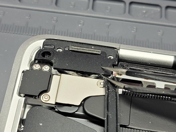

  18. MacBook Pro 13" Two Thunderbolt Ports 2020 Touchbar Removal, Disconnecting Antenna From Logic Board: crwdns2935265:018crwdnd2935265:01crwdnd2935265:03crwdne2935265:0 MacBook Pro 13" Two Thunderbolt Ports 2020 Touchbar Removal, Disconnecting Antenna From Logic Board: crwdns2935265:018crwdnd2935265:02crwdnd2935265:03crwdne2935265:0 MacBook Pro 13" Two Thunderbolt Ports 2020 Touchbar Removal, Disconnecting Antenna From Logic Board: crwdns2935265:018crwdnd2935265:03crwdnd2935265:03crwdne2935265:0
    $3.99
    • Locate antenna connector cover
    • Take a pair of tweezers and gently pry up the cover from the Logic Board
    • Be careful not to pry anything but the plastic cover
    • Remove 1x 3.9mm Torx T5 screw securing the antenna cables to the MacBook
    • Take the flat end of a spudger and gently pry up the antenna cables from their sockets
    • Be careful not to pry up the socket itself

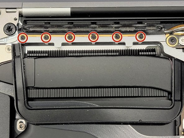

  19. MacBook Pro 13" Two Thunderbolt Ports 2020 Touchbar Removal, Removing Antenna Screws: crwdns2935265:019crwdnd2935265:01crwdnd2935265:03crwdne2935265:0 MacBook Pro 13" Two Thunderbolt Ports 2020 Touchbar Removal, Removing Antenna Screws: crwdns2935265:019crwdnd2935265:02crwdnd2935265:03crwdne2935265:0 MacBook Pro 13" Two Thunderbolt Ports 2020 Touchbar Removal, Removing Antenna Screws: crwdns2935265:019crwdnd2935265:03crwdnd2935265:03crwdne2935265:0
    • Locate the antenna towards the top of the Macbook
    • Remove 12x 1.2mm Pentalobe P2 screws securing the antenna to the MacBook

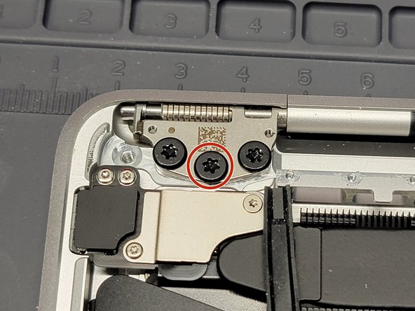

  22. MacBook Pro 13" Two Thunderbolt Ports 2020 Touchbar Removal, Removing Left Hinge Screws: crwdns2935265:022crwdnd2935265:01crwdnd2935265:02crwdne2935265:0 MacBook Pro 13" Two Thunderbolt Ports 2020 Touchbar Removal, Removing Left Hinge Screws: crwdns2935265:022crwdnd2935265:02crwdnd2935265:02crwdne2935265:0
    • Locate the left LCD screen hinge
    • Remove 2x 4.5mm Torx T9 screws that secure the hinge to the MacBook
    • Leave 1 screw to make removing the LCD screen easier
  23. MacBook Pro 13" Two Thunderbolt Ports 2020 Touchbar Removal, Removing Right Hinge Screws: crwdns2935265:023crwdnd2935265:01crwdnd2935265:02crwdne2935265:0 MacBook Pro 13" Two Thunderbolt Ports 2020 Touchbar Removal, Removing Right Hinge Screws: crwdns2935265:023crwdnd2935265:02crwdnd2935265:02crwdne2935265:0
    • Locate the right LCD screen hinge

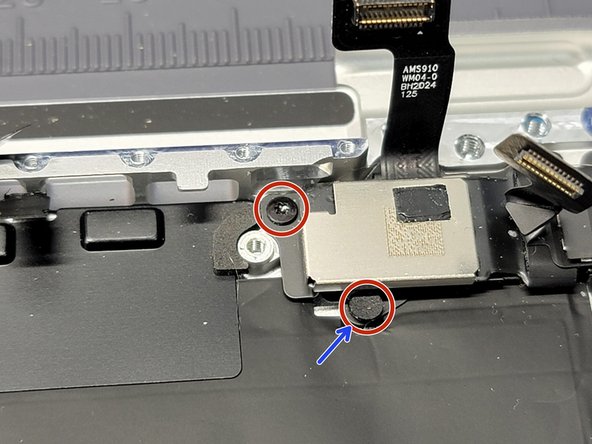

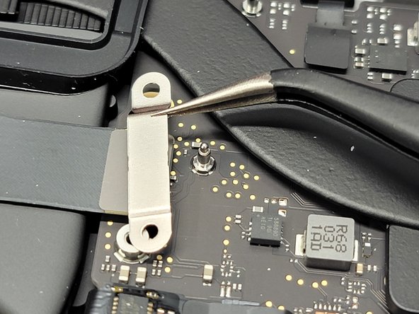

  26. MacBook Pro 13" Two Thunderbolt Ports 2020 Touchbar Removal, Removing Power Button Bracket: crwdns2935265:026crwdnd2935265:01crwdnd2935265:03crwdne2935265:0 MacBook Pro 13" Two Thunderbolt Ports 2020 Touchbar Removal, Removing Power Button Bracket: crwdns2935265:026crwdnd2935265:02crwdnd2935265:03crwdne2935265:0 MacBook Pro 13" Two Thunderbolt Ports 2020 Touchbar Removal, Removing Power Button Bracket: crwdns2935265:026crwdnd2935265:03crwdnd2935265:03crwdne2935265:0
    $3.99
    • Locate the power button flex cable bracket towards the top left of the MacBook
    • Remove 2x screws securing the bracket to the MacBook
    • 1x 5mm Torx T3 Screw
    • 1x 1.4mm Torx T3 Screw
    • During Reassembly: You may want to use this screw to screw in the logicboard standoff underneath.
    • Make sure to grab and pickup ONLY the bracket.

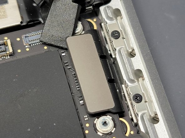

  29. MacBook Pro 13" Two Thunderbolt Ports 2020 Touchbar Removal, Removing Right Speaker Flex Cable Bracket: crwdns2935265:029crwdnd2935265:01crwdnd2935265:03crwdne2935265:0 MacBook Pro 13" Two Thunderbolt Ports 2020 Touchbar Removal, Removing Right Speaker Flex Cable Bracket: crwdns2935265:029crwdnd2935265:02crwdnd2935265:03crwdne2935265:0 MacBook Pro 13" Two Thunderbolt Ports 2020 Touchbar Removal, Removing Right Speaker Flex Cable Bracket: crwdns2935265:029crwdnd2935265:03crwdnd2935265:03crwdne2935265:0
    $3.99
    • Locate the right speaker flex cable bracket
    • Remove 2x screws securing the bracket down to the Logic Board
    • 1x 3.7mm Torx T5
    • 1x 2.6mm Torx T5
    • Make sure to not grab the flex cable while removing the bracket

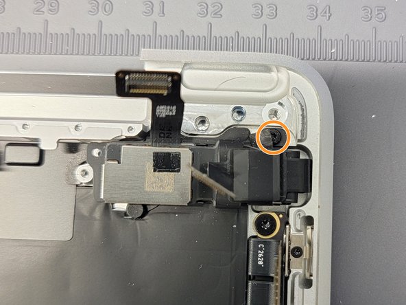

  30. MacBook Pro 13" Two Thunderbolt Ports 2020 Touchbar Removal, Disconnecting Right Speaker From Logic Board: crwdns2935265:030crwdnd2935265:01crwdnd2935265:02crwdne2935265:0 MacBook Pro 13" Two Thunderbolt Ports 2020 Touchbar Removal, Disconnecting Right Speaker From Logic Board: crwdns2935265:030crwdnd2935265:02crwdnd2935265:02crwdne2935265:0
    Spudger
    $3.99
    • Take the flat end of a spudger and carefully pry up the flex cable from its socket
    • Be careful not to pry up on the socket itself
    • There are sensitive filters near the socket. Make sure to be ultra careful not to knock one of those "microscopic" filters off.

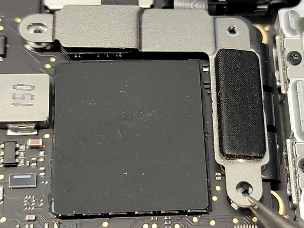

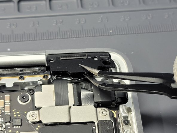

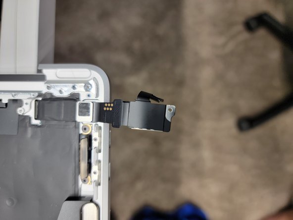

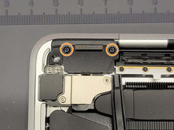

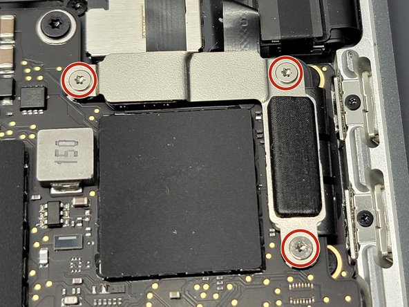

  31. MacBook Pro 13" Two Thunderbolt Ports 2020 Touchbar Removal, Removing Left Speaker & Touch Bar Flex Cable Bracket: crwdns2935265:031crwdnd2935265:01crwdnd2935265:03crwdne2935265:0 MacBook Pro 13" Two Thunderbolt Ports 2020 Touchbar Removal, Removing Left Speaker & Touch Bar Flex Cable Bracket: crwdns2935265:031crwdnd2935265:02crwdnd2935265:03crwdne2935265:0 MacBook Pro 13" Two Thunderbolt Ports 2020 Touchbar Removal, Removing Left Speaker & Touch Bar Flex Cable Bracket: crwdns2935265:031crwdnd2935265:03crwdnd2935265:03crwdne2935265:0
    $3.99
    • Locate the left speaker and touch bar bracket
    • Remove 3x 1.4mm Torx T3 screws from the bracket
    • Be sure not to grab any of the flex cables while removing the bracket

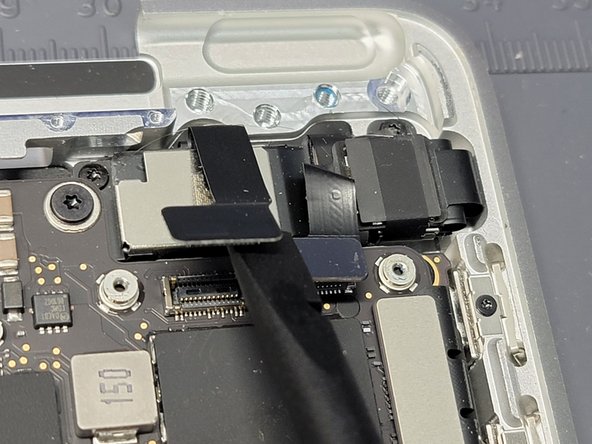

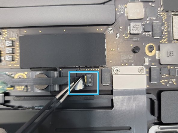

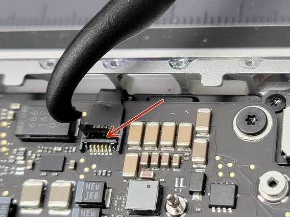

  32. MacBook Pro 13" Two Thunderbolt Ports 2020 Touchbar Removal, Disconnecting Flex Cables: crwdns2935265:032crwdnd2935265:01crwdnd2935265:03crwdne2935265:0 MacBook Pro 13" Two Thunderbolt Ports 2020 Touchbar Removal, Disconnecting Flex Cables: crwdns2935265:032crwdnd2935265:02crwdnd2935265:03crwdne2935265:0 MacBook Pro 13" Two Thunderbolt Ports 2020 Touchbar Removal, Disconnecting Flex Cables: crwdns2935265:032crwdnd2935265:03crwdnd2935265:03crwdne2935265:0
    Spudger
    $3.99
    • Take the flat-end of a spudger and gently pry up all 3 flex cables from their sockets
  33. MacBook Pro 13" Two Thunderbolt Ports 2020 Touchbar Removal, Disconnecting More Flex Cables: crwdns2935265:033crwdnd2935265:01crwdnd2935265:03crwdne2935265:0 MacBook Pro 13" Two Thunderbolt Ports 2020 Touchbar Removal, Disconnecting More Flex Cables: crwdns2935265:033crwdnd2935265:02crwdnd2935265:03crwdne2935265:0 MacBook Pro 13" Two Thunderbolt Ports 2020 Touchbar Removal, Disconnecting More Flex Cables: crwdns2935265:033crwdnd2935265:03crwdnd2935265:03crwdne2935265:0
    $3.99
    • Locate 8x flex cables connected the logic board
    • For each flex cable, pull up on their plastic flap with a pair of tweezers
    • Take the hook end of a Halberd Spudger and gently pry up the retaining flap on the ZIF socket of each cable
    • Make sure to use gentle force as this shouldn't require a lot of force. If excessive force is used, you could break the flex cable.
    • Take your tweezers and pull on the plastic cover to pull each cable away from the ZIF socket to remove the flex cable from it's socket
    • If any of the plastic flaps break off don't worry! You can use a combination of your spudger and tweezers to gently pull out the flex cable from it's respective socket
  34. MacBook Pro 13" Two Thunderbolt Ports 2020 Touchbar Removal, Removing Logic Board Screws: crwdns2935265:034crwdnd2935265:01crwdnd2935265:02crwdne2935265:0 MacBook Pro 13" Two Thunderbolt Ports 2020 Touchbar Removal, Removing Logic Board Screws: crwdns2935265:034crwdnd2935265:02crwdnd2935265:02crwdne2935265:0
    • Locate and remove 5x Logic Board Screws
    • 3x 3.4mm Torx T5 screws
    • 1x 3.6mm Torx T5 stepped screw
    • 1x 3.3mm hex standoff (3mm drive)
    • During Reassembly: It may be difficult to screw the top left logic board standoff back in. If you are finding it hard to do this, take the 1.4mm screw that we removed to remove the power button bracket and screw it into the top left logic board standoff. Afterwards, take the now "cyborg" screw and screw it into the logic board.
    • Don't forget to remove the 1.4mm screw from the logic board standoff during reassembly
  35. MacBook Pro 13" Two Thunderbolt Ports 2020 Touchbar Removal, Removing Logic Board From Macbook: crwdns2935265:035crwdnd2935265:01crwdnd2935265:01crwdne2935265:0
    Halberd Spudger
    $2.99
    • Take the hook end of your Halberd Spudger and gently pry up the top left corner of the logic board
    • Now remove the logic board from the Macbook
    • Be careful not to rip or tear any flex cables while removing or placing down the logic board
    • During reassembly, make sure to take your spudger while placing the logic board down and move any flex cable away from being squashed, tore, or ripped.
  36. MacBook Pro 13" Two Thunderbolt Ports 2020 Touchbar Removal, Removing Touchbar Screws: crwdns2935265:036crwdnd2935265:01crwdnd2935265:03crwdne2935265:0 MacBook Pro 13" Two Thunderbolt Ports 2020 Touchbar Removal, Removing Touchbar Screws: crwdns2935265:036crwdnd2935265:02crwdnd2935265:03crwdne2935265:0 MacBook Pro 13" Two Thunderbolt Ports 2020 Touchbar Removal, Removing Touchbar Screws: crwdns2935265:036crwdnd2935265:03crwdnd2935265:03crwdne2935265:0
    $3.99
    • Locate the touchbar flex cable mess towards the top right of the Macbook
    • You will be removing a total of 3 screws to release this cabled mess from the frame
    • 2x 2.4mm
    • One of these are "hidden" by a small pad. Take a pair of tweezers and remove this pad to access the screw head
    • 1x 1.7mm
  37. MacBook Pro 13" Two Thunderbolt Ports 2020 Touchbar Removal, Removing Touchbar Flex Cable Brackets: crwdns2935265:037crwdnd2935265:01crwdnd2935265:02crwdne2935265:0 MacBook Pro 13" Two Thunderbolt Ports 2020 Touchbar Removal, Removing Touchbar Flex Cable Brackets: crwdns2935265:037crwdnd2935265:02crwdnd2935265:02crwdne2935265:0
    • These brackets that keep the cabled mess down and attached to the frame are adhered to the cabling
    • Remove these brackets from the flex cabling mess
    • TIP: Be mindful of how the brackets are positioned in relation to the cables and frame. Take pictures to reference. Without these brackets, the cables will be free inside the frame (which is not good).
    • There are also little wraps of plastic holding different parts of the cabling together. Go ahead and CAREFULLY remove these as we won't need them during reassembly and we do need them removed to completely remove the touchbar
    • Follow this guide to properly install the new touchbar

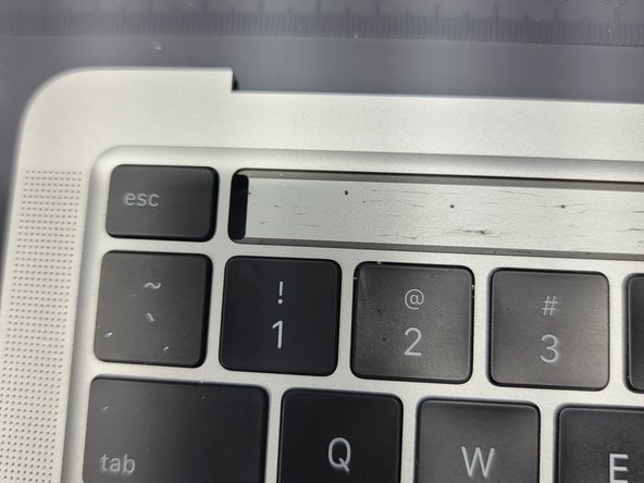

  38. MacBook Pro 13" Two Thunderbolt Ports 2020 Touchbar Removal, Methods of Removing The Actual Touchbar: crwdns2935265:038crwdnd2935265:01crwdnd2935265:01crwdne2935265:0
    iFixit Adhesive Remover
    $19.99
    • There are 2 methods that we can take towards removing this annoying touchbar. We went ahead and performed what we thing is the harder method.
    • Method 1: Take 2 tweezers or handles and wrap very thin wire around them. Then pull the wire underneath the touchbar LCD gently while being careful not to damage the keyboard
    • This method keeps the frame underneath the touchbar from scratching a whole bunch, eliminates the possibility of the keyboard keys "melting" from the Adhesive Remover, and allows you to possibly reuse the touchbar.
    • Method 2: What we did. Remove the touchbar digitizer first by prying it up and off the touchbar LCD. Then use a combination Adhesive Remover and a Technician's Razor Set to remove the touchbar LCD.
    • This method takes longer and more patience. However, we didn't have wire at our disposal and we weren't needing to reuse the touchbar
  39. MacBook Pro 13" Two Thunderbolt Ports 2020 Touchbar Removal, Our Method of Removing This Specific Touchbar: crwdns2935265:039crwdnd2935265:01crwdnd2935265:03crwdne2935265:0 MacBook Pro 13" Two Thunderbolt Ports 2020 Touchbar Removal, Our Method of Removing This Specific Touchbar: crwdns2935265:039crwdnd2935265:02crwdnd2935265:03crwdne2935265:0 MacBook Pro 13" Two Thunderbolt Ports 2020 Touchbar Removal, Our Method of Removing This Specific Touchbar: crwdns2935265:039crwdnd2935265:03crwdnd2935265:03crwdne2935265:0
    Halberd Spudger
    $2.99
    • Take a Halberd Spudger and insert the knife end right underneath the plastic of the digitizer
    • Run the Halberd Spudger along the edge of the touchbar digitizer
    • The digitizer should separate surprisingly easy.
    • Feed the Touchbar digitizer cable through the hole and remove the digitizer
  40. MacBook Pro 13" Two Thunderbolt Ports 2020 Touchbar Removal, Prying Up The LCD of The Touchbar: crwdns2935265:040crwdnd2935265:01crwdnd2935265:02crwdne2935265:0 MacBook Pro 13" Two Thunderbolt Ports 2020 Touchbar Removal, Prying Up The LCD of The Touchbar: crwdns2935265:040crwdnd2935265:02crwdnd2935265:02crwdne2935265:0
    $14.99
    • Take a technician's knife and start prying away the LCD of the touchbar.
    • Use adhesive remover from time to time to help loosen the adhesive
    • Don't let any of the adhesive remover touch the keyboard keys or any plastic for that matter. It will melt and eat away at any plastic it comes in-contact with
