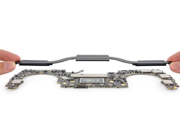

  8. MacBook Pro 13" Touch Bar Teardown: crwdns2935265:08crwdnd2935265:01crwdnd2935265:02crwdne2935265:0 MacBook Pro 13" Touch Bar Teardown: crwdns2935265:08crwdnd2935265:02crwdnd2935265:02crwdne2935265:0
    • We're ready to remove the rest of the peripherals. It'd be great to get a look at the battery, fans, heat sink, and speakers. Except we can't.
    • The symmetrical logic board keeps guard over the remaining components, so we spudger off its connecting cables and wrest it free from the case.
    • The heat sink is attached to the logic board with screws on the bottom. With the board out of the case, we're able to remove the heat sink for inspection—with a heat pipe running in each direction, it's got twice the pipe of the entry-level model.

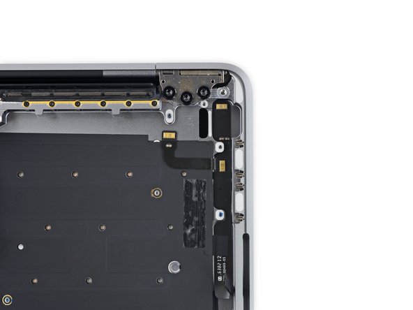

  16. MacBook Pro 13" Touch Bar Teardown: crwdns2935265:016crwdnd2935265:01crwdnd2935265:03crwdne2935265:0 MacBook Pro 13" Touch Bar Teardown: crwdns2935265:016crwdnd2935265:02crwdnd2935265:03crwdne2935265:0 MacBook Pro 13" Touch Bar Teardown: crwdns2935265:016crwdnd2935265:03crwdnd2935265:03crwdne2935265:0
    • Gently nestled between MacBook's edge and the keyboard are two speaker grilles—carefully crafted vents that channel sound waves out of the MacBook Pro straight to ... Wait.
    • The speakers are not located under the speaker grilles. The speaker grille doesn't even go clear through the case.
    • These speakers likely blast their impressive sound through the side air vents.
    • The "grilles" are seemingly cosmetic, maybe to unify the product line. Curiously, the Function Key edition also suffers from some fake holes, albeit different ones.
    • Teardown Update: Alright, most of these holes are cosmetic, but after yanking out the tweeters in the following step, it's clear that some of these are through-holes that carry sound out of the Mac's enclosure.

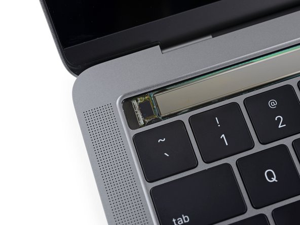

  20. MacBook Pro 13" Touch Bar Teardown: crwdns2935265:020crwdnd2935265:01crwdnd2935265:03crwdne2935265:0 MacBook Pro 13" Touch Bar Teardown: crwdns2935265:020crwdnd2935265:02crwdnd2935265:03crwdne2935265:0 MacBook Pro 13" Touch Bar Teardown: crwdns2935265:020crwdnd2935265:03crwdnd2935265:03crwdne2935265:0
    • Human touch needs to be processed by a brain. Touch Bar needs to be processed by a chip. With some surgery we find the Touch Bar brain:
    • Broadcom BCM5976TC1KUB60G touch controller
    • Removing the OLED strip is difficult enough, but our efforts will not be in vain! Maybe a little in vain. Okay, our efforts were crushed (along with our hopes and dreams). The Touch Bar is fragile.
    • To add to the fragile mystery that is the Touch Bar, we stumble across an unmarked chip. Given the location, it is likely a display driver of sorts.
    • After scraping out all that business we uncover a three-microphone array. What is the leftmost one even listening to? The fan? The keyboard? Who knows!
  21. MacBook Pro 13" Touch Bar Teardown: crwdns2935265:021crwdnd2935265:01crwdnd2935265:02crwdne2935265:0 MacBook Pro 13" Touch Bar Teardown: crwdns2935265:021crwdnd2935265:02crwdnd2935265:02crwdne2935265:0

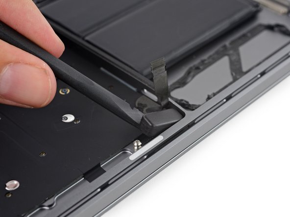

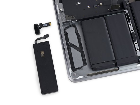

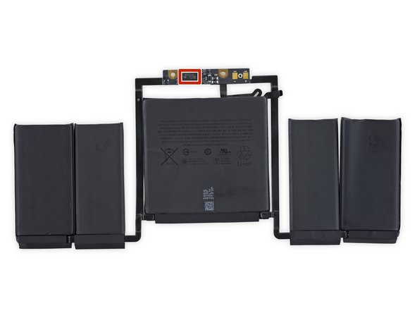

    • At last we carve out the (mightily adhered) 5-cell battery.
    • Well, five-ish cells. With a nominal voltage of 11.41 V, the two outer pairs are wired in parallel and together have the same charge capacity as the center one, to yield three ~3.8 V cells in series.
    • You'd better hope your "Pro" career is short; this battery replacement is a doozy.
    • The battery board hosts a TI BQ20Z451 (a possible variant of the BQ20Z45-R1 line, seen in MacBook Pros forever)
    • Listing a 49.2 Wh capacity, this battery seems a little piddly compared to the Function Key edition's 54.5 Wh—especially considering it's driving a lot more functionality (pun intended).
    • Dotting our i's, we slap these batteries on a scale: the Function Key-equipped MacBook Pro battery weighed in at 235 grams, while this battery weighs just 197 grams.
    • The weight disparity probably helps account for a lighter Touch Bar edition, but the battery seems to rate more watt-hours than the decrease in weight would suggest.

    • The trackpad can be removed without first removing the battery.
    • Proprietary pentalobe screws continue to make working on the device unnecessarily difficult.
    • The battery assembly is entirely, and very solidly, glued into the case, thus complicating replacement.
    • The processor, RAM, and flash memory are soldered to the logic board.
    • The Touch Bar adds a second, difficult to replace, screen to damage.
    • The Touch ID sensor doubles as the power switch, and is paired with the T1 chip on the logic board. Fixing a broken power switch may require help from Apple, or a new logic board.
