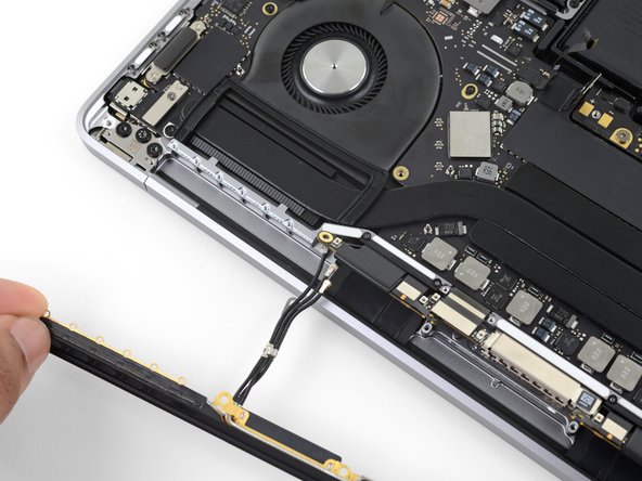

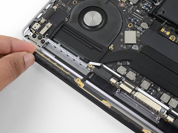

  24. MacBook Pro 13" Touch Bar 2018 Screen Replacement, Pry up the antenna cable assembly: crwdns2935265:024crwdnd2935265:01crwdnd2935265:03crwdne2935265:0 MacBook Pro 13" Touch Bar 2018 Screen Replacement, Pry up the antenna cable assembly: crwdns2935265:024crwdnd2935265:02crwdnd2935265:03crwdne2935265:0 MacBook Pro 13" Touch Bar 2018 Screen Replacement, Pry up the antenna cable assembly: crwdns2935265:024crwdnd2935265:03crwdnd2935265:03crwdne2935265:0
    • Use an opening pick to lever out the antenna cable assembly in the areas shown.
    • Don't slide the opening pick from side to side, as there are two display cables that could be damaged in the way.
  25. MacBook Pro 13" Touch Bar 2018 Screen Replacement, Remove the antenna assembly: crwdns2935265:025crwdnd2935265:01crwdnd2935265:03crwdne2935265:0 MacBook Pro 13" Touch Bar 2018 Screen Replacement, Remove the antenna assembly: crwdns2935265:025crwdnd2935265:02crwdnd2935265:03crwdne2935265:0 MacBook Pro 13" Touch Bar 2018 Screen Replacement, Remove the antenna assembly: crwdns2935265:025crwdnd2935265:03crwdnd2935265:03crwdne2935265:0
    • Carefully remove the antenna assembly, while simultaneously feeding the antenna cable bundle out from underneath the heat pipe.

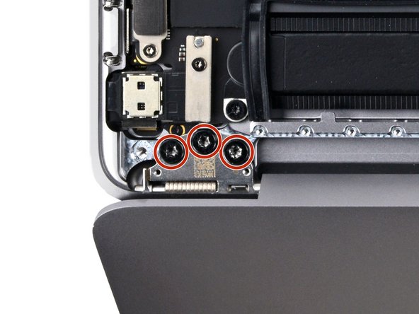

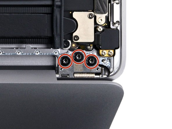

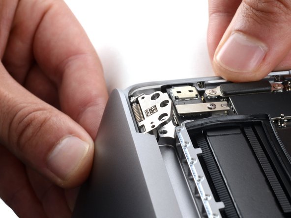

  30. MacBook Pro 13" Touch Bar 2018 Screen Replacement, Remove the hinge screws: crwdns2935265:030crwdnd2935265:01crwdnd2935265:03crwdne2935265:0 MacBook Pro 13" Touch Bar 2018 Screen Replacement, Remove the hinge screws: crwdns2935265:030crwdnd2935265:02crwdnd2935265:03crwdne2935265:0 MacBook Pro 13" Touch Bar 2018 Screen Replacement, Remove the hinge screws: crwdns2935265:030crwdnd2935265:03crwdnd2935265:03crwdne2935265:0
    • Support the screen with one hand and use your free hand to remove the six T8 Torx screws securing the hinges.
    • Keep a firm grip on your laptop, as it can easily fall off the table.

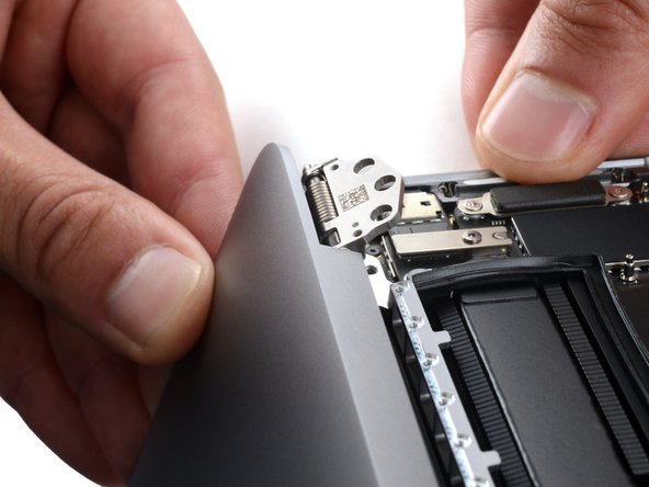

  31. MacBook Pro 13" Touch Bar 2018 Screen Replacement, Free the left hinge: crwdns2935265:031crwdnd2935265:01crwdnd2935265:03crwdne2935265:0 MacBook Pro 13" Touch Bar 2018 Screen Replacement, Free the left hinge: crwdns2935265:031crwdnd2935265:02crwdnd2935265:03crwdne2935265:0 MacBook Pro 13" Touch Bar 2018 Screen Replacement, Free the left hinge: crwdns2935265:031crwdnd2935265:03crwdnd2935265:03crwdne2935265:0
    • Keep the screen supported constantly during the next two steps.
    • Firmly secure the main body of your MacBook with one hand.
    • With your free hand, push the left side of the screen up and towards the bottom of your laptop to free the left hinge.
    • Be very careful not to damage the Touch Bar connector when moving the left hinge. It can be easily crushed, resulting in an inoperable Touch Bar.

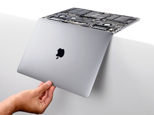

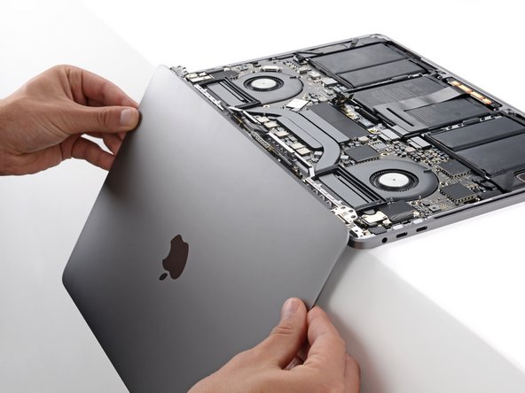

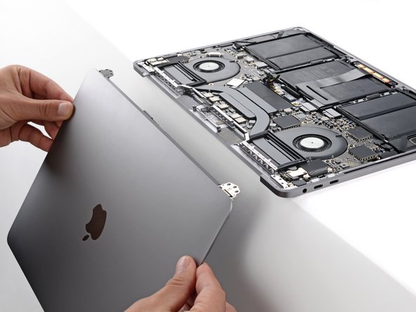

  32. MacBook Pro 13" Touch Bar 2018 Screen Replacement, Remove the screen: crwdns2935265:032crwdnd2935265:01crwdnd2935265:03crwdne2935265:0 MacBook Pro 13" Touch Bar 2018 Screen Replacement, Remove the screen: crwdns2935265:032crwdnd2935265:02crwdnd2935265:03crwdne2935265:0 MacBook Pro 13" Touch Bar 2018 Screen Replacement, Remove the screen: crwdns2935265:032crwdnd2935265:03crwdnd2935265:03crwdne2935265:0
    • Free the right hinge and remove the screen.
    • During reassembly:
    • Make sure the screen hinges are fully open and guide them into their recesses in the frame.
    • Be very careful not to damage the Touch Bar connector when inserting the left hinge.
    • Partially tighten the six hinge screws.
    • Close your laptop and make sure the screen is properly aligned. If it clicks or snaps, readjust the alignment.
    • Fully tighten the hinge screws.
