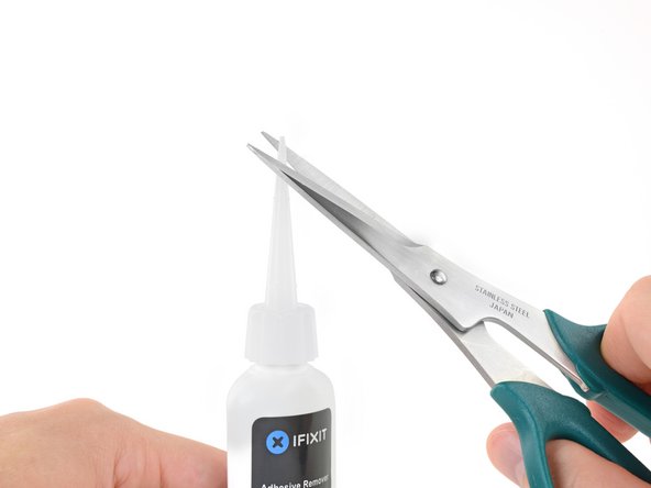

  26. MacBook Pro 13" Retina Display Early 2013 Battery Replacement: crwdns2935265:026crwdnd2935265:01crwdnd2935265:03crwdne2935265:0 MacBook Pro 13" Retina Display Early 2013 Battery Replacement: crwdns2935265:026crwdnd2935265:02crwdnd2935265:03crwdne2935265:0 MacBook Pro 13" Retina Display Early 2013 Battery Replacement: crwdns2935265:026crwdnd2935265:03crwdnd2935265:03crwdne2935265:0
    • Pull off the black rubber stopper from your bottle of adhesive remover.
    • Twist to loosen or remove the bottle cap before you cut the applicator tip.
    • This unseals the bottle and allows the pressure to equalize before you cut the applicator tip. If you skip this step, the adhesive remover may spray out unexpectedly when the tip is cut.
    • Use scissors to cut off the sealed tip of the applicator.
    • Cutting close to the narrow tip will give you better control so you can apply the adhesive remover in small amounts.
    • Twist and close the bottle cap securely before you proceed further.

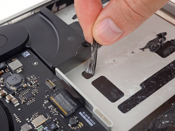

  34. MacBook Pro 13" Retina Display Early 2013 Battery Replacement: crwdns2935265:034crwdnd2935265:01crwdnd2935265:03crwdne2935265:0 MacBook Pro 13" Retina Display Early 2013 Battery Replacement: crwdns2935265:034crwdnd2935265:02crwdnd2935265:03crwdne2935265:0 MacBook Pro 13" Retina Display Early 2013 Battery Replacement: crwdns2935265:034crwdnd2935265:03crwdnd2935265:03crwdne2935265:0
    • Lift the battery as a whole up out of the upper case, and remove the battery.
    • Before installing a new battery, remove all the old adhesive from the MacBook Pro's case.
    • With a little luck, you can slowly pull out each strip of adhesive with your fingers.
    • Otherwise, soak each section of adhesive with a bit of adhesive remover for 2-3 minutes, and then scrape it out with an opening pick or one of the other tools in your kit. This can take quite a bit of work, so be patient.
    • Mop up any remaining adhesive remover and give your MacBook Pro a few minutes to air dry.

Thanks for this guide, I had a faulty battery and replacement by apple would be 400 euro. Now I did it myself with a replica battery for 80 euro.
Tip on prying loose the battery at step 24 and on: Use an old credit card. That worked very well for me.
roelofk - crwdns2934203:0crwdne2934203:0
Old Credit card works very well on Step 24. Excellent guide.
