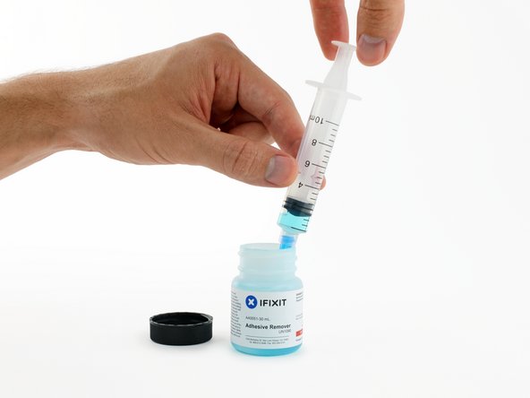

  26. MacBook Pro 13" Retina Display Early 2013 Battery Replacement (Legacy): crwdns2935265:026crwdnd2935265:01crwdnd2935265:02crwdne2935265:0 MacBook Pro 13" Retina Display Early 2013 Battery Replacement (Legacy): crwdns2935265:026crwdnd2935265:02crwdnd2935265:02crwdne2935265:0
    • Open your container of adhesive remover.
    • Fill the syringe included in your kit with a small amount (approximately 1-2 milliliters) of adhesive remover.
    • It's best to fill the syringe with no more than about 1-2 milliliters of adhesive remover at a time, so as to avoid accidentally applying too much.
    • Refill your syringe as needed throughout the rest of this procedure.
