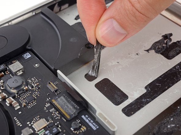

    5. MacBook Pro 13" Function Keys 2017 Battery Replacement: crwdns2935265:020crwdnd2935265:01crwdnd2935265:03crwdne2935265:0 MacBook Pro 13" Function Keys 2017 Battery Replacement: crwdns2935265:020crwdnd2935265:02crwdnd2935265:03crwdne2935265:0 MacBook Pro 13" Function Keys 2017 Battery Replacement: crwdns2935265:020crwdnd2935265:03crwdnd2935265:03crwdne2935265:0
      • Carefully peel the trackpad ribbon cable up off the battery, and push it out of the way.
      • Do not fold or tear the cable.

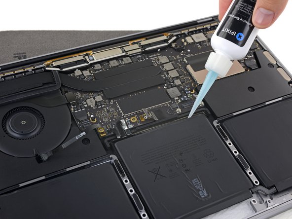

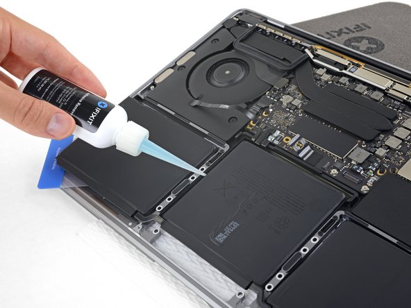

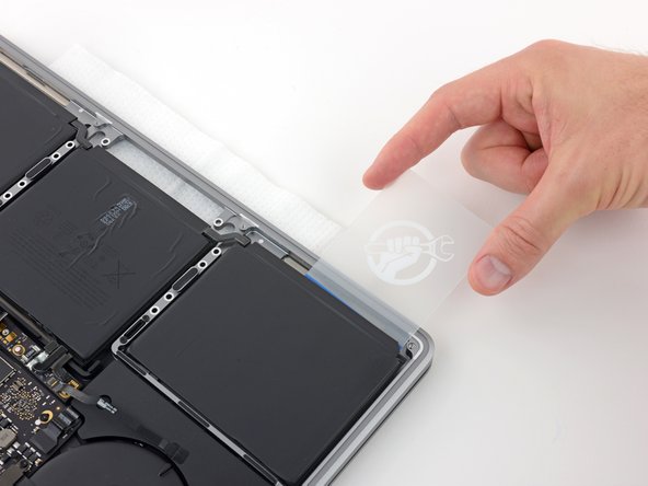

    6. MacBook Pro 13" Function Keys 2017 Battery Replacement: crwdns2935265:028crwdnd2935265:01crwdnd2935265:02crwdne2935265:0 MacBook Pro 13" Function Keys 2017 Battery Replacement: crwdns2935265:028crwdnd2935265:02crwdnd2935265:02crwdne2935265:0
      • Apply a few drops of adhesive remover underneath the front edge of the battery cell that lies nearest the fan.
      • You don't need to use very much. The small bottle contains more than twice the amount of solvent needed to remove all the battery cells.
    7. MacBook Pro 13" Function Keys 2017 Battery Replacement: crwdns2935265:029crwdnd2935265:01crwdnd2935265:01crwdne2935265:0
      • Tip the front edge of your MacBook Pro up at a slight angle so that the liquid adhesive remover flows underneath the battery cell.
      • Wait 2-3 minutes before you proceed to the next step, in order to give the adhesive remover time to work.

      • After 2-3 minutes have passed, slide a plastic card under the edge of the battery cell where you applied the adhesive remover.
      • It may help to gently twist the card to open up a slight gap between the battery cell and the MacBook Pro's case.

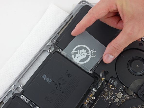

    9. MacBook Pro 13" Function Keys 2017 Battery Replacement: crwdns2935265:031crwdnd2935265:01crwdnd2935265:02crwdne2935265:0 MacBook Pro 13" Function Keys 2017 Battery Replacement: crwdns2935265:031crwdnd2935265:02crwdnd2935265:02crwdne2935265:0
      • Gently work the card deeper under the battery cell to break up the adhesive securing it in place.
      • This should not require much force—the adhesive remover does most of the work. If you aren't able to get your card under the battery cell, apply a bit more adhesive remover as instructed above and wait 2-3 minutes before trying again.

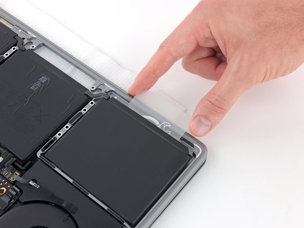

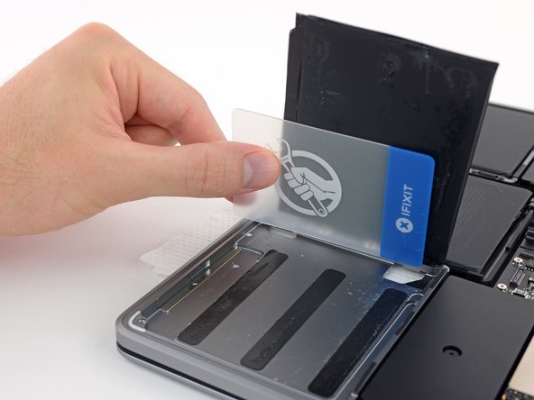

    10. MacBook Pro 13" Function Keys 2017 Battery Replacement: crwdns2935265:032crwdnd2935265:01crwdnd2935265:02crwdne2935265:0 MacBook Pro 13" Function Keys 2017 Battery Replacement: crwdns2935265:032crwdnd2935265:02crwdnd2935265:02crwdne2935265:0
      • Twist the card to raise the battery cell until it fully separates from the aluminum case.
      • Don't try to remove the battery cell completely just yet—it's still attached to the remaining cells.
    11. MacBook Pro 13" Function Keys 2017 Battery Replacement: crwdns2935265:033crwdnd2935265:01crwdnd2935265:01crwdne2935265:0
      • Leave the plastic card temporarily in place underneath the battery cell.
      • This prevents the cell from re-adhering to the case while you work on separating the remaining cells.
    12. MacBook Pro 13" Function Keys 2017 Battery Replacement: crwdns2935265:034crwdnd2935265:01crwdnd2935265:03crwdne2935265:0 MacBook Pro 13" Function Keys 2017 Battery Replacement: crwdns2935265:034crwdnd2935265:02crwdnd2935265:03crwdne2935265:0 MacBook Pro 13" Function Keys 2017 Battery Replacement: crwdns2935265:034crwdnd2935265:03crwdnd2935265:03crwdne2935265:0
      • Repeat the previous six steps to separate the other outer battery cell, on the opposite side.

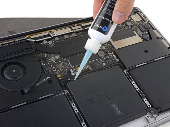

      • To separate the center battery cell, first raise the back edge of the MacBook Pro and prop it up on a foam block or book, so that the adhesive remover will flow away from the logic board.
      • Apply a few drops of adhesive remover along the back edge of the battery cell.

    15. MacBook Pro 13" Function Keys 2017 Battery Replacement: crwdns2935265:037crwdnd2935265:01crwdnd2935265:02crwdne2935265:0 MacBook Pro 13" Function Keys 2017 Battery Replacement: crwdns2935265:037crwdnd2935265:02crwdnd2935265:02crwdne2935265:0
      • Slide a plastic card under one of the side edges of the center battery cell.
      • Try to keep your card well clear of the logic board.
    16. MacBook Pro 13" Function Keys 2017 Battery Replacement: crwdns2935265:038crwdnd2935265:01crwdnd2935265:01crwdne2935265:0
      • Use the card to lift the battery cell until it fully separates from the aluminum case.
    17. MacBook Pro 13" Function Keys 2017 Battery Replacement: crwdns2935265:039crwdnd2935265:01crwdnd2935265:02crwdne2935265:0 MacBook Pro 13" Function Keys 2017 Battery Replacement: crwdns2935265:039crwdnd2935265:02crwdnd2935265:02crwdne2935265:0
      • Lift and remove the battery.
      • Before installing your new battery, remove all the old adhesive from the MacBook Pro's case.
      • With a little luck, you can slowly pull out each strip of adhesive with your fingers.
      • Otherwise, soak each strip of adhesive with a bit of adhesive remover for 2-3 minutes, and then scrape it out with a plastic tool. This can take quite a bit of work, so be patient.
      • Mop up any remaining adhesive remover and give your MacBook Pro a few minutes to air dry.
      • The replacement battery included in your iFixit kit comes with adhesive pre-installed. Test the battery's fit and alignment carefully before peeling off the film covering the adhesive, and then press each cell firmly into place. If any additional films/liners are present that weren't on your original battery, remove them now.
      • Calibrate your newly installed battery: charge it to 100%, and keep charging it for at least 2 more hours. Unplug and use it normally to drain the battery. When you see the low battery warning, save your work, and keep your laptop on until it goes to sleep due to low battery. Wait at least 5 hours, then charge your laptop uninterrupted to 100%.
      • If you notice any unusual behavior or problems after installing your new battery, you may need to reset your MacBook Pro's SMC.
