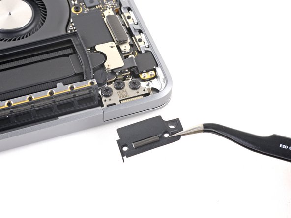

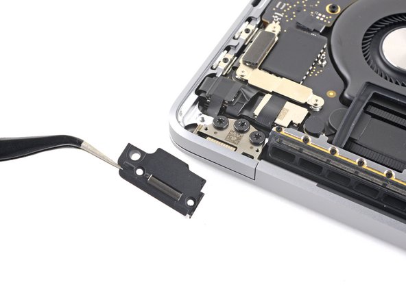

  19. MacBook Pro 13" Four Thunderbolt Ports 2020 Screen Replacement, Unscrew the antenna cable assembly: crwdns2935265:019crwdnd2935265:01crwdnd2935265:03crwdne2935265:0 MacBook Pro 13" Four Thunderbolt Ports 2020 Screen Replacement, Unscrew the antenna cable assembly: crwdns2935265:019crwdnd2935265:02crwdnd2935265:03crwdne2935265:0 MacBook Pro 13" Four Thunderbolt Ports 2020 Screen Replacement, Unscrew the antenna cable assembly: crwdns2935265:019crwdnd2935265:03crwdnd2935265:03crwdne2935265:0
    • Remove the four 1.5 mm T3 Torx screws securing the two aluminum covers on top of the two display board cables.
    • Use a pair of tweezers to remove the two aluminium covers.
