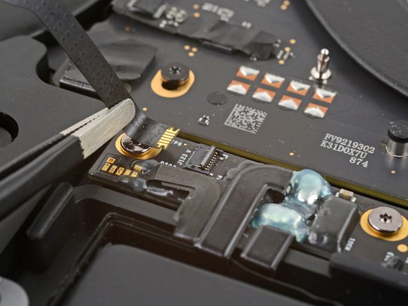

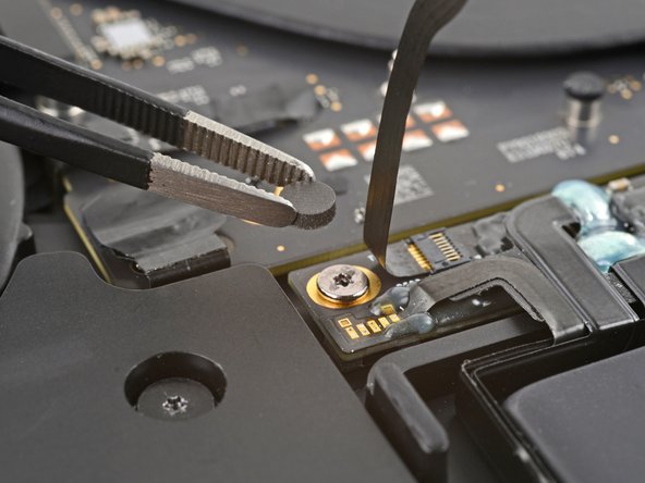

    2. MacBook Pro 13" 2022 (M2) Battery Replacement, Disconnect the battery data cable: crwdns2935265:010crwdnd2935265:01crwdnd2935265:02crwdne2935265:0 MacBook Pro 13" 2022 (M2) Battery Replacement, Disconnect the battery data cable: crwdns2935265:010crwdnd2935265:02crwdnd2935265:02crwdne2935265:0
      • Use blunt nose tweezers to gently peel back the pull tab covering the battery data connector.
      • Don't remove or tear the pull tab, as it's attached to the head of the connector.

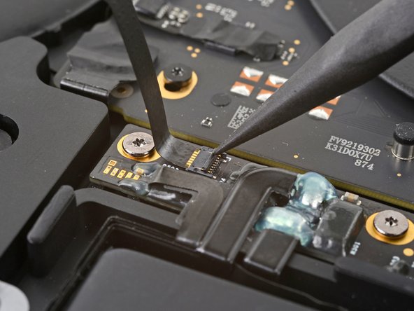

    3. MacBook Pro 13" 2022 (M2) Battery Replacement: crwdns2935265:011crwdnd2935265:01crwdnd2935265:02crwdne2935265:0 MacBook Pro 13" 2022 (M2) Battery Replacement: crwdns2935265:011crwdnd2935265:02crwdnd2935265:02crwdne2935265:0
      • Use the point of a spudger to flip up the small locking tab securing the battery data connector.
      • Locking tabs on ZIF connectors are fragile—be gentle with your spudger.
    4. MacBook Pro 13" 2022 (M2) Battery Replacement: crwdns2935265:012crwdnd2935265:01crwdnd2935265:03crwdne2935265:0 MacBook Pro 13" 2022 (M2) Battery Replacement: crwdns2935265:012crwdnd2935265:02crwdnd2935265:03crwdne2935265:0 MacBook Pro 13" 2022 (M2) Battery Replacement: crwdns2935265:012crwdnd2935265:03crwdnd2935265:03crwdne2935265:0
      • Use blunt nose tweezers or your fingers to grab the battery data cable pull tab and slide it straight out of its socket.
      • Move the cable to the left, out of the way of the battery board.
      • Don't strain the cable, as it's still attached to the battery board.

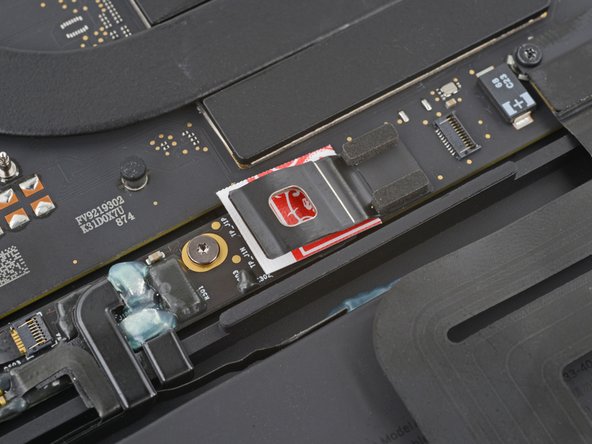

    5. MacBook Pro 13" 2022 (M2) Battery Replacement, Unfasten the battery connector: crwdns2935265:013crwdnd2935265:01crwdnd2935265:01crwdne2935265:0
      • Use a T5 Torx driver to remove the 3.7 mm screw securing the battery connector.
    6. MacBook Pro 13" 2022 (M2) Battery Replacement, Disconnect the battery: crwdns2935265:014crwdnd2935265:01crwdnd2935265:03crwdne2935265:0 MacBook Pro 13" 2022 (M2) Battery Replacement, Disconnect the battery: crwdns2935265:014crwdnd2935265:02crwdnd2935265:03crwdne2935265:0 MacBook Pro 13" 2022 (M2) Battery Replacement, Disconnect the battery: crwdns2935265:014crwdnd2935265:03crwdnd2935265:03crwdne2935265:0
      • Use the flat end of your spudger to slightly lift the battery connector away from the battery board.
      • Lifting the connector too high will break it. Angle it enough so it won't accidentally contact the battery board during repair.
      • Optionally, you may insert a barrier, such as a piece of a playing card, between the connector and the board during the repair.

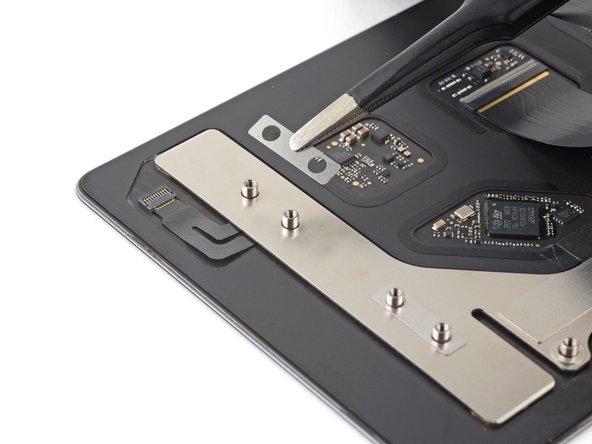

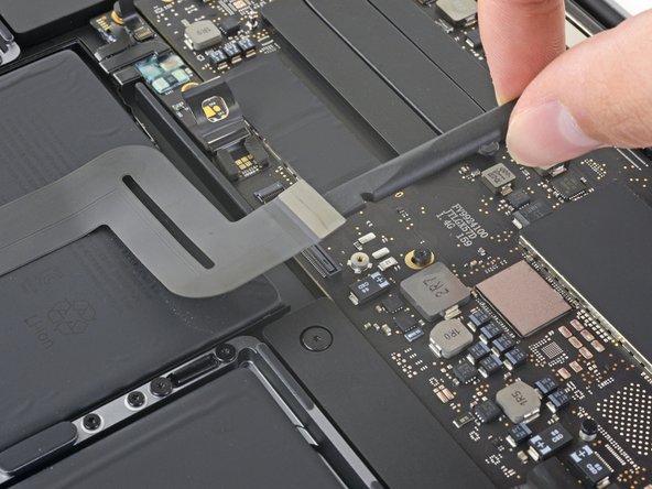

    1. MacBook Pro 13" 2022 (M2) Battery Replacement, Remove the trackpad cable bracket: crwdns2935265:015crwdnd2935265:01crwdnd2935265:02crwdne2935265:0 MacBook Pro 13" 2022 (M2) Battery Replacement, Remove the trackpad cable bracket: crwdns2935265:015crwdnd2935265:02crwdnd2935265:02crwdne2935265:0
      • Use your T5 Torx driver to remove the two 1.9 mm screws securing the trackpad cable bracket.
      • Remove the bracket.

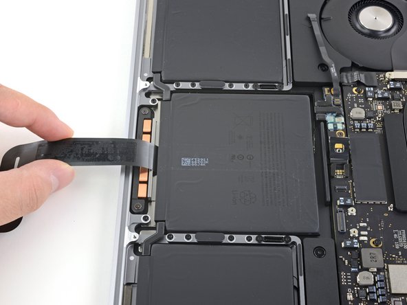

    2. MacBook Pro 13" 2022 (M2) Battery Replacement, Disconnect the trackpad: crwdns2935265:016crwdnd2935265:01crwdnd2935265:02crwdne2935265:0 MacBook Pro 13" 2022 (M2) Battery Replacement, Disconnect the trackpad: crwdns2935265:016crwdnd2935265:02crwdnd2935265:02crwdne2935265:0
      • Use the flat end of your spudger to pry up and disconnect the trackpad cable from the logic board.
    3. MacBook Pro 13" 2022 (M2) Battery Replacement, Heat the trackpad cable: crwdns2935265:017crwdnd2935265:01crwdnd2935265:01crwdne2935265:0
    4. MacBook Pro 13" 2022 (M2) Battery Replacement, Reposition the trackpad cable: crwdns2935265:018crwdnd2935265:01crwdnd2935265:03crwdne2935265:0 MacBook Pro 13" 2022 (M2) Battery Replacement, Reposition the trackpad cable: crwdns2935265:018crwdnd2935265:02crwdnd2935265:03crwdne2935265:0 MacBook Pro 13" 2022 (M2) Battery Replacement, Reposition the trackpad cable: crwdns2935265:018crwdnd2935265:03crwdnd2935265:03crwdne2935265:0
      • Use your fingers to peel the trackpad cable from the battery.
      • Fold the cable over the front edge of the MacBook.
      • Don't strain the cable, as it's still connected to the trackpad.

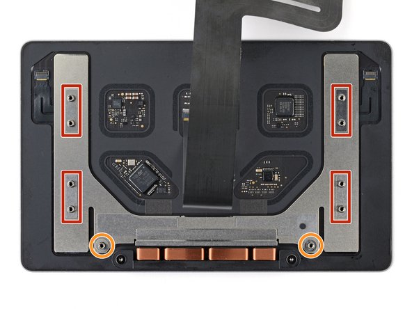

    5. MacBook Pro 13" 2022 (M2) Battery Replacement, Unfasten the trackpad: crwdns2935265:019crwdnd2935265:01crwdnd2935265:01crwdne2935265:0
      • Use your T5 Torx driver to remove the ten screws securing the trackpad:
      • Two 4.3 mm screws
      • Eight 5.8 mm screws

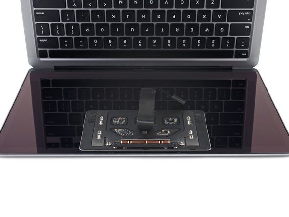

    6. MacBook Pro 13" 2022 (M2) Battery Replacement, Remove the trackpad: crwdns2935265:020crwdnd2935265:01crwdnd2935265:03crwdne2935265:0 MacBook Pro 13" 2022 (M2) Battery Replacement, Remove the trackpad: crwdns2935265:020crwdnd2935265:02crwdnd2935265:03crwdne2935265:0 MacBook Pro 13" 2022 (M2) Battery Replacement, Remove the trackpad: crwdns2935265:020crwdnd2935265:03crwdnd2935265:03crwdne2935265:0
      • Open your MacBook by lifting the body away from the display and trackpad.
      • Feed the trackpad cable through its cutout in the frame.
      • Before reinstalling the trackpad, thread the trackpad cable through the narrower of two slots at the base of the frame.
    7. MacBook Pro 13" 2022 (M2) Battery Replacement: crwdns2935265:021crwdnd2935265:01crwdnd2935265:03crwdne2935265:0 MacBook Pro 13" 2022 (M2) Battery Replacement: crwdns2935265:021crwdnd2935265:02crwdnd2935265:03crwdne2935265:0 MacBook Pro 13" 2022 (M2) Battery Replacement: crwdns2935265:021crwdnd2935265:03crwdnd2935265:03crwdne2935265:0
      • Remove the trackpad from the display.

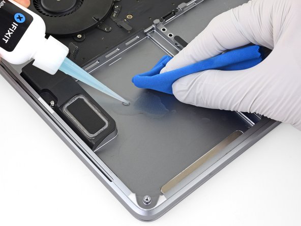

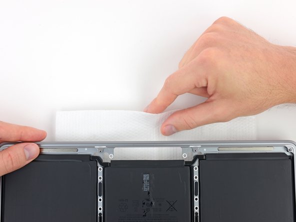

    5. MacBook Pro 13" 2022 (M2) Battery Replacement, Protect the display: crwdns2935265:026crwdnd2935265:01crwdnd2935265:02crwdne2935265:0 MacBook Pro 13" 2022 (M2) Battery Replacement, Protect the display: crwdns2935265:026crwdnd2935265:02crwdnd2935265:02crwdne2935265:0
      • Liquid adhesive remover may damage the antireflective coating on your MacBook's display.
      • Open your MacBook's lid and place a sheet of aluminum foil between the display and keyboard. Leave it in place while you remove the battery.
      • Place an absorbent towel under the trackpad's recess to soak up any excess adhesive remover.
      • Close the lid and continue disassembly.

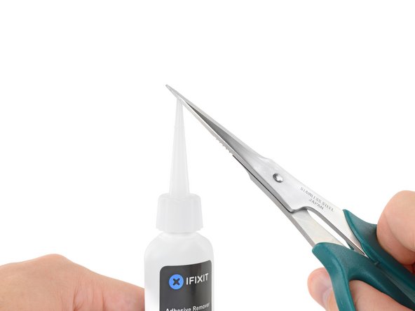

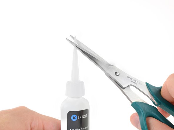

    7. MacBook Pro 13" 2022 (M2) Battery Replacement, Prepare the adhesive remover: crwdns2935265:028crwdnd2935265:01crwdnd2935265:03crwdne2935265:0 MacBook Pro 13" 2022 (M2) Battery Replacement, Prepare the adhesive remover: crwdns2935265:028crwdnd2935265:02crwdnd2935265:03crwdne2935265:0 MacBook Pro 13" 2022 (M2) Battery Replacement, Prepare the adhesive remover: crwdns2935265:028crwdnd2935265:03crwdnd2935265:03crwdne2935265:0
      • Pull off the black rubber stopper from your bottle of adhesive remover.
      • Twist to loosen or remove the bottle cap before you cut the applicator tip.
      • This unseals the bottle and allows the pressure to equalize before you cut the applicator tip. If you skip this step, the adhesive remover may spray out unexpectedly when the tip is cut.
      • Use scissors to cut off the sealed tip of the applicator.
      • Cutting close to the narrow tip will give you better control so you can apply the adhesive remover in small amounts.
      • Twist and close the bottle cap securely before you proceed.

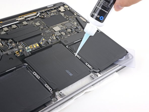

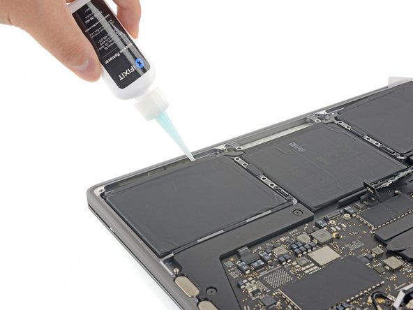

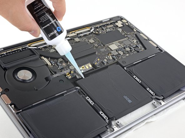

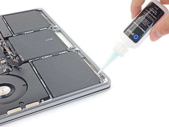

    8. MacBook Pro 13" 2022 (M2) Battery Replacement, Soften the adhesive: crwdns2935265:029crwdnd2935265:01crwdnd2935265:02crwdne2935265:0 MacBook Pro 13" 2022 (M2) Battery Replacement, Soften the adhesive: crwdns2935265:029crwdnd2935265:02crwdnd2935265:02crwdne2935265:0
      • Apply a few drops of adhesive remover under the front edge of the left battery cell.
    9. MacBook Pro 13" 2022 (M2) Battery Replacement: crwdns2935265:030crwdnd2935265:01crwdnd2935265:01crwdne2935265:0
      • Tilt the front edge of your MacBook up to allow the adhesive remover to flow underneath the battery cell.
      • Wait two minutes for the adhesive to soften.

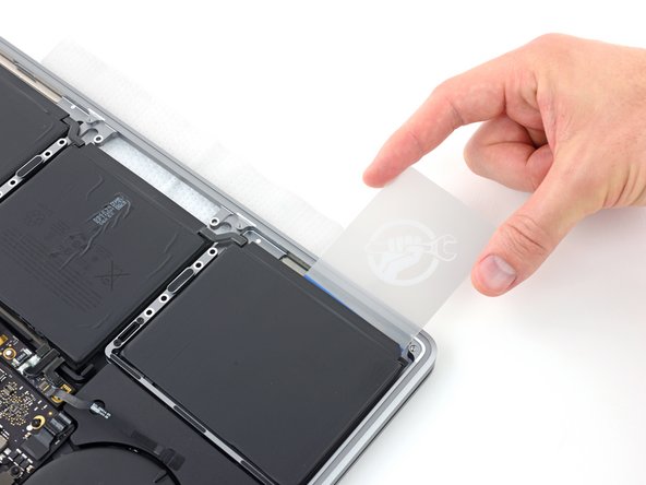

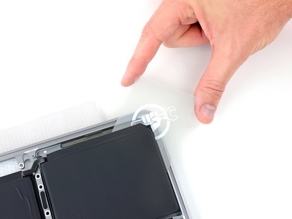

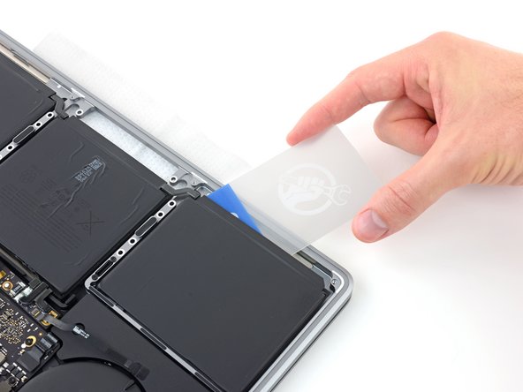

    10. MacBook Pro 13" 2022 (M2) Battery Replacement, Insert a plastic card: crwdns2935265:031crwdnd2935265:01crwdnd2935265:03crwdne2935265:0 MacBook Pro 13" 2022 (M2) Battery Replacement, Insert a plastic card: crwdns2935265:031crwdnd2935265:02crwdnd2935265:03crwdne2935265:0 MacBook Pro 13" 2022 (M2) Battery Replacement, Insert a plastic card: crwdns2935265:031crwdnd2935265:03crwdnd2935265:03crwdne2935265:0
      Plastic Cards
      $2.99
      • Slide a plastic card under the front edge of the left battery cell.
      • If you can't insert your card, gently twist it to help create a gap.

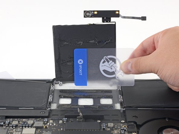

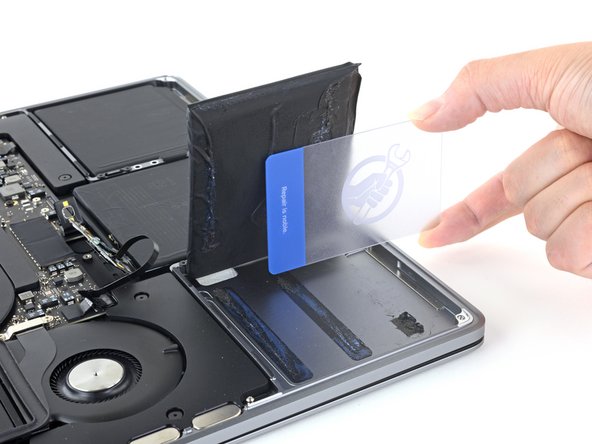

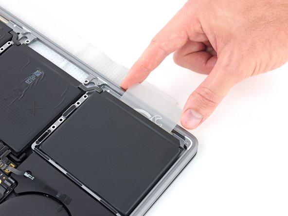

    11. MacBook Pro 13" 2022 (M2) Battery Replacement, Separate the left battery cell: crwdns2935265:032crwdnd2935265:01crwdnd2935265:02crwdne2935265:0 MacBook Pro 13" 2022 (M2) Battery Replacement, Separate the left battery cell: crwdns2935265:032crwdnd2935265:02crwdnd2935265:02crwdne2935265:0
      • Slide your plastic card deeper under the battery cell to separate its adhesive.
      • Don't force the card under the battery. If it feels stuck, apply a few more drops of adhesive remover and try again.
    12. MacBook Pro 13" 2022 (M2) Battery Replacement: crwdns2935265:033crwdnd2935265:01crwdnd2935265:03crwdne2935265:0 MacBook Pro 13" 2022 (M2) Battery Replacement: crwdns2935265:033crwdnd2935265:02crwdnd2935265:03crwdne2935265:0 MacBook Pro 13" 2022 (M2) Battery Replacement: crwdns2935265:033crwdnd2935265:03crwdnd2935265:03crwdne2935265:0
      • Twist your plastic card to lift the battery cell from the frame.
      • Don't try to remove the cell yet, as it's still attached to the other cells.
      • Leave your card in place to prevent the cell from readhering while you separate the other cells.

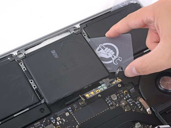

    13. MacBook Pro 13" 2022 (M2) Battery Replacement, Separate the right battery cell: crwdns2935265:034crwdnd2935265:01crwdnd2935265:03crwdne2935265:0 MacBook Pro 13" 2022 (M2) Battery Replacement, Separate the right battery cell: crwdns2935265:034crwdnd2935265:02crwdnd2935265:03crwdne2935265:0 MacBook Pro 13" 2022 (M2) Battery Replacement, Separate the right battery cell: crwdns2935265:034crwdnd2935265:03crwdnd2935265:03crwdne2935265:0
      • Separate the right battery cell with your adhesive remover and plastic card, just as you did for the left cell.

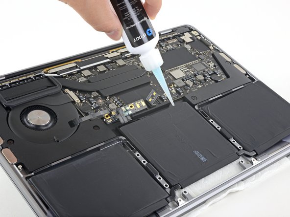

    14. MacBook Pro 13" 2022 (M2) Battery Replacement, Soften the adhesive: crwdns2935265:035crwdnd2935265:01crwdnd2935265:03crwdne2935265:0 MacBook Pro 13" 2022 (M2) Battery Replacement, Soften the adhesive: crwdns2935265:035crwdnd2935265:02crwdnd2935265:03crwdne2935265:0 MacBook Pro 13" 2022 (M2) Battery Replacement, Soften the adhesive: crwdns2935265:035crwdnd2935265:03crwdnd2935265:03crwdne2935265:0
      • Prop up the back edge of your MacBook with a book or similarly-sized object so your adhesive remover flows away from the logic board and under the middle battery cell.
      • Apply a few drops of adhesive remover to the inside edge of the middle battery cell.
    15. MacBook Pro 13" 2022 (M2) Battery Replacement: crwdns2935265:036crwdnd2935265:01crwdnd2935265:02crwdne2935265:0 MacBook Pro 13" 2022 (M2) Battery Replacement: crwdns2935265:036crwdnd2935265:02crwdnd2935265:02crwdne2935265:0
      • Cutouts in the frame between the battery and trackpad may prevent the adhesive remover from flowing completely underneath the battery.
      • Apply a few drops of adhesive remover to the sides of the middle battery cell to soften the remaining adhesive.

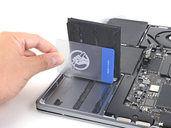

    16. MacBook Pro 13" 2022 (M2) Battery Replacement, Separate the middle battery cell: crwdns2935265:037crwdnd2935265:01crwdnd2935265:03crwdne2935265:0 MacBook Pro 13" 2022 (M2) Battery Replacement, Separate the middle battery cell: crwdns2935265:037crwdnd2935265:02crwdnd2935265:03crwdne2935265:0 MacBook Pro 13" 2022 (M2) Battery Replacement, Separate the middle battery cell: crwdns2935265:037crwdnd2935265:03crwdnd2935265:03crwdne2935265:0
      • Slide one of your plastic cards under either side of the middle battery cell.
      • Avoid sliding your card near the battery board or logic board.
      • Use your card to separate the battery cell from the frame.
    17. MacBook Pro 13" 2022 (M2) Battery Replacement, Remove the battery: crwdns2935265:038crwdnd2935265:01crwdnd2935265:03crwdne2935265:0 MacBook Pro 13" 2022 (M2) Battery Replacement, Remove the battery: crwdns2935265:038crwdnd2935265:02crwdnd2935265:03crwdne2935265:0 MacBook Pro 13" 2022 (M2) Battery Replacement, Remove the battery: crwdns2935265:038crwdnd2935265:03crwdnd2935265:03crwdne2935265:0
      • Lift and remove the battery.

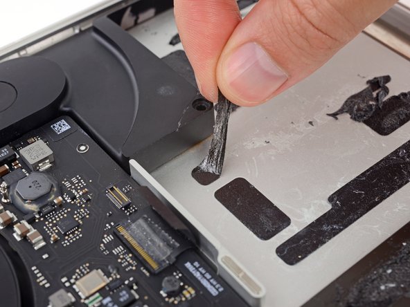

      • Use your fingers to pull off large pieces of adhesive.
      • Soak any remaining pieces with adhesive remover and scrape them away with your spudger. Clean any residual adhesive remover.
      • Before removing any adhesive liners, place the new battery into the frame to make sure it fits.
      • Remove all adhesive liners and firmly press each cell into place.
