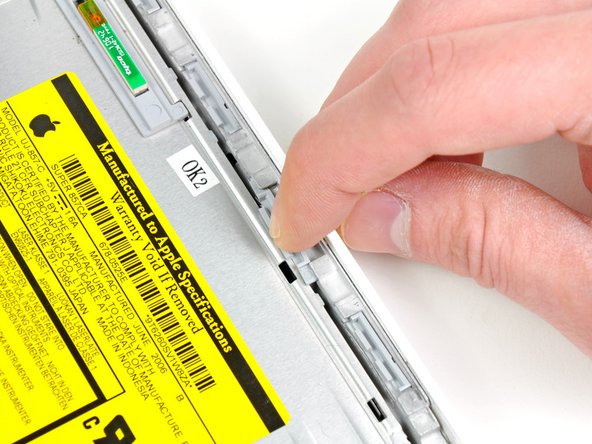

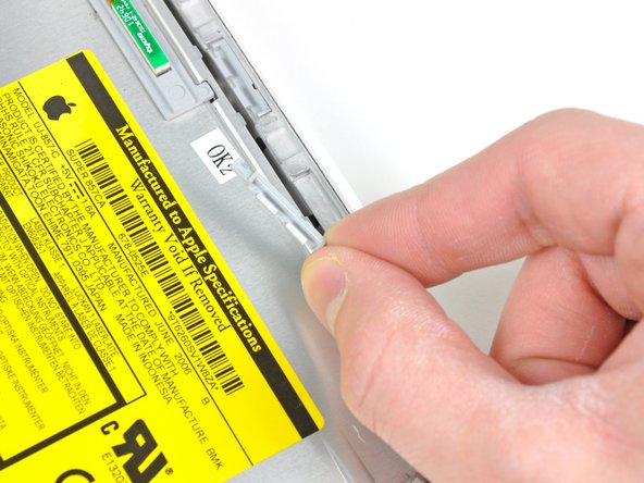

    1. MacBook Core Duo Upper Case Clips Replacement, Upper Case Clips: crwdns2935265:013crwdnd2935265:01crwdnd2935265:03crwdne2935265:0 MacBook Core Duo Upper Case Clips Replacement, Upper Case Clips: crwdns2935265:013crwdnd2935265:02crwdnd2935265:03crwdne2935265:0 MacBook Core Duo Upper Case Clips Replacement, Upper Case Clips: crwdns2935265:013crwdnd2935265:03crwdnd2935265:03crwdne2935265:0
      • The clips are captive to the lower case on Santa Rosa MacBooks and later and are thus not replaceable on these models.
      • The four plastic upper case clips are installed in the aluminum framework above the optical drive opening.
      • To remove the clips, simply slide them out of the aluminum framework away from the side of the lower case.
