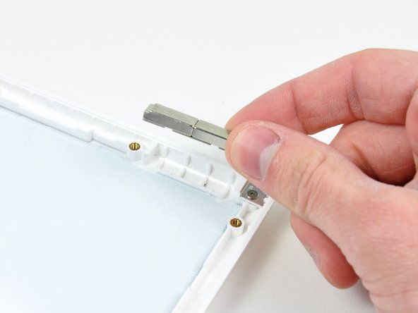

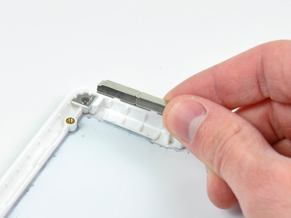

  40. MacBook Core Duo Rear Display Bezel Replacement, Clutch Cover: crwdns2935265:041crwdnd2935265:01crwdnd2935265:01crwdne2935265:0
    • Remove the three 4.2 mm Phillips screws securing the clutch cover.
  41. MacBook Core Duo Rear Display Bezel Replacement: crwdns2935265:042crwdnd2935265:01crwdnd2935265:01crwdne2935265:0

  60. MacBook Core Duo Rear Display Bezel Replacement: crwdns2935265:061crwdnd2935265:01crwdnd2935265:02crwdne2935265:0 MacBook Core Duo Rear Display Bezel Replacement: crwdns2935265:061crwdnd2935265:02crwdnd2935265:02crwdne2935265:0
    • Pry the right display latch magnet out of its housing. It may help to lift up on the magnet while prying it out.
    • Remove the right display latch magnet.
  61. MacBook Core Duo Rear Display Bezel Replacement: crwdns2935265:062crwdnd2935265:01crwdnd2935265:02crwdne2935265:0 MacBook Core Duo Rear Display Bezel Replacement: crwdns2935265:062crwdnd2935265:02crwdnd2935265:02crwdne2935265:0
    • Pry the left display latch magnet out of its housing.
    • Rear display bezel remains.
