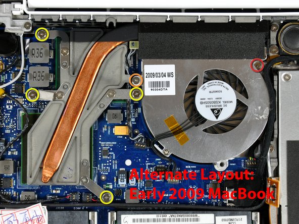

  22. MacBook Core 2 Duo PRAM Battery Replacement: crwdns2935265:022crwdnd2935265:01crwdnd2935265:02crwdne2935265:0 MacBook Core 2 Duo PRAM Battery Replacement: crwdns2935265:022crwdnd2935265:02crwdnd2935265:02crwdne2935265:0
    • Remove the following 6 screws:
    • One 3 mm Phillips on the right side of the fan.
    • One 6 mm Phillips on the left side of the fan.
    • Four 9 mm Phillips securing the heat sink to the lower case.
  23. MacBook Core 2 Duo PRAM Battery Replacement: crwdns2935265:023crwdnd2935265:01crwdnd2935265:01crwdne2935265:0
    • Hold the heat sink with one hand and the fan with your other hand, and lift the heat sink and fan assembly out of the computer. The fan is attached to the heat sink only with a strip of black felt tape, so be sure to remove both parts as a unit.
    • If you need to mount the heat sink back into the laptop, we have a thermal paste guide that makes replacing the thermal compound easy.
