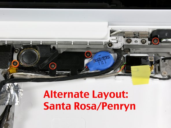

  24. MacBook Core 2 Duo PRAM Battery (Santa Rosa/Penryn) Replacement, Right Speaker: crwdns2935265:024crwdnd2935265:01crwdnd2935265:02crwdne2935265:0 MacBook Core 2 Duo PRAM Battery (Santa Rosa/Penryn) Replacement, Right Speaker: crwdns2935265:024crwdnd2935265:02crwdnd2935265:02crwdne2935265:0
    • Remove the following 4 Phillips screws:
    • Three 3 mm Phillips securing the subwoofer and right speaker to the lower case.
    • One 7.5 mm Phillips securing the loop in the display data cable to the lower case.
    • If you have a MacBook Core 2 Duo Santa Rosa/Penryn, the screws are in a different location.

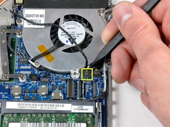

    • Use a spudger to disconnect the right speaker connector from the logic board.
  29. MacBook Core 2 Duo PRAM Battery (Santa Rosa/Penryn) Replacement, PRAM Battery (Santa Rosa/Penryn): crwdns2935265:029crwdnd2935265:01crwdnd2935265:02crwdne2935265:0 MacBook Core 2 Duo PRAM Battery (Santa Rosa/Penryn) Replacement, PRAM Battery (Santa Rosa/Penryn): crwdns2935265:029crwdnd2935265:02crwdnd2935265:02crwdne2935265:0
    • Use a spudger to remove the PRAM battery up from its location on the lower case.
    • Disconnect the PRAM battery cable from the logic board and remove the PRAM battery from the computer.
