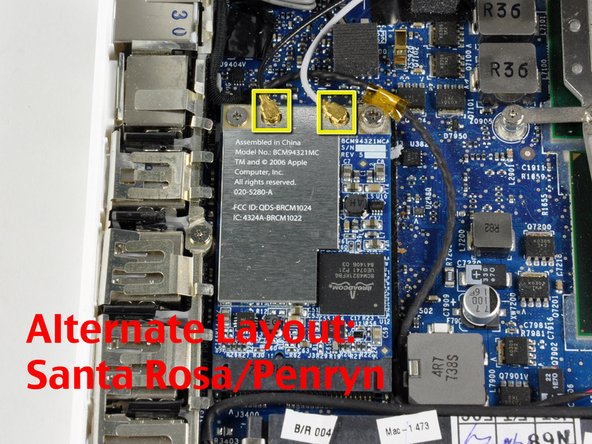

    1. MacBook Core 2 Duo AirPort Card Replacement, AirPort Card: crwdns2935265:013crwdnd2935265:01crwdnd2935265:02crwdne2935265:0 MacBook Core 2 Duo AirPort Card Replacement, AirPort Card: crwdns2935265:013crwdnd2935265:02crwdnd2935265:02crwdne2935265:0
      • Disconnect the three antenna cables from the Airport card on the left side of the computer. Gently pull an antenna cable straight up to remove it.
      • Notice the order of the antenna cables from left to right is black, blue, and gray.
      • If you have a MacBook Core 2 Duo Santa Rosa/Penryn, there are only two antenna cables on the Airport card--black on the left, and gray on the right.
