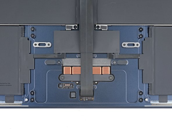

  11. MacBook Air 2022 (M2) Trackpad Replacement, Unfasten the trackpad cable cover: crwdns2935265:011crwdnd2935265:01crwdnd2935265:01crwdne2935265:0
    • Use a T3 Torx driver to remove the two 1.5 mm screws securing the trackpad cable cover.
  12. MacBook Air 2022 (M2) Trackpad Replacement, Access the trackpad press connector: crwdns2935265:012crwdnd2935265:01crwdnd2935265:02crwdne2935265:0 MacBook Air 2022 (M2) Trackpad Replacement, Access the trackpad press connector: crwdns2935265:012crwdnd2935265:02crwdnd2935265:02crwdne2935265:0
    • Use a spudger or your fingers to move the trackpad cable cover out of the way so you can access the press connector underneath.
  13. MacBook Air 2022 (M2) Trackpad Replacement, Disconnect the trackpad cable: crwdns2935265:013crwdnd2935265:01crwdnd2935265:02crwdne2935265:0 MacBook Air 2022 (M2) Trackpad Replacement, Disconnect the trackpad cable: crwdns2935265:013crwdnd2935265:02crwdnd2935265:02crwdne2935265:0
    • Use the pointed end of a spudger to pry up and disconnect the trackpad cable press connector.
    • To re-attach press connectors like this one, carefully align and press down on one side until it clicks into place, then repeat on the other side. Do not press down in the middle. If the connector is misaligned, the pins can bend and cause permanent damage.

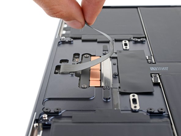

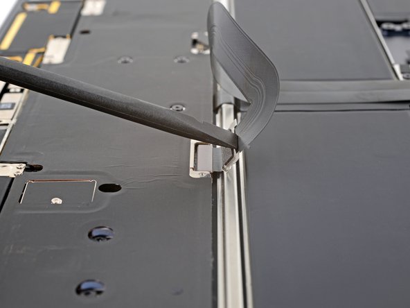

  14. MacBook Air 2022 (M2) Trackpad Replacement, Detach the trackpad cable: crwdns2935265:014crwdnd2935265:01crwdnd2935265:03crwdne2935265:0 MacBook Air 2022 (M2) Trackpad Replacement, Detach the trackpad cable: crwdns2935265:014crwdnd2935265:02crwdnd2935265:03crwdne2935265:0 MacBook Air 2022 (M2) Trackpad Replacement, Detach the trackpad cable: crwdns2935265:014crwdnd2935265:03crwdnd2935265:03crwdne2935265:0
    • Small bits of mild adhesive secure the trackpad cable to the frame.
    • Gently pull up to detach the trackpad cable from the frame.
    • You can also use an opening pick to loosen the adhesive.
    • During reassembly, you may need to apply new adhesive if the old adhesive is no longer sticky.

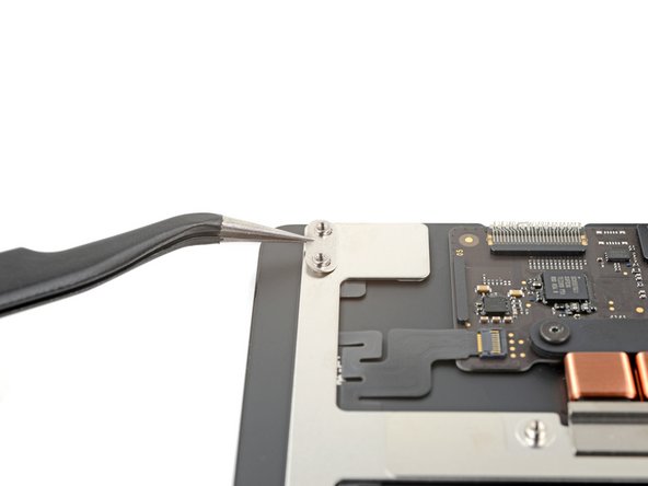

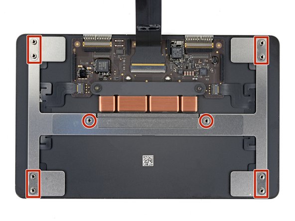

  15. MacBook Air 2022 (M2) Trackpad Replacement, Unfasten the trackpad: crwdns2935265:015crwdnd2935265:01crwdnd2935265:02crwdne2935265:0 MacBook Air 2022 (M2) Trackpad Replacement, Unfasten the trackpad: crwdns2935265:015crwdnd2935265:02crwdnd2935265:02crwdne2935265:0
    • Use a T5 Torx driver to remove the ten 4 mm screws securing the trackpad.
  16. MacBook Air 2022 (M2) Trackpad Replacement, Separate the trackpad: crwdns2935265:016crwdnd2935265:01crwdnd2935265:02crwdne2935265:0 MacBook Air 2022 (M2) Trackpad Replacement, Separate the trackpad: crwdns2935265:016crwdnd2935265:02crwdnd2935265:02crwdne2935265:0
    • Be careful not to lose the six washers resting on the trackpad's screw posts. Without them, your trackpad won't fit properly.
    • Slowly open your MacBook—the trackpad will stay on the display.

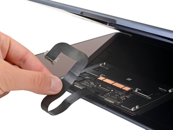

  17. MacBook Air 2022 (M2) Trackpad Replacement, Free the trackpad cable: crwdns2935265:017crwdnd2935265:01crwdnd2935265:02crwdne2935265:0 MacBook Air 2022 (M2) Trackpad Replacement, Free the trackpad cable: crwdns2935265:017crwdnd2935265:02crwdnd2935265:02crwdne2935265:0
    • Carefully feed the trackpad ribbon cable through its slot in the frame.
  18. MacBook Air 2022 (M2) Trackpad Replacement, Remove the trackpad: crwdns2935265:018crwdnd2935265:01crwdnd2935265:03crwdne2935265:0 MacBook Air 2022 (M2) Trackpad Replacement, Remove the trackpad: crwdns2935265:018crwdnd2935265:02crwdnd2935265:03crwdne2935265:0 MacBook Air 2022 (M2) Trackpad Replacement, Remove the trackpad: crwdns2935265:018crwdnd2935265:03crwdnd2935265:03crwdne2935265:0
    • Remove the trackpad.
