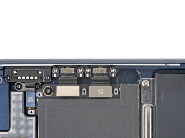

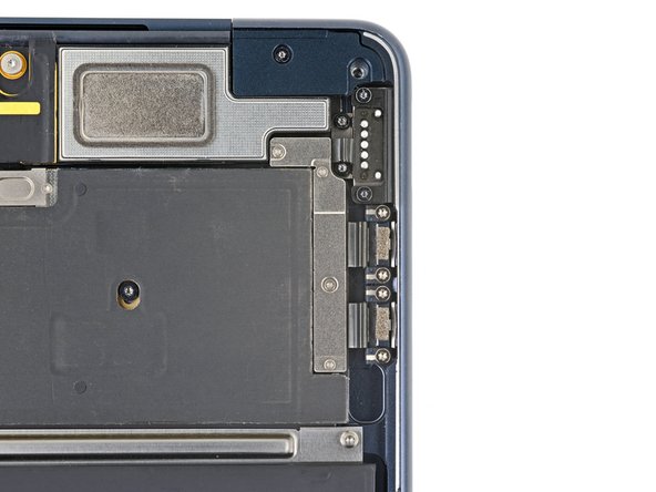

  11. MacBook Air 2022 (M2) Thunderbolt Ports Replacement, Unfasten the top right press connector cover: crwdns2935265:011crwdnd2935265:01crwdnd2935265:02crwdne2935265:0 MacBook Air 2022 (M2) Thunderbolt Ports Replacement, Unfasten the top right press connector cover: crwdns2935265:011crwdnd2935265:02crwdnd2935265:02crwdne2935265:0
    • Use a T3 Torx driver to remove the four 1.5 mm screws securing the top right press connector cover.

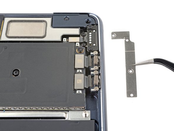

  12. MacBook Air 2022 (M2) Thunderbolt Ports Replacement, Remove the top right press connector cover: crwdns2935265:012crwdnd2935265:01crwdnd2935265:02crwdne2935265:0 MacBook Air 2022 (M2) Thunderbolt Ports Replacement, Remove the top right press connector cover: crwdns2935265:012crwdnd2935265:02crwdnd2935265:02crwdne2935265:0
    • Remove the top right press connector cover.

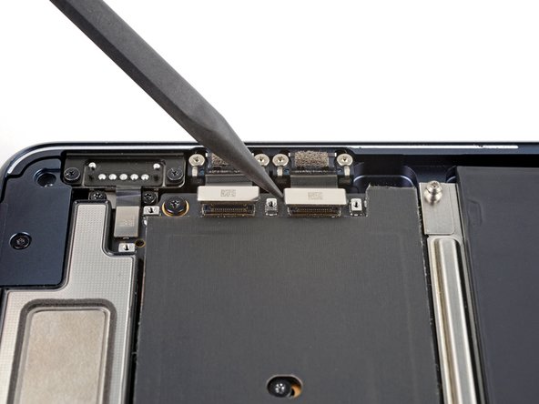

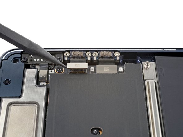

  13. MacBook Air 2022 (M2) Thunderbolt Ports Replacement, Disconnect the Thunderbolt ports: crwdns2935265:013crwdnd2935265:01crwdnd2935265:03crwdne2935265:0 MacBook Air 2022 (M2) Thunderbolt Ports Replacement, Disconnect the Thunderbolt ports: crwdns2935265:013crwdnd2935265:02crwdnd2935265:03crwdne2935265:0 MacBook Air 2022 (M2) Thunderbolt Ports Replacement, Disconnect the Thunderbolt ports: crwdns2935265:013crwdnd2935265:03crwdnd2935265:03crwdne2935265:0
    • Use the pointed end of a spudger to pry up and disconnect both of the Thunderbolt port press connectors.
    • If you're replacing a single Thunderbolt port, only disconnect its corresponding press connector.

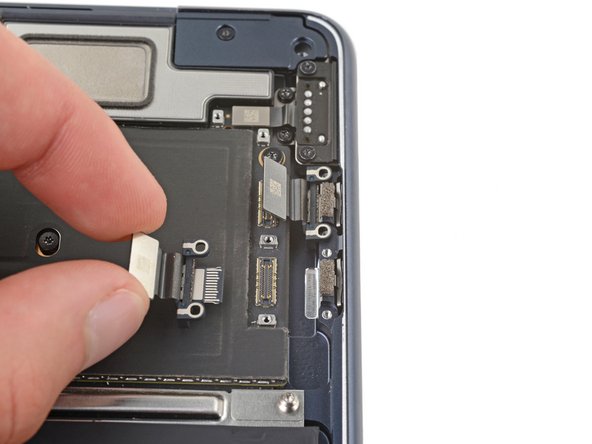

  14. MacBook Air 2022 (M2) Thunderbolt Ports Replacement, Unfasten the Thunderbolt ports: crwdns2935265:014crwdnd2935265:01crwdnd2935265:02crwdne2935265:0 MacBook Air 2022 (M2) Thunderbolt Ports Replacement, Unfasten the Thunderbolt ports: crwdns2935265:014crwdnd2935265:02crwdnd2935265:02crwdne2935265:0
    • Use a T5 Torx screwdriver to remove the four 3.7 mm screws securing the Thunderbolt ports.
    • If you're replacing a single Thunderbolt port, only unfasten its corresponding port.
  15. MacBook Air 2022 (M2) Thunderbolt Ports Replacement, Remove the Thunderbolt ports: crwdns2935265:015crwdnd2935265:01crwdnd2935265:03crwdne2935265:0 MacBook Air 2022 (M2) Thunderbolt Ports Replacement, Remove the Thunderbolt ports: crwdns2935265:015crwdnd2935265:02crwdnd2935265:03crwdne2935265:0 MacBook Air 2022 (M2) Thunderbolt Ports Replacement, Remove the Thunderbolt ports: crwdns2935265:015crwdnd2935265:03crwdnd2935265:03crwdne2935265:0
    • Use your fingers to remove the Thunderbolt ports.
