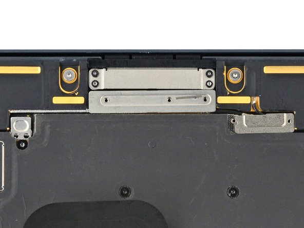

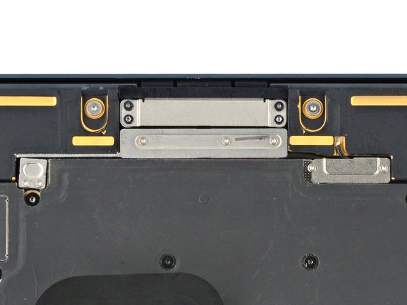

  12. MacBook Air 2022 (M2) Right Speaker Replacement, Unfasten the cable covers: crwdns2935265:012crwdnd2935265:01crwdnd2935265:02crwdne2935265:0 MacBook Air 2022 (M2) Right Speaker Replacement, Unfasten the cable covers: crwdns2935265:012crwdnd2935265:02crwdnd2935265:02crwdne2935265:0
    • Use a T3 Torx driver to remove the seven 1.5 mm screws securing the three metal covers.
  13. MacBook Air 2022 (M2) Right Speaker Replacement, Remove the cable covers: crwdns2935265:013crwdnd2935265:01crwdnd2935265:03crwdne2935265:0 MacBook Air 2022 (M2) Right Speaker Replacement, Remove the cable covers: crwdns2935265:013crwdnd2935265:02crwdnd2935265:03crwdne2935265:0 MacBook Air 2022 (M2) Right Speaker Replacement, Remove the cable covers: crwdns2935265:013crwdnd2935265:03crwdnd2935265:03crwdne2935265:0
    • Use tweezers or your fingers to remove the three metal covers:
    • Two speaker cable covers
    • The display cable cover

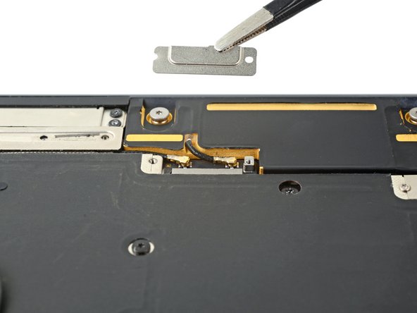

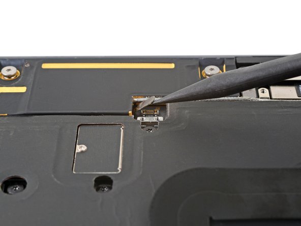

  14. MacBook Air 2022 (M2) Right Speaker Replacement, Disconnect the speaker cables: crwdns2935265:014crwdnd2935265:01crwdnd2935265:02crwdne2935265:0 MacBook Air 2022 (M2) Right Speaker Replacement, Disconnect the speaker cables: crwdns2935265:014crwdnd2935265:02crwdnd2935265:02crwdne2935265:0
    • The right speaker will be on your left-hand side when working on the MacBook, as it's laying upside down.
    • Use the pointed end of a spudger to pry up and disconnect the right speaker press connector.

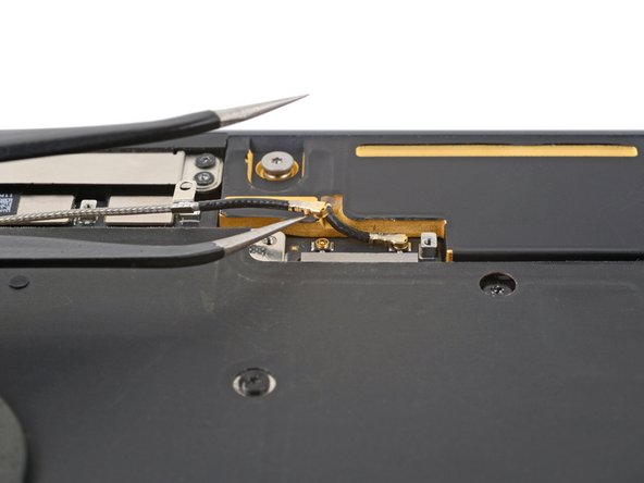

  15. MacBook Air 2022 (M2) Right Speaker Replacement: crwdns2935265:015crwdnd2935265:01crwdnd2935265:02crwdne2935265:0 MacBook Air 2022 (M2) Right Speaker Replacement: crwdns2935265:015crwdnd2935265:02crwdnd2935265:02crwdne2935265:0
    • Use a pair of tweezers to grip the left antenna connector, as close to its base as possible.
    • Lift straight up to disconnect the cable.
    • The antenna connectors on the logic board are very fragile. When disconnecting the cables, pull straight up—don’t bend them to the side.
    • To reattach antenna connectors like these, align the connector over its socket and press down with the flat end of a spudger. The connector should snap into place. This can be tricky and may take a few tries.

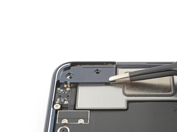

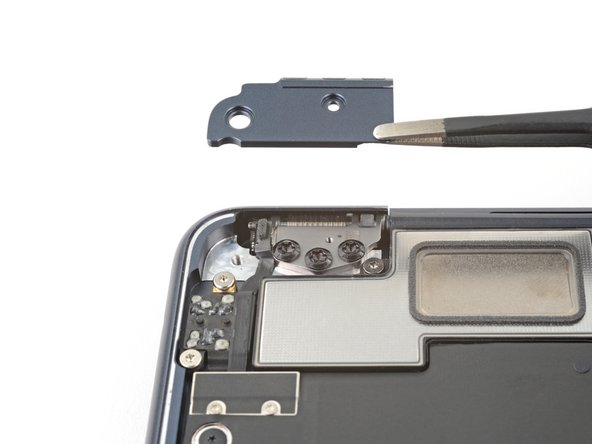

  16. MacBook Air 2022 (M2) Right Speaker Replacement, Unfasten the left hinge cover: crwdns2935265:016crwdnd2935265:01crwdnd2935265:01crwdne2935265:0
    • Use a 3IP Torx Plus driver to remove the 2.6 mm screw securing the left hinge cover.
  17. MacBook Air 2022 (M2) Right Speaker Replacement, Remove the left hinge cover: crwdns2935265:017crwdnd2935265:01crwdnd2935265:03crwdne2935265:0 MacBook Air 2022 (M2) Right Speaker Replacement, Remove the left hinge cover: crwdns2935265:017crwdnd2935265:02crwdnd2935265:03crwdne2935265:0 MacBook Air 2022 (M2) Right Speaker Replacement, Remove the left hinge cover: crwdns2935265:017crwdnd2935265:03crwdnd2935265:03crwdne2935265:0
    • Grip the left hinge cover with blunt nose tweezers.
    • Pull the cover toward the bottom of the laptop and upward to free it from its recess.
    • Pull up and remove the hinge cover.

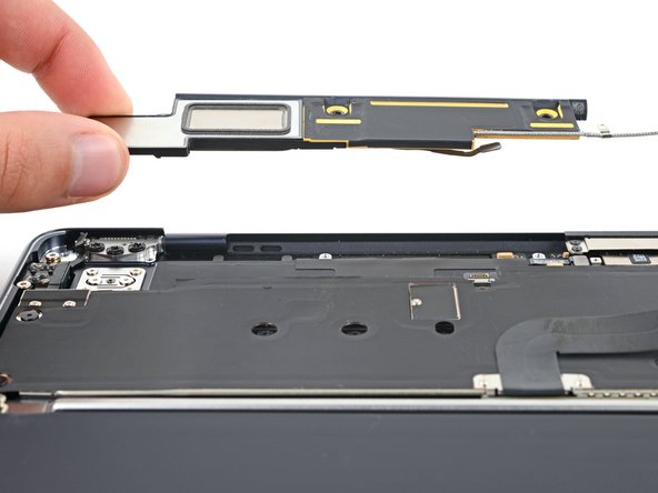

  18. MacBook Air 2022 (M2) Right Speaker Replacement, Unfasten the speaker: crwdns2935265:018crwdnd2935265:01crwdnd2935265:01crwdne2935265:0
    • Remove the three screws securing the right speaker:
    • Two 5.6 mm 4IP Torx Plus screws
    • One 3.5 mm T5 Torx screw
  19. MacBook Air 2022 (M2) Right Speaker Replacement, Remove the speaker: crwdns2935265:019crwdnd2935265:01crwdnd2935265:02crwdne2935265:0 MacBook Air 2022 (M2) Right Speaker Replacement, Remove the speaker: crwdns2935265:019crwdnd2935265:02crwdnd2935265:02crwdne2935265:0
    • Lift the right speaker straight up and remove it.
Compare your new replacement part to the original part—you may need to transfer remaining components or remove adhesive backings from the new part before you install it.
