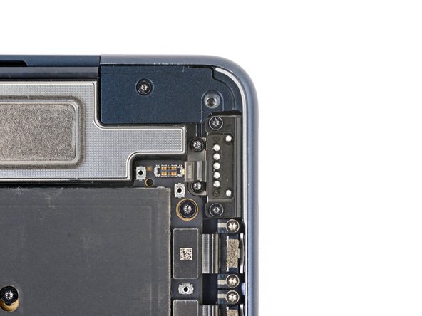

  11. MacBook Air 2022 (M2) MagSafe Port Replacement, Unfasten the top right press connector cover: crwdns2935265:011crwdnd2935265:01crwdnd2935265:02crwdne2935265:0 MacBook Air 2022 (M2) MagSafe Port Replacement, Unfasten the top right press connector cover: crwdns2935265:011crwdnd2935265:02crwdnd2935265:02crwdne2935265:0
    • Use a T3 Torx driver to remove the four 1.5 mm screws securing the top right press connector cover.
  12. MacBook Air 2022 (M2) MagSafe Port Replacement, Remove the top right press connector cover: crwdns2935265:012crwdnd2935265:01crwdnd2935265:02crwdne2935265:0 MacBook Air 2022 (M2) MagSafe Port Replacement, Remove the top right press connector cover: crwdns2935265:012crwdnd2935265:02crwdnd2935265:02crwdne2935265:0
    • Remove the top right press connector cover.

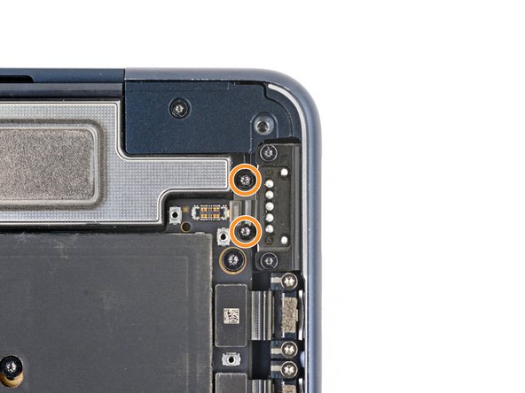

  13. MacBook Air 2022 (M2) MagSafe Port Replacement, Disconnect the MagSafe port: crwdns2935265:013crwdnd2935265:01crwdnd2935265:02crwdne2935265:0 MacBook Air 2022 (M2) MagSafe Port Replacement, Disconnect the MagSafe port: crwdns2935265:013crwdnd2935265:02crwdnd2935265:02crwdne2935265:0

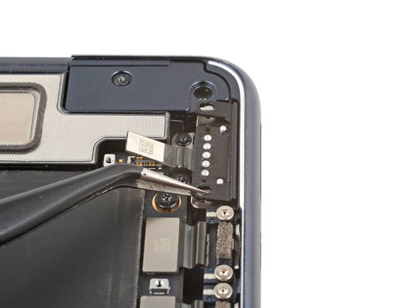

    • Use the pointed end of a spudger to pry up and disconnect the MagSafe port press connector.
  14. MacBook Air 2022 (M2) MagSafe Port Replacement, Unfasten the MagSafe port: crwdns2935265:014crwdnd2935265:01crwdnd2935265:02crwdne2935265:0 MacBook Air 2022 (M2) MagSafe Port Replacement, Unfasten the MagSafe port: crwdns2935265:014crwdnd2935265:02crwdnd2935265:02crwdne2935265:0

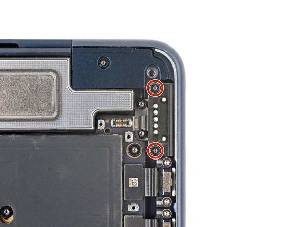

    • Use a 3IP Torx Plus driver to remove the two 3.3 mm screws securing the metal wedge to the MagSafe port.
    • This wedge keeps the port secure in its recess.
    • Use a T5 Torx driver to remove the two 2.8 mm screws securing the MagSafe port to the frame.

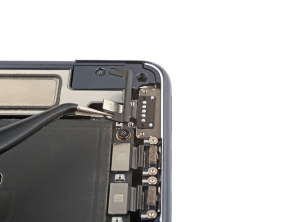

  15. MacBook Air 2022 (M2) MagSafe Port Replacement, Remove the securing bracket: crwdns2935265:015crwdnd2935265:01crwdnd2935265:03crwdne2935265:0 MacBook Air 2022 (M2) MagSafe Port Replacement, Remove the securing bracket: crwdns2935265:015crwdnd2935265:02crwdnd2935265:03crwdne2935265:0 MacBook Air 2022 (M2) MagSafe Port Replacement, Remove the securing bracket: crwdns2935265:015crwdnd2935265:03crwdnd2935265:03crwdne2935265:0
    • Use tweezers or your fingers to remove the wedge from the top of the MagSafe port.

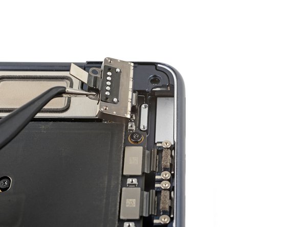

  16. MacBook Air 2022 (M2) MagSafe Port Replacement, Remove the MagSafe port: crwdns2935265:016crwdnd2935265:01crwdnd2935265:03crwdne2935265:0 MacBook Air 2022 (M2) MagSafe Port Replacement, Remove the MagSafe port: crwdns2935265:016crwdnd2935265:02crwdnd2935265:03crwdne2935265:0 MacBook Air 2022 (M2) MagSafe Port Replacement, Remove the MagSafe port: crwdns2935265:016crwdnd2935265:03crwdnd2935265:03crwdne2935265:0
    • Use tweezers or your fingers to remove the MagSafe port.

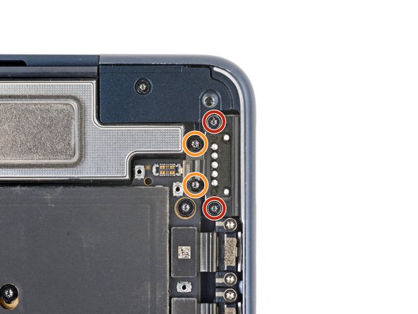

  17. MacBook Air 2022 (M2) MagSafe Port Replacement, Install your MagSafe port: crwdns2935265:017crwdnd2935265:01crwdnd2935265:03crwdne2935265:0 MacBook Air 2022 (M2) MagSafe Port Replacement, Install your MagSafe port: crwdns2935265:017crwdnd2935265:02crwdnd2935265:03crwdne2935265:0 MacBook Air 2022 (M2) MagSafe Port Replacement, Install your MagSafe port: crwdns2935265:017crwdnd2935265:03crwdnd2935265:03crwdne2935265:0
    • Follow this step to install your MagSafe port.
    • The screws will be drawn toward the magnet in the port. You may need to use angled tweezers to hold the screws in place while tightening them.
    • Insert the port and partially tighten the two 2.8 mm‑long screws that secure its left edge.
    • Properly align the port and fully tighten its screws.
    • You can plug your charger in and use it to align the port, but make sure it's not plugged into power.
    • Put the wedge into place on top of the MagSafe port and partially tighten its two 3.3 mm‑long screws.
    • Push the wedge under the lip of the frame and fully tighten its screws.
