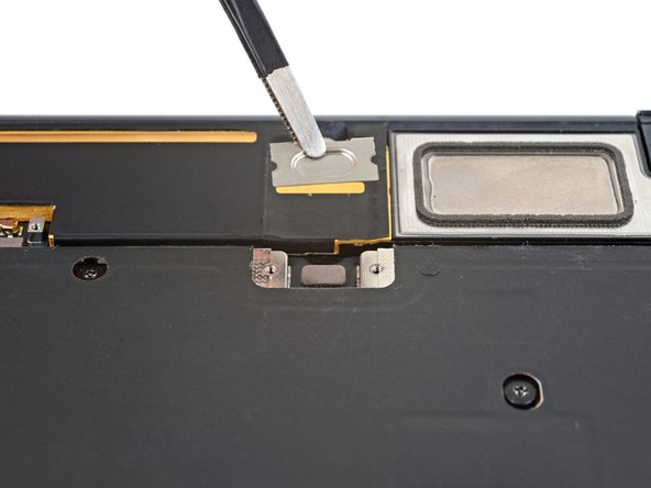

  11. MacBook Air 2022 (M2) Left Speaker Replacement, Unfasten the speaker cable covers: crwdns2935265:011crwdnd2935265:01crwdnd2935265:01crwdne2935265:0
    • The left speaker will be on your right-hand side when working on the MacBook, as it's laying upside down.
    • Use a T3 Torx driver to remove the four 1.5 mm screws securing the left speaker cable covers.

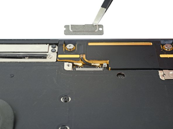

  12. MacBook Air 2022 (M2) Left Speaker Replacement, Remove the speaker cable covers: crwdns2935265:012crwdnd2935265:01crwdnd2935265:03crwdne2935265:0 MacBook Air 2022 (M2) Left Speaker Replacement, Remove the speaker cable covers: crwdns2935265:012crwdnd2935265:02crwdnd2935265:03crwdne2935265:0 MacBook Air 2022 (M2) Left Speaker Replacement, Remove the speaker cable covers: crwdns2935265:012crwdnd2935265:03crwdnd2935265:03crwdne2935265:0
    • Remove the two speaker cable covers.

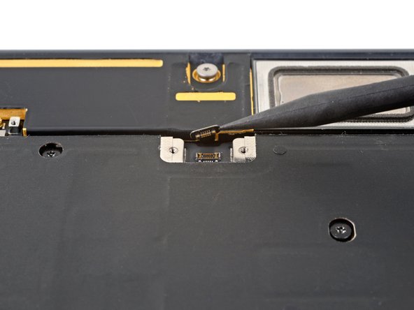

  13. MacBook Air 2022 (M2) Left Speaker Replacement, Disconnect the speaker cables: crwdns2935265:013crwdnd2935265:01crwdnd2935265:02crwdne2935265:0 MacBook Air 2022 (M2) Left Speaker Replacement, Disconnect the speaker cables: crwdns2935265:013crwdnd2935265:02crwdnd2935265:02crwdne2935265:0
    • Use the pointed end of a spudger to pry up and disconnect the left speaker press connector.

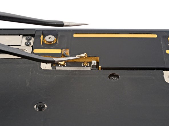

  14. MacBook Air 2022 (M2) Left Speaker Replacement: crwdns2935265:014crwdnd2935265:01crwdnd2935265:02crwdne2935265:0 MacBook Air 2022 (M2) Left Speaker Replacement: crwdns2935265:014crwdnd2935265:02crwdnd2935265:02crwdne2935265:0
    • Use a pair of tweezers to grip the right antenna connector, as close to its base as possible.
    • Lift straight up to disconnect the cable.
    • The antenna connectors on the logic board are very fragile. When disconnecting the cables, pull straight up—don’t bend them to the side.
    • To reattach antenna connectors like these, align the connector over its socket and press down with the flat end of a spudger. The connector should snap into place. This can be tricky and may take a few tries.

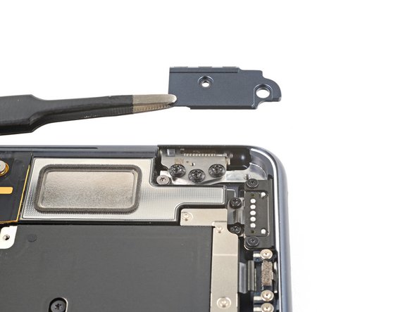

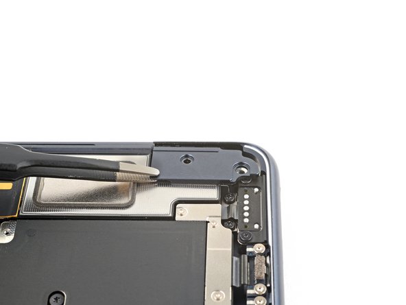

  15. MacBook Air 2022 (M2) Left Speaker Replacement, Unfasten the right hinge cover: crwdns2935265:015crwdnd2935265:01crwdnd2935265:01crwdne2935265:0
    • Use a 3IP Torx Plus driver to remove the 2.6 mm screw securing the right hinge cover.
  16. MacBook Air 2022 (M2) Left Speaker Replacement, Remove the right hinge cover: crwdns2935265:016crwdnd2935265:01crwdnd2935265:03crwdne2935265:0 MacBook Air 2022 (M2) Left Speaker Replacement, Remove the right hinge cover: crwdns2935265:016crwdnd2935265:02crwdnd2935265:03crwdne2935265:0 MacBook Air 2022 (M2) Left Speaker Replacement, Remove the right hinge cover: crwdns2935265:016crwdnd2935265:03crwdnd2935265:03crwdne2935265:0
    • Grip the right hinge cover with blunt nose tweezers.
    • Pull the cover toward the bottom of the laptop and upward to free it from its recess.
    • Pull up and remove the hinge cover.

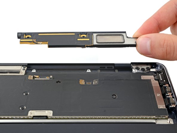

  17. MacBook Air 2022 (M2) Left Speaker Replacement, Unfasten the speaker: crwdns2935265:017crwdnd2935265:01crwdnd2935265:01crwdne2935265:0
    • Remove the three screws securing the left speaker:
    • Two 5.6 mm 4IP Torx Plus screws
    • One 3.5 mm T5 Torx screw
  18. MacBook Air 2022 (M2) Left Speaker Replacement, Remove the speaker: crwdns2935265:018crwdnd2935265:01crwdnd2935265:02crwdne2935265:0 MacBook Air 2022 (M2) Left Speaker Replacement, Remove the speaker: crwdns2935265:018crwdnd2935265:02crwdnd2935265:02crwdne2935265:0
    • Lift the left speaker straight up and remove it.
Compare your new replacement part to the original part—you may need to transfer remaining components or remove adhesive backings from the new part before you install it.
