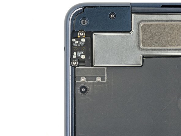

  11. MacBook Air 2022 (M2) Headphone Jack Replacement, Unfasten the headphone jack connector cover: crwdns2935265:011crwdnd2935265:01crwdnd2935265:02crwdne2935265:0 MacBook Air 2022 (M2) Headphone Jack Replacement, Unfasten the headphone jack connector cover: crwdns2935265:011crwdnd2935265:02crwdnd2935265:02crwdne2935265:0
    • Use a T3 Torx screwdriver to remove the two 1.5 mm screws securing the headphone jack connector cover.
  12. MacBook Air 2022 (M2) Headphone Jack Replacement, Remove the headphone jack connector cover: crwdns2935265:012crwdnd2935265:01crwdnd2935265:02crwdne2935265:0 MacBook Air 2022 (M2) Headphone Jack Replacement, Remove the headphone jack connector cover: crwdns2935265:012crwdnd2935265:02crwdnd2935265:02crwdne2935265:0
    • Remove the headphone jack connector cover.

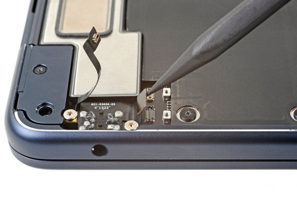

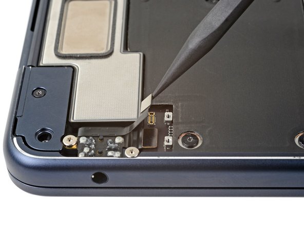

  13. MacBook Air 2022 (M2) Headphone Jack Replacement, Free the headphone jack: crwdns2935265:013crwdnd2935265:01crwdnd2935265:02crwdne2935265:0 MacBook Air 2022 (M2) Headphone Jack Replacement, Free the headphone jack: crwdns2935265:013crwdnd2935265:02crwdnd2935265:02crwdne2935265:0
    • Use the pointed end of a spudger to pry up and disconnect lid angle sensor press connector.

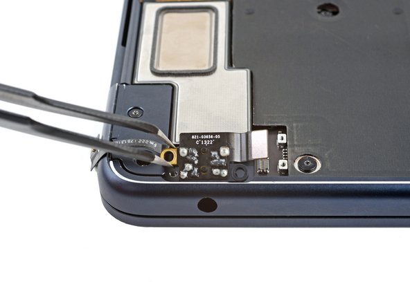

  14. MacBook Air 2022 (M2) Headphone Jack Replacement: crwdns2935265:014crwdnd2935265:01crwdnd2935265:01crwdne2935265:0
    • Gently peel the lid angle sensor cable from the top of the headphone jack and move it out of the way.
  15. MacBook Air 2022 (M2) Headphone Jack Replacement: crwdns2935265:015crwdnd2935265:01crwdnd2935265:02crwdne2935265:0 MacBook Air 2022 (M2) Headphone Jack Replacement: crwdns2935265:015crwdnd2935265:02crwdnd2935265:02crwdne2935265:0
    • Disconnect the headphone jack press connector.

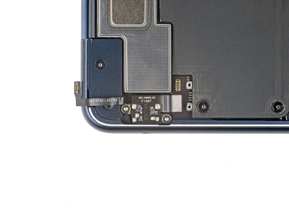

  16. MacBook Air 2022 (M2) Headphone Jack Replacement, Unfasten the headphone jack: crwdns2935265:016crwdnd2935265:01crwdnd2935265:02crwdne2935265:0 MacBook Air 2022 (M2) Headphone Jack Replacement, Unfasten the headphone jack: crwdns2935265:016crwdnd2935265:02crwdnd2935265:02crwdne2935265:0
    • Use a T5 Torx screwdriver to remove the two 4.8 mm screws securing the headphone jack.
  17. MacBook Air 2022 (M2) Headphone Jack Replacement, Remove the headphone jack: crwdns2935265:017crwdnd2935265:01crwdnd2935265:03crwdne2935265:0 MacBook Air 2022 (M2) Headphone Jack Replacement, Remove the headphone jack: crwdns2935265:017crwdnd2935265:02crwdnd2935265:03crwdne2935265:0 MacBook Air 2022 (M2) Headphone Jack Replacement, Remove the headphone jack: crwdns2935265:017crwdnd2935265:03crwdnd2935265:03crwdne2935265:0
    • Tilt the headphone jack towards the left edge of the laptop, dislodging it from its recess.
    • Lift the headphone jack straight up and remove it.
