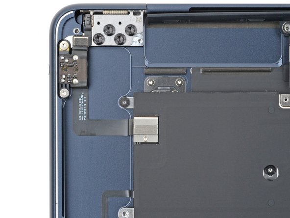

  18. MacBook Air 15" 2024 Headphone Jack Replacement, Remove the press connector cover: crwdns2935265:018crwdnd2935265:01crwdnd2935265:03crwdne2935265:0 MacBook Air 15" 2024 Headphone Jack Replacement, Remove the press connector cover: crwdns2935265:018crwdnd2935265:02crwdnd2935265:03crwdne2935265:0 MacBook Air 15" 2024 Headphone Jack Replacement, Remove the press connector cover: crwdns2935265:018crwdnd2935265:03crwdnd2935265:03crwdne2935265:0
    • Use a 3IP Torx Plus screwdriver to remove the 1.5 mm‑long screw securing the headphone jack press connector cover.
    • Remove the headphone jack press connector cover.

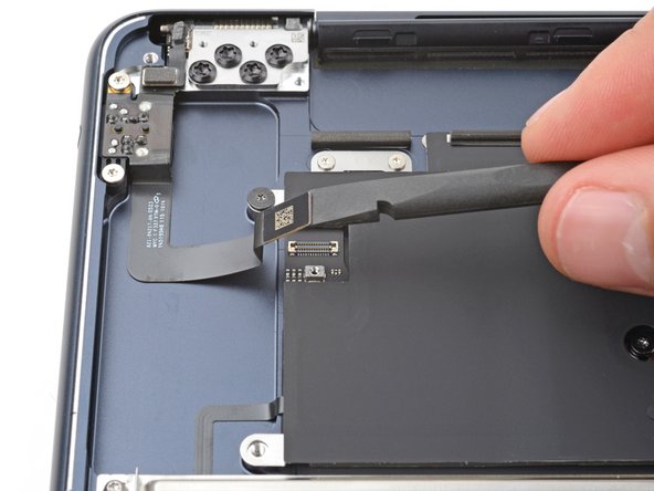

  19. MacBook Air 15" 2024 Headphone Jack Replacement, Disconnect the headphone jack: crwdns2935265:019crwdnd2935265:01crwdnd2935265:02crwdne2935265:0 MacBook Air 15" 2024 Headphone Jack Replacement, Disconnect the headphone jack: crwdns2935265:019crwdnd2935265:02crwdnd2935265:02crwdne2935265:0
    • Use the flat end of a spudger to pry up and disconnect the headphone jack press connector.

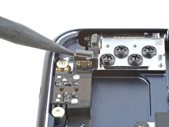

  20. MacBook Air 15" 2024 Headphone Jack Replacement, Disconnect the lid angle sensor: crwdns2935265:020crwdnd2935265:01crwdnd2935265:02crwdne2935265:0 MacBook Air 15" 2024 Headphone Jack Replacement, Disconnect the lid angle sensor: crwdns2935265:020crwdnd2935265:02crwdnd2935265:02crwdne2935265:0
    • Use the point of a spudger to pry up and disconnect the lid angle sensor press connector from the headphone jack's upper cable.

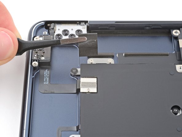

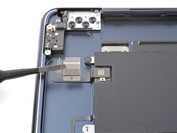

  21. MacBook Air 15" 2024 Headphone Jack Replacement, Separate the upper and lower cable adhesive: crwdns2935265:021crwdnd2935265:01crwdnd2935265:02crwdne2935265:0 MacBook Air 15" 2024 Headphone Jack Replacement, Separate the upper and lower cable adhesive: crwdns2935265:021crwdnd2935265:02crwdnd2935265:02crwdne2935265:0
    • Light adhesive secures the headphone jack's upper and lower cables to the frame.
    • Insert the point of a spudger under the headphone jack's upper cable.
    • Gently lift the cable to separate the adhesive securing it.

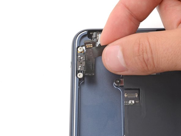

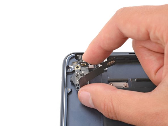

  22. MacBook Air 15" 2024 Headphone Jack Replacement: crwdns2935265:022crwdnd2935265:01crwdnd2935265:02crwdne2935265:0 MacBook Air 15" 2024 Headphone Jack Replacement: crwdns2935265:022crwdnd2935265:02crwdnd2935265:02crwdne2935265:0
    Tesa 61395 Tape
    $2.99
    • Gently peel the headphone jack's lower cable from the frame.

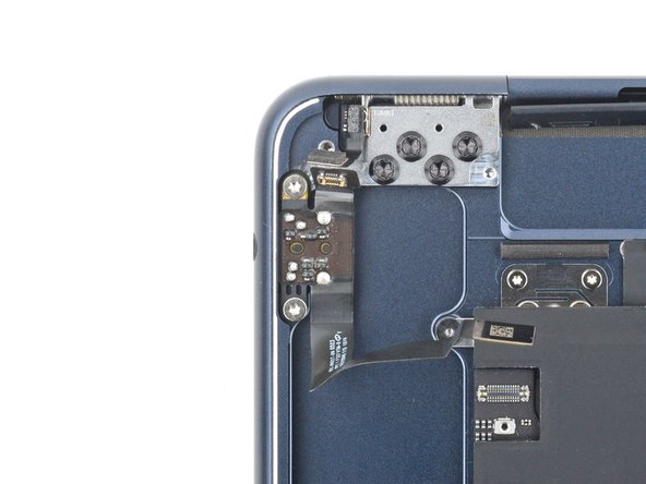

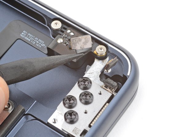

  23. MacBook Air 15" 2024 Headphone Jack Replacement, Unfasten the headphone jack: crwdns2935265:023crwdnd2935265:01crwdnd2935265:02crwdne2935265:0 MacBook Air 15" 2024 Headphone Jack Replacement, Unfasten the headphone jack: crwdns2935265:023crwdnd2935265:02crwdnd2935265:02crwdne2935265:0
    • Use a 5IP Torx Plus screwdriver to remove the two 4.8 mm‑long screws securing the headphone jack.

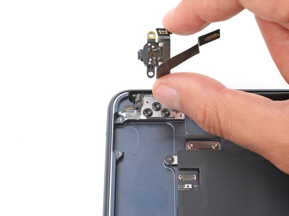

  24. MacBook Air 15" 2024 Headphone Jack Replacement, Remove the headphone jack: crwdns2935265:024crwdnd2935265:01crwdnd2935265:03crwdne2935265:0 MacBook Air 15" 2024 Headphone Jack Replacement, Remove the headphone jack: crwdns2935265:024crwdnd2935265:02crwdnd2935265:03crwdne2935265:0 MacBook Air 15" 2024 Headphone Jack Replacement, Remove the headphone jack: crwdns2935265:024crwdnd2935265:03crwdnd2935265:03crwdne2935265:0
    • Slide the headphone jack out of its recess and remove it.
