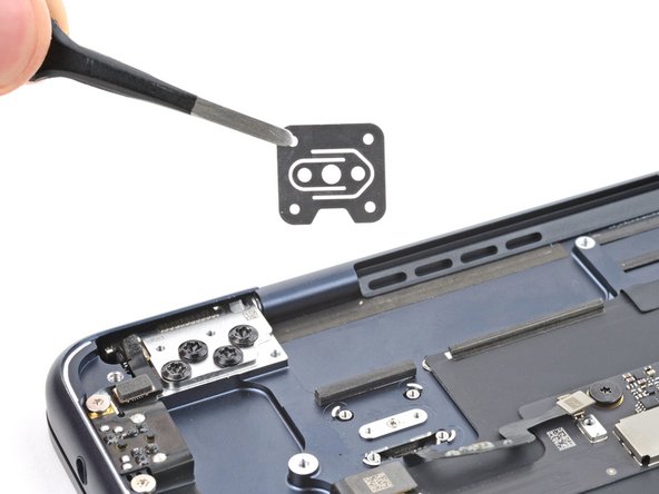

  23. MacBook Air 15" 2023 Touch ID Sensor Replacement, Remove the antenna cables cover: crwdns2935265:023crwdnd2935265:01crwdnd2935265:03crwdne2935265:0 MacBook Air 15" 2023 Touch ID Sensor Replacement, Remove the antenna cables cover: crwdns2935265:023crwdnd2935265:02crwdnd2935265:03crwdne2935265:0 MacBook Air 15" 2023 Touch ID Sensor Replacement, Remove the antenna cables cover: crwdns2935265:023crwdnd2935265:03crwdnd2935265:03crwdne2935265:0
    • Use a 3IP Torx Plus screwdriver to remove the two 1.5 mm‑long screws securing the antenna cables cover.
    • Remove the cover.

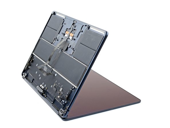

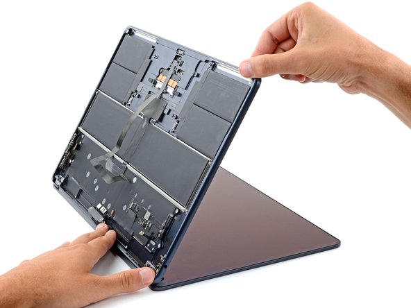

  37. MacBook Air 15" 2023 Touch ID Sensor Replacement, Remove the logic board: crwdns2935265:037crwdnd2935265:01crwdnd2935265:03crwdne2935265:0 MacBook Air 15" 2023 Touch ID Sensor Replacement, Remove the logic board: crwdns2935265:037crwdnd2935265:02crwdnd2935265:03crwdne2935265:0 MacBook Air 15" 2023 Touch ID Sensor Replacement, Remove the logic board: crwdns2935265:037crwdnd2935265:03crwdnd2935265:03crwdne2935265:0
    • Grip the right side of the logic board and remove it.
    • During reassembly:
    • Lower the logic board into place, making sure no cables get stuck underneath.
    • Carefully check the edges of the logic board to see if any cables got stuck underneath. If any did, use the point of a spudger to gently pull them out.

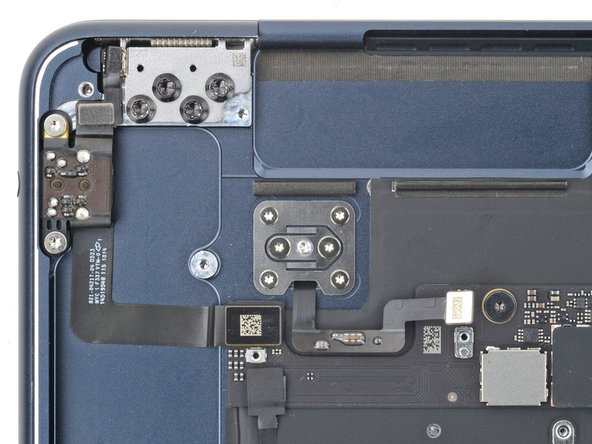

    • Use a 3IP Torx Plus screwdriver to remove the two 1.5 mm‑long screws securing the Touch ID sensor and headphone jack connector covers.
    • Remove the two covers.

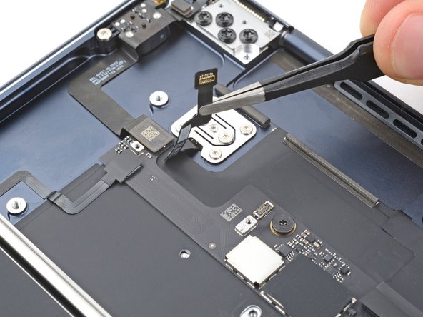

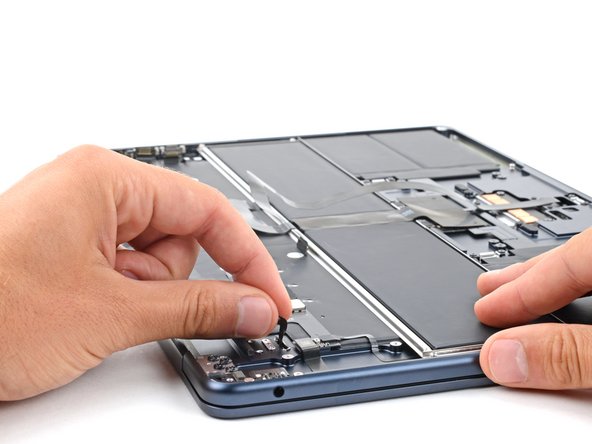

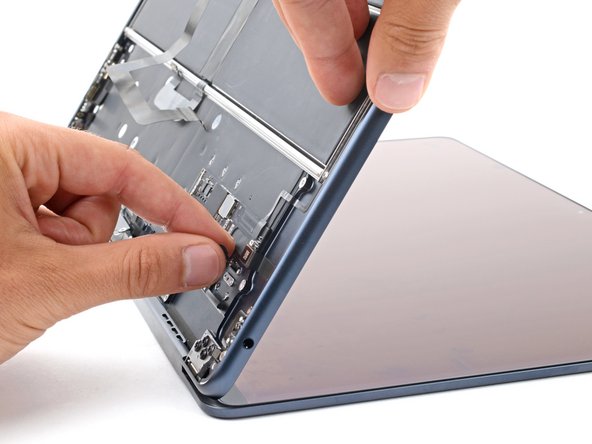

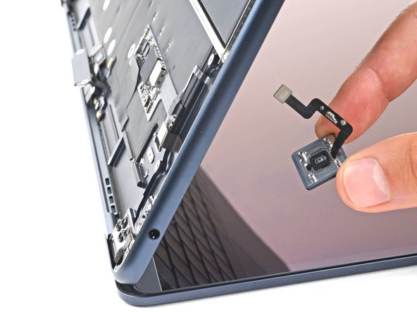

  39. MacBook Air 15" 2023 Touch ID Sensor Replacement, Disconnect the Touch ID sensor: crwdns2935265:039crwdnd2935265:01crwdnd2935265:02crwdne2935265:0 MacBook Air 15" 2023 Touch ID Sensor Replacement, Disconnect the Touch ID sensor: crwdns2935265:039crwdnd2935265:02crwdnd2935265:02crwdne2935265:0
    • Use a spudger to pry up and disconnect the Touch ID sensor press connector from the daughterboard.
  40. MacBook Air 15" 2023 Touch ID Sensor Replacement, Separate the cable adhesive: crwdns2935265:040crwdnd2935265:01crwdnd2935265:02crwdne2935265:0 MacBook Air 15" 2023 Touch ID Sensor Replacement, Separate the cable adhesive: crwdns2935265:040crwdnd2935265:02crwdnd2935265:02crwdne2935265:0

    • Light adhesive secures the Touch ID sensor cable to the frame.
    • Use blunt-nose tweezers or your fingers to peel the Touch ID sensor cable from the frame.
    • If your new Touch ID sensor's cable comes with adhesive, remove the plastic liner and press the cable into place on the frame.
    • If the cable doesn't have adhesive, use a strip of double-sided tape to secure it to the frame.
  41. MacBook Air 15" 2023 Touch ID Sensor Replacement, Remove the Touch ID sensor bracket: crwdns2935265:041crwdnd2935265:01crwdnd2935265:03crwdne2935265:0 MacBook Air 15" 2023 Touch ID Sensor Replacement, Remove the Touch ID sensor bracket: crwdns2935265:041crwdnd2935265:02crwdnd2935265:03crwdne2935265:0 MacBook Air 15" 2023 Touch ID Sensor Replacement, Remove the Touch ID sensor bracket: crwdns2935265:041crwdnd2935265:03crwdnd2935265:03crwdne2935265:0
    • Use a 3IP Torx Plus screwdriver to remove the six screws securing the Touch ID sensor and its bracket:
    • Four 2 mm‑long screws
    • Two 1.7 mm‑long screws
    • Install the screws without fully tightening them.
    • Open your MacBook and align the Touch ID sensor on the keyboard.
    • Close your MacBook and fully tighten the screws.
  42. MacBook Air 15" 2023 Touch ID Sensor Replacement, Open your MacBook: crwdns2935265:042crwdnd2935265:01crwdnd2935265:03crwdne2935265:0 MacBook Air 15" 2023 Touch ID Sensor Replacement, Open your MacBook: crwdns2935265:042crwdnd2935265:02crwdnd2935265:03crwdne2935265:0 MacBook Air 15" 2023 Touch ID Sensor Replacement, Open your MacBook: crwdns2935265:042crwdnd2935265:03crwdnd2935265:03crwdne2935265:0
    • Open your MacBook until the main body stands up on its own.
  43. MacBook Air 15" 2023 Touch ID Sensor Replacement, Remove the Touch ID sensor: crwdns2935265:043crwdnd2935265:01crwdnd2935265:02crwdne2935265:0 MacBook Air 15" 2023 Touch ID Sensor Replacement, Remove the Touch ID sensor: crwdns2935265:043crwdnd2935265:02crwdnd2935265:02crwdne2935265:0
    • Pull the Touch ID sensor away from the frame while guiding the cable through its slot.
    • Remove the sensor.
  44. MacBook Air 15" 2023 Touch ID Sensor Replacement, Reassembly information: crwdns2935265:044crwdnd2935265:01crwdnd2935265:03crwdne2935265:0 MacBook Air 15" 2023 Touch ID Sensor Replacement, Reassembly information: crwdns2935265:044crwdnd2935265:02crwdnd2935265:03crwdne2935265:0 MacBook Air 15" 2023 Touch ID Sensor Replacement, Reassembly information: crwdns2935265:044crwdnd2935265:03crwdnd2935265:03crwdne2935265:0
    • Guide the new Touch ID sensor's cable through its slot in the fame.
    • Make sure the cable is properly oriented so the press connector lines up with its socket.
    • Hold the cable with one hand and use your other hand to align the new sensor in its recess.
    • Once the sensor is aligned, gently pull the cable away from the MacBook to secure the sensor against the frame.
    • Continue holding the sensor in place by its cable and slowly close the MacBook.
