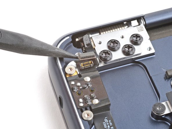

  32. MacBook Air 15" 2023 Screen Replacement, Disconnect the lid angle sensor: crwdns2935265:032crwdnd2935265:01crwdnd2935265:02crwdne2935265:0 MacBook Air 15" 2023 Screen Replacement, Disconnect the lid angle sensor: crwdns2935265:032crwdnd2935265:02crwdnd2935265:02crwdne2935265:0
    • Use the point of a spudger to pry up and disconnect the lid angle sensor from the top left corner of the MacBook.
    • If your replacement screen does not come with a lid‑angle sensor installed on the hinge, you'll need to remove the sensor. Use a 1IP Torx Plus screwdriver to remove the screw securing the sensor. Then, remove the sensor and set it aside for reassembly.
    • During reassembly, if you removed the lid angle sensor, install it on your replacement screen's hinge.

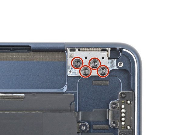

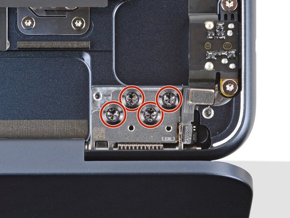

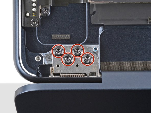

  33. MacBook Air 15" 2023 Screen Replacement, Partially unfasten the hinges: crwdns2935265:033crwdnd2935265:01crwdnd2935265:02crwdne2935265:0 MacBook Air 15" 2023 Screen Replacement, Partially unfasten the hinges: crwdns2935265:033crwdnd2935265:02crwdnd2935265:02crwdne2935265:0
    • Use an 8IP Torx plus screwdriver to loosen (not remove) the eight hinge screws.

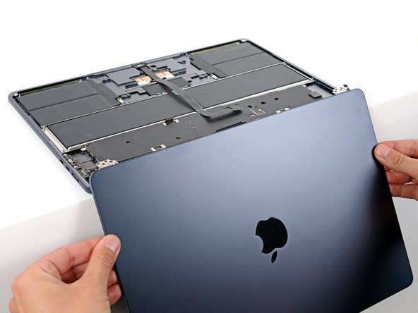

  34. MacBook Air 15" 2023 Screen Replacement, Open your MacBook and set it down: crwdns2935265:034crwdnd2935265:01crwdnd2935265:02crwdne2935265:0 MacBook Air 15" 2023 Screen Replacement, Open your MacBook and set it down: crwdns2935265:034crwdnd2935265:02crwdnd2935265:02crwdne2935265:0
    • Fully open your MacBook and gently place it keyboard side down on a table so the screen hangs over the edge.
  35. MacBook Air 15" 2023 Screen Replacement, Remove the hinge screws: crwdns2935265:035crwdnd2935265:01crwdnd2935265:03crwdne2935265:0 MacBook Air 15" 2023 Screen Replacement, Remove the hinge screws: crwdns2935265:035crwdnd2935265:02crwdnd2935265:03crwdne2935265:0 MacBook Air 15" 2023 Screen Replacement, Remove the hinge screws: crwdns2935265:035crwdnd2935265:03crwdnd2935265:03crwdne2935265:0
    • Support the screen with one hand and use your free hand to remove the eight 4.7 mm‑long 8IP Torx Plus screws securing the hinges.
    • Keep a firm grip on your laptop, as it can easily fall off the table.

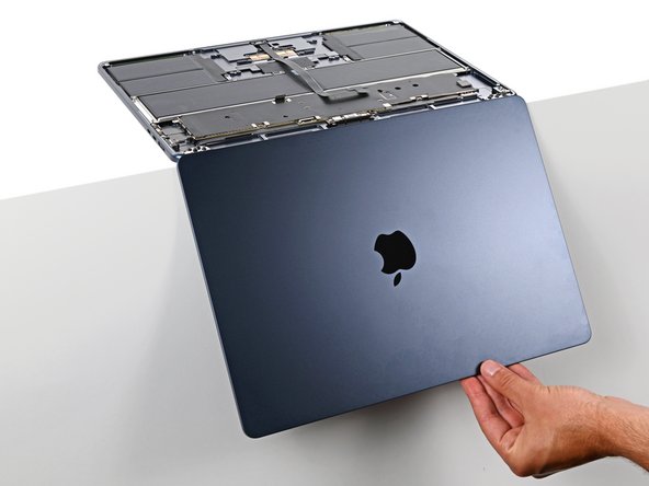

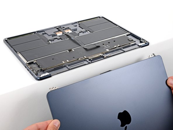

  36. MacBook Air 15" 2023 Screen Replacement, Remove the screen: crwdns2935265:036crwdnd2935265:01crwdnd2935265:03crwdne2935265:0 MacBook Air 15" 2023 Screen Replacement, Remove the screen: crwdns2935265:036crwdnd2935265:02crwdnd2935265:03crwdne2935265:0 MacBook Air 15" 2023 Screen Replacement, Remove the screen: crwdns2935265:036crwdnd2935265:03crwdnd2935265:03crwdne2935265:0
    • Hold the screen with both hands and lift the hinges out of their recesses to remove the screen.
    • During reassembly:
    • Make sure the screen hinges are fully open and guide them into their recesses in the frame.
    • Install and partially tighten the eight hinge screws.
    • Close your laptop and make sure the screen is properly aligned. If it clicks or snaps, readjust the alignment.
    • Fully tighten the hinge screws.
