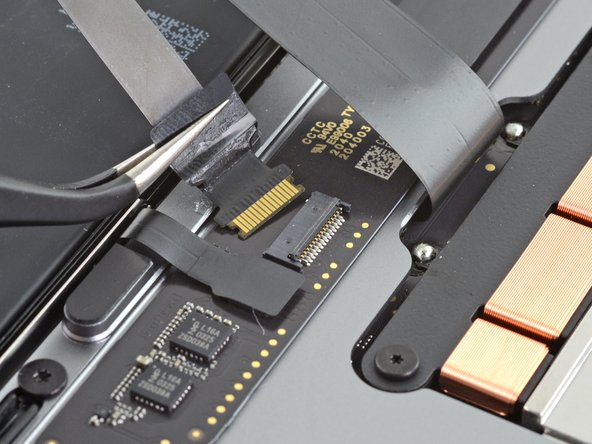

  8. MacBook Air 13" Late 2020 Trackpad Replacement, Disconnect the trackpad cable: crwdns2935265:08crwdnd2935265:01crwdnd2935265:02crwdne2935265:0 MacBook Air 13" Late 2020 Trackpad Replacement, Disconnect the trackpad cable: crwdns2935265:08crwdnd2935265:02crwdnd2935265:02crwdne2935265:0
    • Use a pair of tweezers to peel back the tape covering the trackpad cable connector.

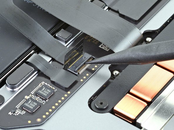

  9. MacBook Air 13" Late 2020 Trackpad Replacement: crwdns2935265:09crwdnd2935265:01crwdnd2935265:02crwdne2935265:0 MacBook Air 13" Late 2020 Trackpad Replacement: crwdns2935265:09crwdnd2935265:02crwdnd2935265:02crwdne2935265:0
    • Use the pointed end of a spudger to lift up the small locking flap on the trackpad cable's ZIF connector.
  10. MacBook Air 13" Late 2020 Trackpad Replacement: crwdns2935265:010crwdnd2935265:01crwdnd2935265:02crwdne2935265:0 MacBook Air 13" Late 2020 Trackpad Replacement: crwdns2935265:010crwdnd2935265:02crwdnd2935265:02crwdne2935265:0
    • Slide the cable out of its connector.
    • If possible, grip the cable by the tape, not by the cable itself.
