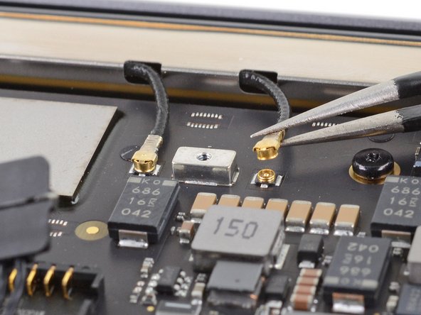

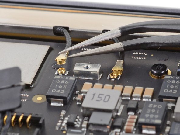

  6. MacBook Air 13" Late 2020 Screen Replacement: crwdns2935265:06crwdnd2935265:01crwdnd2935265:03crwdne2935265:0 MacBook Air 13" Late 2020 Screen Replacement: crwdns2935265:06crwdnd2935265:02crwdnd2935265:03crwdne2935265:0 MacBook Air 13" Late 2020 Screen Replacement: crwdns2935265:06crwdnd2935265:03crwdnd2935265:03crwdne2935265:0
    • Use a pair of tweezers to grip the antenna connector close to its base.
    • Pull straight up to disconnect the cable.
    • Repeat for the second antenna cable.
    • During reassembly, hold the connectors in place and gently press them straight down. The connectors “snap” into their sockets.
