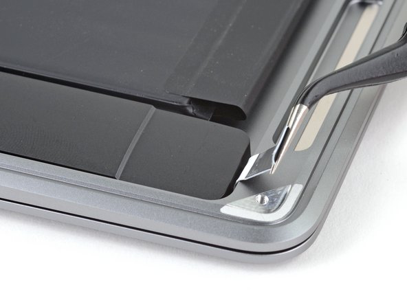

    • Use a pair of tweezers to peel back the black pull tab on the speaker's stretch-release adhesive until you can grip it with your fingers.
  9. MacBook Air 13" Late 2020 Right Speaker Replacement: crwdns2935265:09crwdnd2935265:01crwdnd2935265:02crwdne2935265:0 MacBook Air 13" Late 2020 Right Speaker Replacement: crwdns2935265:09crwdnd2935265:02crwdnd2935265:02crwdne2935265:0
    • Grab the adhesive strip's pull tab and slowly pull the adhesive strip out from underneath the speaker.
    • Keep the angle of the adhesive strip as parallel to the laptop as you can. Try to avoid dragging it across the inside of the case.
    • Pull the adhesive strip until it's freed from under the speaker.
