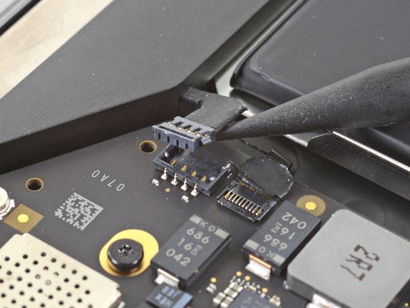

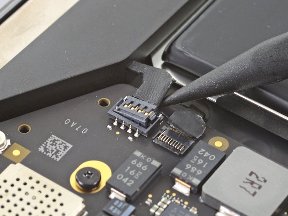

  3. MacBook Air 13" Late 2020 Logic Board Replacement, Disconnect the battery: crwdns2935265:03crwdnd2935265:01crwdnd2935265:03crwdne2935265:0 MacBook Air 13" Late 2020 Logic Board Replacement, Disconnect the battery: crwdns2935265:03crwdnd2935265:02crwdnd2935265:03crwdne2935265:0 MacBook Air 13" Late 2020 Logic Board Replacement, Disconnect the battery: crwdns2935265:03crwdnd2935265:03crwdnd2935265:03crwdne2935265:0
    • Use the flat end of a spudger to pry up and unlatch the metal locking arm on the battery connector.
    • Make sure the metal arm is completely free of the locking tab before lifting the battery connector. The metal locking arm should easily unlatch.
    • Lift straight up on the metal locking arm to pull the battery connector out of its socket on the logic board.
    • During reassembly, press the battery connector straight down into its socket, making sure it sits flush within the socket.
    • If necessary, push the rear, wire side of the connector into place first, then rock the front of the connector into place.

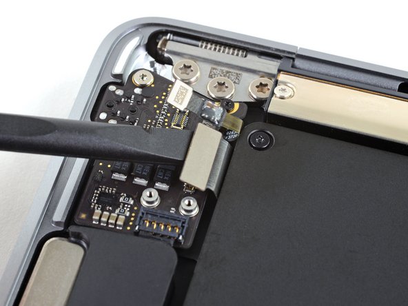

  4. MacBook Air 13" Late 2020 Logic Board Replacement, Disconnect the audio board cable: crwdns2935265:04crwdnd2935265:01crwdnd2935265:01crwdne2935265:0
    • Use a T3 Torx driver to remove the three 1.4 mm screws securing the audio board connector cover.
    • If your T3 bit feels a bit too loose, you may need to use a T4.
  5. MacBook Air 13" Late 2020 Logic Board Replacement: crwdns2935265:05crwdnd2935265:01crwdnd2935265:01crwdne2935265:0
    • Remove the audio board connector cover.
  6. MacBook Air 13" Late 2020 Logic Board Replacement: crwdns2935265:06crwdnd2935265:01crwdnd2935265:02crwdne2935265:0 MacBook Air 13" Late 2020 Logic Board Replacement: crwdns2935265:06crwdnd2935265:02crwdnd2935265:02crwdne2935265:0
    • Use the flat end of a spudger to pry the audio board connector straight up to disconnect it from the board.

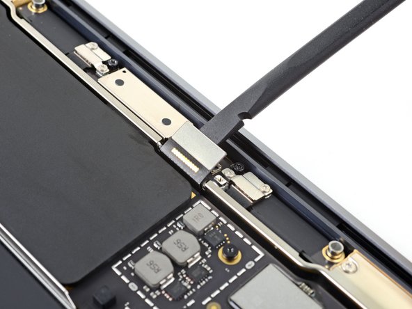

  7. MacBook Air 13" Late 2020 Logic Board Replacement, Disconnect the USB-C board cable: crwdns2935265:07crwdnd2935265:01crwdnd2935265:01crwdne2935265:0
    • Use a T3 Torx driver to remove the two 1.4 mm screws securing the USB-C connector cover.
  8. MacBook Air 13" Late 2020 Logic Board Replacement: crwdns2935265:08crwdnd2935265:01crwdnd2935265:01crwdne2935265:0
    • Remove the USB-C connector cover.
  9. MacBook Air 13" Late 2020 Logic Board Replacement: crwdns2935265:09crwdnd2935265:01crwdnd2935265:02crwdne2935265:0 MacBook Air 13" Late 2020 Logic Board Replacement: crwdns2935265:09crwdnd2935265:02crwdnd2935265:02crwdne2935265:0
    • Use the flat end of a spudger to pry the USB-C cable connector up and out of its socket on the logic board.

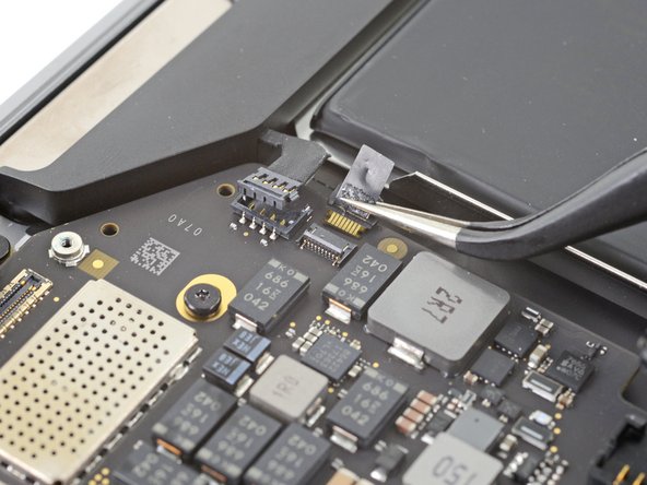

  20. MacBook Air 13" Late 2020 Logic Board Replacement, Disconnect the microphone cable: crwdns2935265:020crwdnd2935265:01crwdnd2935265:03crwdne2935265:0 MacBook Air 13" Late 2020 Logic Board Replacement, Disconnect the microphone cable: crwdns2935265:020crwdnd2935265:02crwdnd2935265:03crwdne2935265:0 MacBook Air 13" Late 2020 Logic Board Replacement, Disconnect the microphone cable: crwdns2935265:020crwdnd2935265:03crwdnd2935265:03crwdne2935265:0
    • Use a pair of tweezers to peel back any tape covering the microphone cable connector.
    • Use the pointed end of a spudger to lift up the small locking flap on the microphone cable's ZIF connector.
    • Slide the microphone cable out of its connector.
    • If possible, grip the cable by the tape, not by the cable itself.
