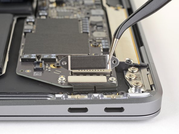

  5. MacBook Air 13" Early 2020 USB-C Board Replacement, Remove the USB-C board: crwdns2935265:05crwdnd2935265:01crwdnd2935265:02crwdne2935265:0 MacBook Air 13" Early 2020 USB-C Board Replacement, Remove the USB-C board: crwdns2935265:05crwdnd2935265:02crwdnd2935265:02crwdne2935265:0
    • Use a T3 Torx driver to remove the two 1.4 mm screws securing the USB-C connector cover.
    • Remove the USB-C connector cover.
  6. MacBook Air 13" Early 2020 USB-C Board Replacement: crwdns2935265:06crwdnd2935265:01crwdnd2935265:02crwdne2935265:0 MacBook Air 13" Early 2020 USB-C Board Replacement: crwdns2935265:06crwdnd2935265:02crwdnd2935265:02crwdne2935265:0
    • Use the flat end of a spudger to pry the USB-C cable connector up and out of its socket on the logic board.
    • To re-attach press connectors like this one, carefully align and press down on one side until it clicks into place, then repeat on the other side. Do not press down on the middle. If the connector is misaligned, the pins can bend, causing permanent damage.
  7. MacBook Air 13" Early 2020 USB-C Board Replacement: crwdns2935265:07crwdnd2935265:01crwdnd2935265:01crwdne2935265:0
    • Use a T4 Torx driver to remove the two 2.9 mm screws securing the USB-C board.
  8. MacBook Air 13" Early 2020 USB-C Board Replacement: crwdns2935265:08crwdnd2935265:01crwdnd2935265:01crwdne2935265:0
    • Use a pair of tweezers to remove the USB-C board.

Great guide and easy repair! My MacBook Air thought it was perpetually plugged in and would only charge from one of the USB C ports, this repair fixed it! I had a little scare when rebooting after the the fix, I either wasn’t pressing the power/touch ID button long enough or resetting the SMC (left shift, control, option, and power buttons) and holding the buttons until it booted worked. Not sure which did it.
Tyler - crwdns2934203:0crwdne2934203:0
Thanks a lot, the repair guide was perfect ! It really took me 5mn.
My usb-c connector got corroded after I accidentally pulled some water on my computer. As by Tyler’s comment, my MBA was only working from one single port anymore and showed to be perpetually connected and in charge. I got the spare chip from AliExpress for 10€. Apple would have charged me for 400€…
Lastly, when booting for the 1st time after doing the repair, pressing the power button didn’t work and my MBA stayed off. I had to plug it to the charger and it then booted seamlessly.
Thanks again !
Faabio - crwdns2934203:0crwdne2934203:0
Wish i could change out my USB port on my 2014 MacAir to USB-C
Shaun M. - crwdns2934203:0crwdne2934203:0
The same experience as Fabio. The repair was simple and straight-forward and the machine wouldn't boot from the battery the first time. Once plugged into the charger it booted just fine and has booted off the battery as normal ever since.
Fixed my 1 dead USB port problem with very little hassle/cost. Just be prepared for the bowel clenching moment when it won't boot from the battery the first time.
