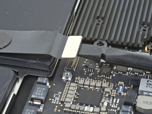

  7. MacBook Air 13" Early 2020 Trackpad Replacement, Disconnect the trackpad cable: crwdns2935265:07crwdnd2935265:01crwdnd2935265:02crwdne2935265:0 MacBook Air 13" Early 2020 Trackpad Replacement, Disconnect the trackpad cable: crwdns2935265:07crwdnd2935265:02crwdnd2935265:02crwdne2935265:0
    • Use the flat end of a spudger to pry the trackpad cable connector up and out of its socket.
    • To re-attach press connectors like this one, carefully align and press down on one side until it clicks into place, then repeat on the other side. Do not press down on the middle. If the connector is misaligned, the pins can bend, causing permanent damage.
