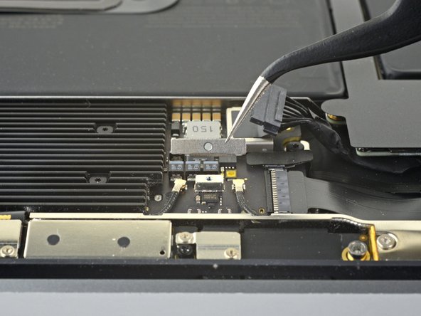

  3. MacBook Air 13" Early 2020 Display Replacement, Disconnect the battery: crwdns2935265:03crwdnd2935265:01crwdnd2935265:01crwdne2935265:0
    • Peel back the tape covering the battery connector enough to reveal the connector underneath.
  4. MacBook Air 13" Early 2020 Display Replacement: crwdns2935265:04crwdnd2935265:01crwdnd2935265:02crwdne2935265:0 MacBook Air 13" Early 2020 Display Replacement: crwdns2935265:04crwdnd2935265:02crwdnd2935265:02crwdne2935265:0
    • Use a spudger to slide the battery connector parallel to the logic board and out of its socket on the logic board.

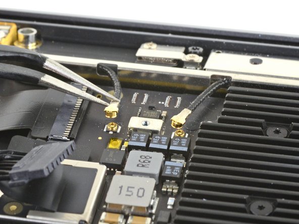

  6. MacBook Air 13" Early 2020 Display Replacement: crwdns2935265:06crwdnd2935265:01crwdnd2935265:03crwdne2935265:0 MacBook Air 13" Early 2020 Display Replacement: crwdns2935265:06crwdnd2935265:02crwdnd2935265:03crwdne2935265:0 MacBook Air 13" Early 2020 Display Replacement: crwdns2935265:06crwdnd2935265:03crwdnd2935265:03crwdne2935265:0
    • Use a pair of tweezers to grip the antenna connector close to its base.
    • Pull straight up to disconnect the cable.
    • Repeat for the second antenna cable.

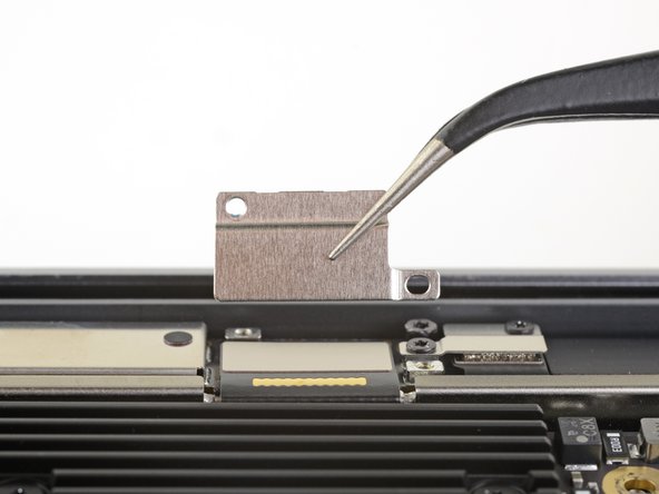

  7. MacBook Air 13" Early 2020 Display Replacement: crwdns2935265:07crwdnd2935265:01crwdnd2935265:02crwdne2935265:0 MacBook Air 13" Early 2020 Display Replacement: crwdns2935265:07crwdnd2935265:02crwdnd2935265:02crwdne2935265:0
    • Use a T3 Torx driver to remove the two 1.5 mm screws securing the display cable connector cover.
    • Remove the display cable connector cover.
