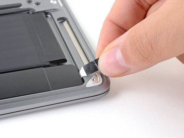

  18. MacBook Air 13" Early 2020 Battery Replacement, Remove the battery tray adhesive strips: crwdns2935265:018crwdnd2935265:01crwdnd2935265:03crwdne2935265:0 MacBook Air 13" Early 2020 Battery Replacement, Remove the battery tray adhesive strips: crwdns2935265:018crwdnd2935265:02crwdnd2935265:03crwdne2935265:0 MacBook Air 13" Early 2020 Battery Replacement, Remove the battery tray adhesive strips: crwdns2935265:018crwdnd2935265:03crwdnd2935265:03crwdne2935265:0
    • The MacBook's battery cells are attached to a metal tray as a complete assembly, which is adhered to the case with a total of six stretch-release adhesive strips.
    • Do not attempt to remove the battery cells from their metal backing tray.
    • On the left side of the MacBook, use a pair of tweezers to peel back the three black pull tabs on the battery's stretch-release adhesive strips until you can grip them with your fingers.
  19. MacBook Air 13" Early 2020 Battery Replacement: crwdns2935265:019crwdnd2935265:01crwdnd2935265:03crwdne2935265:0 MacBook Air 13" Early 2020 Battery Replacement: crwdns2935265:019crwdnd2935265:02crwdnd2935265:03crwdne2935265:0 MacBook Air 13" Early 2020 Battery Replacement: crwdns2935265:019crwdnd2935265:03crwdnd2935265:03crwdne2935265:0
    • Grab an adhesive strip's pull tab and slowly pull it out from underneath the battery.
    • Keep the angle of the adhesive strip as parallel to the laptop as you can. Try to avoid dragging it across the inside of the case.
    • Pull the adhesive strip until it's freed from under the battery.
    • Repeat for the two remaining adhesive strips on the battery's left side.
