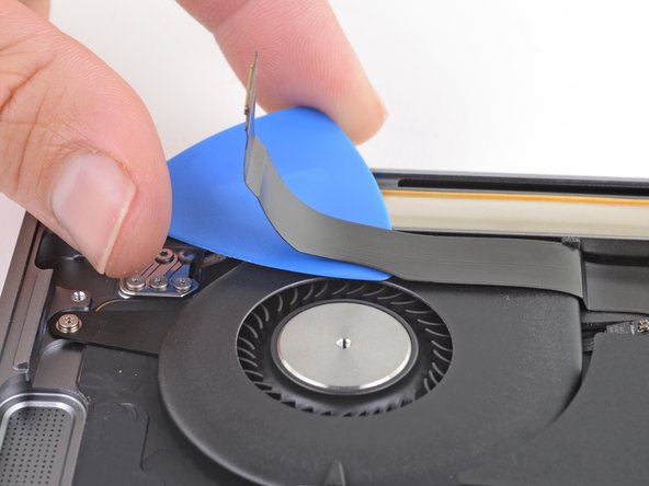

  14. MacBook Air 13” Retina Display Late 2018 Fan Replacement, Separate the audio board cable: crwdns2935265:014crwdnd2935265:01crwdnd2935265:03crwdne2935265:0 MacBook Air 13” Retina Display Late 2018 Fan Replacement, Separate the audio board cable: crwdns2935265:014crwdnd2935265:02crwdnd2935265:03crwdne2935265:0 MacBook Air 13” Retina Display Late 2018 Fan Replacement, Separate the audio board cable: crwdns2935265:014crwdnd2935265:03crwdnd2935265:03crwdne2935265:0
    • Slide an opening pick under the audio board cable to slice through the adhesive securing it to the fan.
