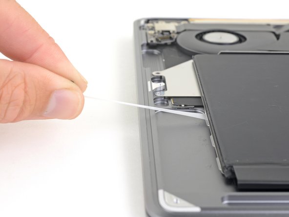

  31. MacBook Air 13” Retina Display Late 2018 Battery Replacement, Remove the battery adhesive: crwdns2935265:031crwdnd2935265:01crwdnd2935265:03crwdne2935265:0 MacBook Air 13” Retina Display Late 2018 Battery Replacement, Remove the battery adhesive: crwdns2935265:031crwdnd2935265:02crwdnd2935265:03crwdne2935265:0 MacBook Air 13” Retina Display Late 2018 Battery Replacement, Remove the battery adhesive: crwdns2935265:031crwdnd2935265:03crwdnd2935265:03crwdne2935265:0
    • Use a pair of tweezers to lift up the black adhesive pull tab on the side of the battery, enough so you can grab it with your fingers.
    • Grab the adhesive strip pull tab and slowly and carefully pull the adhesive strip out from under the battery.
    • Keep the angle of the adhesive strip as parallel to the laptop as you can. Try to avoid dragging it across the inside of the case.
    • If the adhesive strip breaks, leave it in and proceed to the next step.
