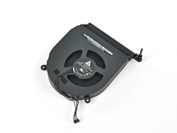

    • The first thing out the hole? The fan.
    • No surprises here. The new mini has the same fan as the old mini, and even the older mini.
    • Sticking with the brushless, high blade density blower, this single fan is quiet and effective.

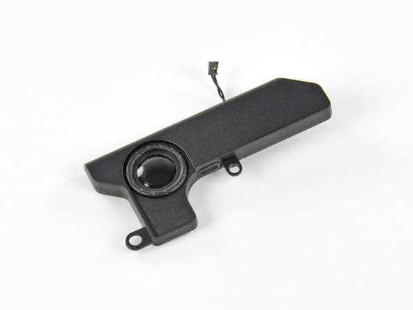

    • Two T6 Torx screws hold the speaker in its place on the logic board.
    • With the speaker removed, this Mac mini can no longer bump fat bass beep at you.

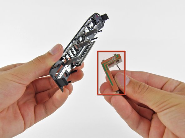

    • After de-routing a couple cables and unscrewing a few #00 Phillips screws, we were able to remove two antennas and the I/O wall from the logic board.
    • The antennas are attached to the plastic I/O wall since wireless signals don't transmit well through metal.
    • Ah ha, we meet again L-block.

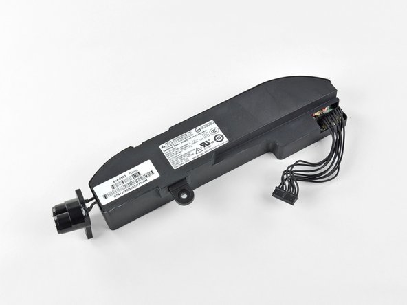

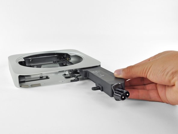

    • One T6 screw holds the power supply in place.
    • After removing a small metal bracket and twisting the AC power-in port, the power supply slides right out through the mini's empty front.
    • Look familiar to you, too? Good, then it's not just us.
