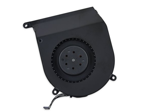

  6. Mac mini Late 2014 Teardown: crwdns2935265:06crwdnd2935265:01crwdnd2935265:03crwdne2935265:0 Mac mini Late 2014 Teardown: crwdns2935265:06crwdnd2935265:02crwdnd2935265:03crwdne2935265:0 Mac mini Late 2014 Teardown: crwdns2935265:06crwdnd2935265:03crwdnd2935265:03crwdne2935265:0
    • Upon removal, the fan seems identical to the one from the previous model—but let's not be too quick to judge a fan by its cover.
    • Advanced Hydraulic Bearing
    • Hmm. Interesting. What exactly is Advanced Hydraulic Bearing? Let's find out. According to Asia Vital Components:
    • AHB "consists of a polished steel shaft, a sintered bearing and fluid lubricant." In this system there "is no contact between shaft and bearing" and thus "the bearing load is carried solely by a film of fluid lubricant."
    • AHB is best for fans that operate at a lower speed. It's better at absorbing shock and dampening vibration than traditional ball bearings, making for a quieter fan.

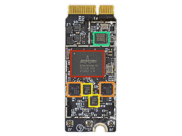

  7. Mac mini Late 2014 Teardown: crwdns2935265:07crwdnd2935265:01crwdnd2935265:03crwdne2935265:0 Mac mini Late 2014 Teardown: crwdns2935265:07crwdnd2935265:02crwdnd2935265:03crwdne2935265:0 Mac mini Late 2014 Teardown: crwdns2935265:07crwdnd2935265:03crwdnd2935265:03crwdne2935265:0
    • The AirPort card is dispatched after removing one screw and disconnecting two more antennas from their sockets.
    • Gone is the funky cable-connected AirPort card of yesteryear, this AirPort card is now full-fledged PCIe, supporting Wi-Fi ac.
    • Let's take a look at the ICs found on the AirPort card:
    • Broadcom BCM4360KML1G 5G WiFi 3-Stream 802.11ac Gigabit Transceiver
    • Skyworks SE5516 Dual-Band 802.11a/b/g/n/ac WLAN Front-End Module
    • RF Micro RFFM4293 2.5 GHz FEMS and RFFM4591 5 GHz FEMS
    • Broadcom BCM20702 Single-Chip Bluetooth 4.0 HCI Solution with Bluetooth Low Energy Support
