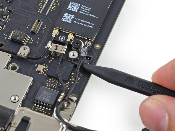

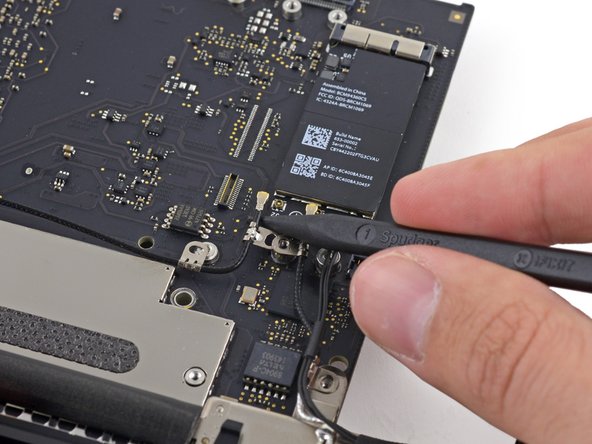

    • Use the point of a spudger to lift the antenna connectors up off of their sockets on the AirPort card.

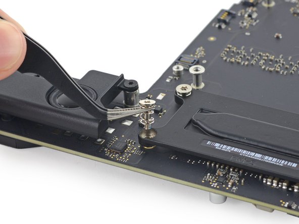

    • Remove the following T6 Torx screws securing the speaker to the logic board:
    • One 3.6 mm screw
    • One 3.6 mm large headed screw

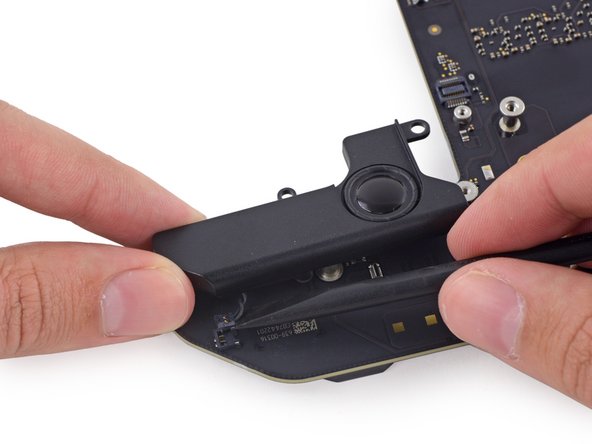

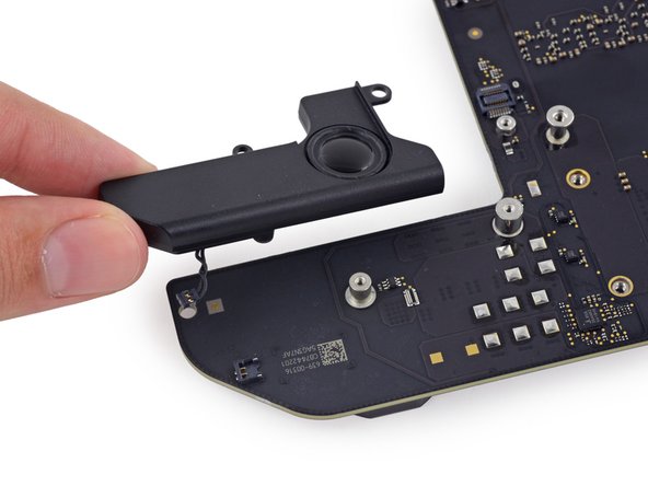

  35. Mac mini Late 2014 Logic Board Replacement: crwdns2935265:035crwdnd2935265:01crwdnd2935265:02crwdne2935265:0 Mac mini Late 2014 Logic Board Replacement: crwdns2935265:035crwdnd2935265:02crwdnd2935265:02crwdne2935265:0
    • Do not attempt to remove the speaker entirely as it is still attached to the logic board.
    • Nudge the speaker gently out of the way to allow access to the speaker's connector.
  36. Mac mini Late 2014 Logic Board Replacement: crwdns2935265:036crwdnd2935265:01crwdnd2935265:03crwdne2935265:0 Mac mini Late 2014 Logic Board Replacement: crwdns2935265:036crwdnd2935265:02crwdnd2935265:03crwdne2935265:0 Mac mini Late 2014 Logic Board Replacement: crwdns2935265:036crwdnd2935265:03crwdnd2935265:03crwdne2935265:0
    • Use the flat end of a spudger to carefully lift the speaker connector up out of its socket on the logic board.
    • Remove the speaker from the logic board.

    • Remove the 2.7 mm T5 screw securing the AirPort card.
  38. Mac mini Late 2014 Logic Board Replacement: crwdns2935265:038crwdnd2935265:01crwdnd2935265:03crwdne2935265:0 Mac mini Late 2014 Logic Board Replacement: crwdns2935265:038crwdnd2935265:02crwdnd2935265:03crwdne2935265:0 Mac mini Late 2014 Logic Board Replacement: crwdns2935265:038crwdnd2935265:03crwdnd2935265:03crwdne2935265:0
    • Lift the free end of the AirPort card enough to grasp it by the edges.
    • Pull the AirPort card straight out of its socket on the logic board and remove it from the Mac Mini.
