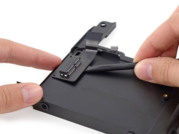

    1. Mac mini Late 2014 Drive Tray Replacement, Drive Tray: crwdns2935265:035crwdnd2935265:01crwdnd2935265:01crwdne2935265:0
      • Remove the 5 mm T5 Torx screw securing the SSD.
    2. Mac mini Late 2014 Drive Tray Replacement: crwdns2935265:036crwdnd2935265:01crwdnd2935265:03crwdne2935265:0 Mac mini Late 2014 Drive Tray Replacement: crwdns2935265:036crwdnd2935265:02crwdnd2935265:03crwdne2935265:0 Mac mini Late 2014 Drive Tray Replacement: crwdns2935265:036crwdnd2935265:03crwdnd2935265:03crwdne2935265:0
      • Lift the free end of the SSD up slightly and pull it out of its socket.
    3. Mac mini Late 2014 Drive Tray Replacement: crwdns2935265:037crwdnd2935265:01crwdnd2935265:03crwdne2935265:0 Mac mini Late 2014 Drive Tray Replacement: crwdns2935265:037crwdnd2935265:02crwdnd2935265:03crwdne2935265:0 Mac mini Late 2014 Drive Tray Replacement: crwdns2935265:037crwdnd2935265:03crwdnd2935265:03crwdne2935265:0
      • Slip the flat end of a spudger under the SSD cable to lift it off the adhesive holding it to the drive tray.
    4. Mac mini Late 2014 Drive Tray Replacement: crwdns2935265:038crwdnd2935265:01crwdnd2935265:01crwdne2935265:0
      • Remove the PCIe SSD cable from the drive tray.
