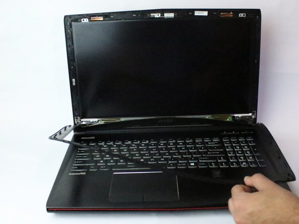

    • Slide a metal opener tool along the outside edges of the front screen panel to start to separate it from the back screen panel.
    • You may need to apply some firm pressure to get it started.

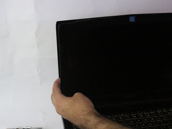

  6. MSI GE62 Apache Pro 004 Web Camera Replacement: crwdns2935265:06crwdnd2935265:01crwdnd2935265:02crwdne2935265:0 MSI GE62 Apache Pro 004 Web Camera Replacement: crwdns2935265:06crwdnd2935265:02crwdnd2935265:02crwdne2935265:0
    • Once it has started to separate, gently pull off the screen panel by working along the edge, and set it aside.
    • Do not force off. Front screen panel is thing and can break or crack very easily.

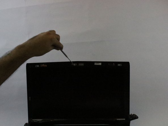

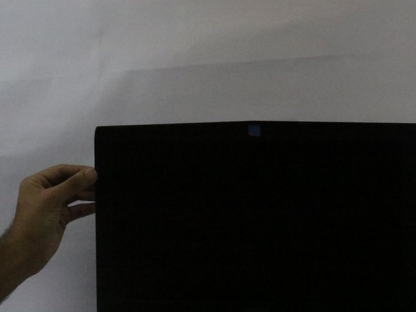

    • Locate the WebCam on the middle of the device.
    • Slide a metal opener tool to remove the Webcam
