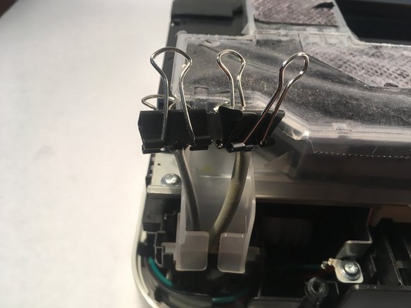

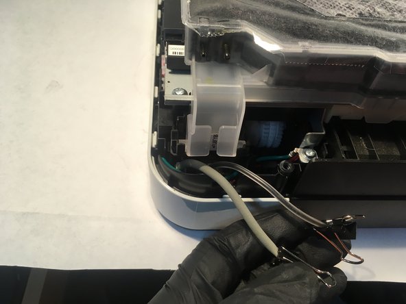

  16. MFC-J4410DW Ink Absorber Box Replacement, Removing the tubes: crwdns2935265:016crwdnd2935265:01crwdnd2935265:03crwdne2935265:0 MFC-J4410DW Ink Absorber Box Replacement, Removing the tubes: crwdns2935265:016crwdnd2935265:02crwdnd2935265:03crwdne2935265:0 MFC-J4410DW Ink Absorber Box Replacement, Removing the tubes: crwdns2935265:016crwdnd2935265:03crwdnd2935265:03crwdne2935265:0
    • For this step, spin the printer around so the back is toward you.
    • Remove the drain tube and the air vent tube from the ink absorber box. A spudger may be helpful.
    • Clip the ends of the tubes so they won't leak.
    • De-route the tubes from the holder.
