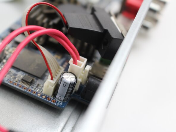

    • Before beginning, disconnect the DVR from power and unplug all peripheries.
    • Remove each of the two 1 cm screws on the right and left sides of the DVR with a Phillips screwdriver.
  2. Lorex LHV210800 Motherboard Replacement: crwdns2935265:02crwdnd2935265:01crwdnd2935265:02crwdne2935265:0 Lorex LHV210800 Motherboard Replacement: crwdns2935265:02crwdnd2935265:02crwdnd2935265:02crwdne2935265:0
    • Remove the four 1 cm Phillips screws on the rear panel.
    • Do not unscrew the screw connected to the lower case.

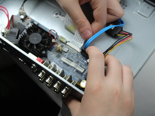

  3. Lorex LHV210800 Motherboard Replacement: crwdns2935265:03crwdnd2935265:01crwdnd2935265:01crwdne2935265:0
    • Lift up and remove the top cover.

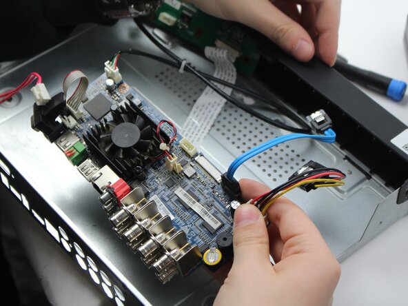

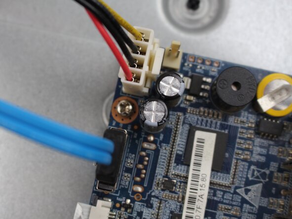

  4. Lorex LHV210800 Motherboard Replacement, Motherboard: crwdns2935265:04crwdnd2935265:01crwdnd2935265:02crwdne2935265:0 Lorex LHV210800 Motherboard Replacement, Motherboard: crwdns2935265:04crwdnd2935265:02crwdnd2935265:02crwdne2935265:0
    • Unscrew the 1cm hex screws with the driver and a size 8 hex socket.
    • Unplug the cord from the socket in the motherboard.

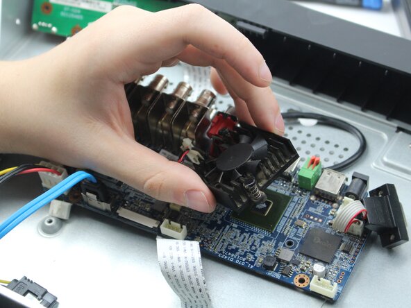

  5. Lorex LHV210800 Motherboard Replacement: crwdns2935265:05crwdnd2935265:01crwdnd2935265:03crwdne2935265:0 Lorex LHV210800 Motherboard Replacement: crwdns2935265:05crwdnd2935265:02crwdnd2935265:03crwdne2935265:0 Lorex LHV210800 Motherboard Replacement: crwdns2935265:05crwdnd2935265:03crwdnd2935265:03crwdne2935265:0
    • Remove the two 1cm screws from the back panel.
    • This makes it easier to slide out with no issue.
  6. Lorex LHV210800 Motherboard Replacement: crwdns2935265:06crwdnd2935265:01crwdnd2935265:02crwdne2935265:0 Lorex LHV210800 Motherboard Replacement: crwdns2935265:06crwdnd2935265:02crwdnd2935265:02crwdne2935265:0
    • Once all the screws are off the back panel, remove the power source.
    • The power source would be the white box with the R/B/G cables attached, along with the blue and other white box with R/B/B/Y cords.
  7. Lorex LHV210800 Motherboard Replacement: crwdns2935265:07crwdnd2935265:01crwdnd2935265:02crwdne2935265:0 Lorex LHV210800 Motherboard Replacement: crwdns2935265:07crwdnd2935265:02crwdnd2935265:02crwdne2935265:0
    • Remove this pin in order to take off the fan.
    • Remove the fan in order to access the motherboard.
